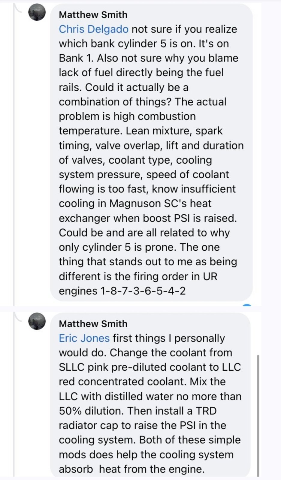

    I just ordered some LLC Red Sauce...cheapest I have found it is at Newparts.com...ordered 3 gallons and we need 2...thanks for the reminder!

    I have a Mishimoto & the LLC red waiting to go in, I had not seen this dilution idea, what is the right %?

    Whipple's install manual calls out adding water wetter. 1 bottle for the blower and I believe I also did one for the rad maybe 2 can't remember

    I'm a huge fan of water wetter in water only racecars. I've heard mixed anecdotes/stories about compatibility with various LL coolants.
    Who's been using it with what coolant for how long?

    I just added 1.5 bottle to my 50/50 red coant mix for engine and 1/2 bottle for IC. I didnt read about incompatibility only mixed results if it worked with coolant. I figured it's cheap insurance with 18 pai cap. @reywcms mentioned using it in his.
