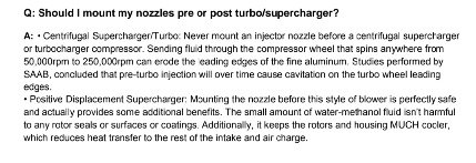

    A 50/50 mix won't eat the coating. Before the TB it is atomized according to Snow. It's when spraying before a turbo where it can eat the turbine blade edges.
    You can also spray 100% distilled water for lower IAT's.

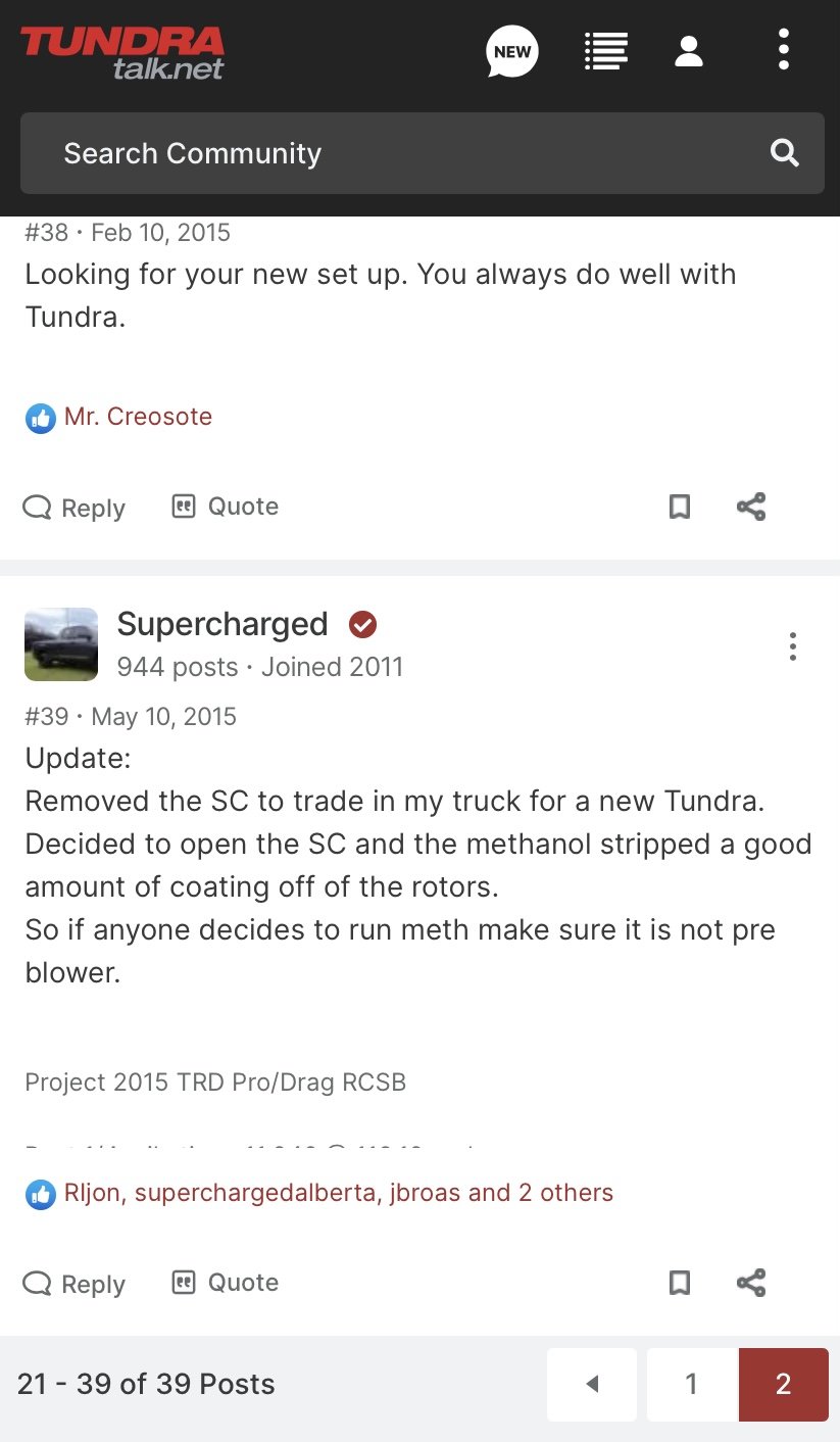

    This guy was running 100% methanol and claims his coating was stripped off, but who knows what other factors there were regarding the missing coating. He was also a frequent drag racer apparently with his tundra. I’ve seen nothing but mixed opinions on the matter.

    I've been running a 50/50 mixture for 22k miles and so far no issues. I actually emailed Harrop about methanol injection and this is what Michael Hewitt, Business Development Manager at Harrop said:
    "The formal answer to your question is the supercharger is “designed” to move air not an air/fuel mixture. If the event you ran methanol through the s/c and it failed the warranty would be your responsibility. That said, I have known a number of customers over the years that have run an air/fuel mixture through the blower without issue. You should be fine, but in the event a bearing or seal failed due to the meth injection, be mindful it’s your responsibility for repair/replacement."​

    @blenton I looked for the Saab study that Snow quoted but didn't see it. Know the army used it in ww2 but the planes didn't last long enough to see effects.
