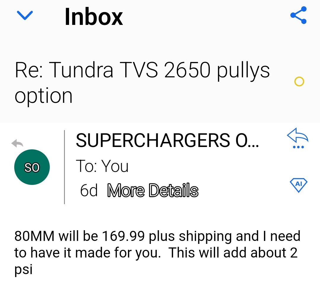

    80mm was the only one he brought up

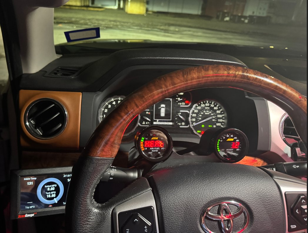

    Why all the harsh vibes on Cravenspeed?
    on my gauges, there is about 10 small washers, on the mounting screw, pushing the gauges back to clear the steering wheel. that's the only mod.
    otherwise, it's a 15 minute install.
    the scangauge3 is using a cravenspeed mount as well.
    I work in East Houston, so you don't want anything showing, hence, why it is mounted low.
    and JUST in front of the truck - yes, those are working train tracks. Our conference room is like that scene in "Se7en" - the vibrating apartment.
    ARES35, Mdl, PolishedTRD and 3 others like this.

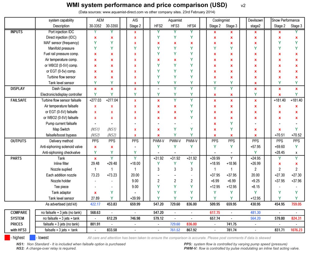

    I would say the Aquamist would be better...simply for the ability to tune the Water/meth, as it has more capability for adjustments based on sensor inputs, MAP, O2WB, EGT, etc. If using purely for cooling the IATs, the AEM would be fine for that, but I would add a solenoid to it.

    I used a similar fix with spacers.

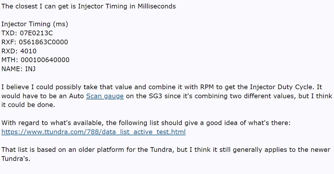

    I forgot about this...I asked Scangauge about inj duty cycle.
    ya'll....what are the 2 variables to monitor to get to the duty cycle?
