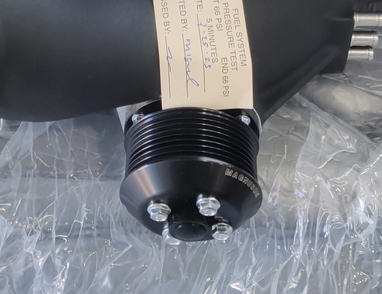

    After closer examination, other than there not being recesses for the bolt heads the way the Harrop pulleys are, these look pretty identical to the Harrop pulleys. I wonder if using the Harrop style bolts would allow you to use the Harrop pulleys on a magnuson. It’s probably unlikely the alignment with the belt would be identical though. I’m sure it could be determined with some measuring.
    ARES35, helidave and Mdl like this.

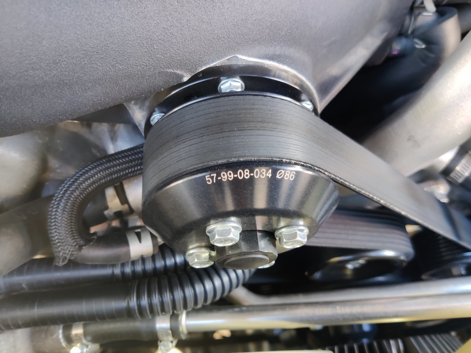

    Here's what I sent to scol. Ours are the 8rib
  28. Nov 8, 2023 at 2:57 PM
    ARES35
    ARES35 New member for life
    Aug 8, 2018
    #17920
    1,026
    Mile high
    Blown 2650 17 1794 Tundra 4x4 CM
    2650/750cc/76mm/SPD DP-DD exhaust/HP tuned
    Magnuson said only digits 57-99-08-diameter# would only work for our application
    Silver17[QUOTED] and Mdl like this.

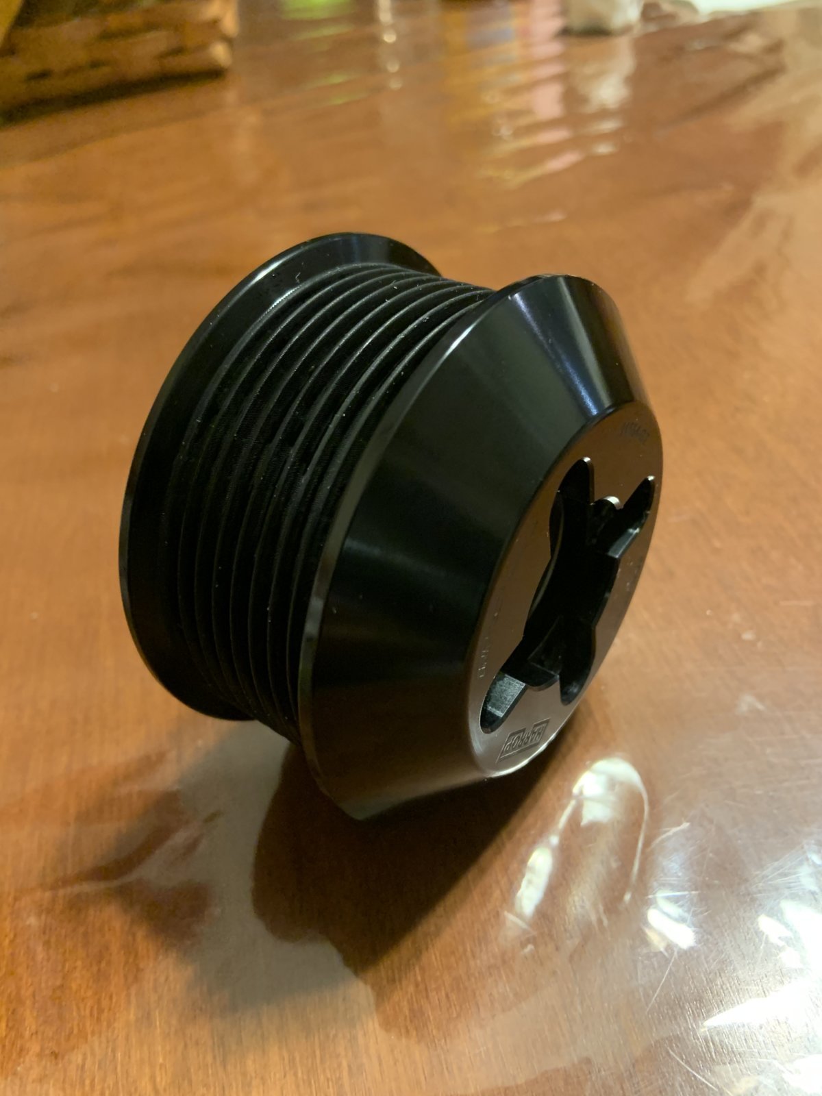

    ZPE said if I ship them mine they could cast up some ... I may just do that so us tvs dudes have some options
