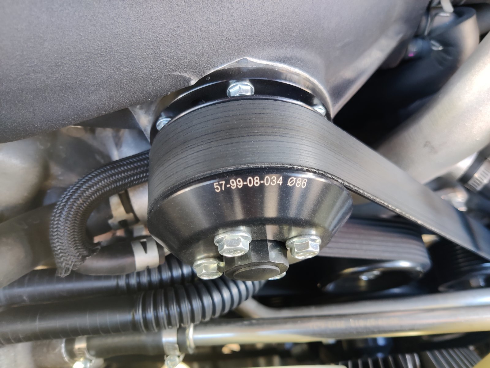

    I poked about on their website for a moment, but couldn't discern exactly which pulley(s) was(were) applicable for the Magnuson Magnum. FWTW

    Remind me…what pulley came with the mag 2650? 82mm?

    Pictures posted so far show them with an 86mm.

    there’s your problem

    When I talked to SCOL about smaller pullies for the 2650, they said it was too new, no idea what they'd use.
    I talked to our contact at Magnuson and we're looking at doing a run of 3.2" pullies, which would be 81mm (stock/default is 86mm)

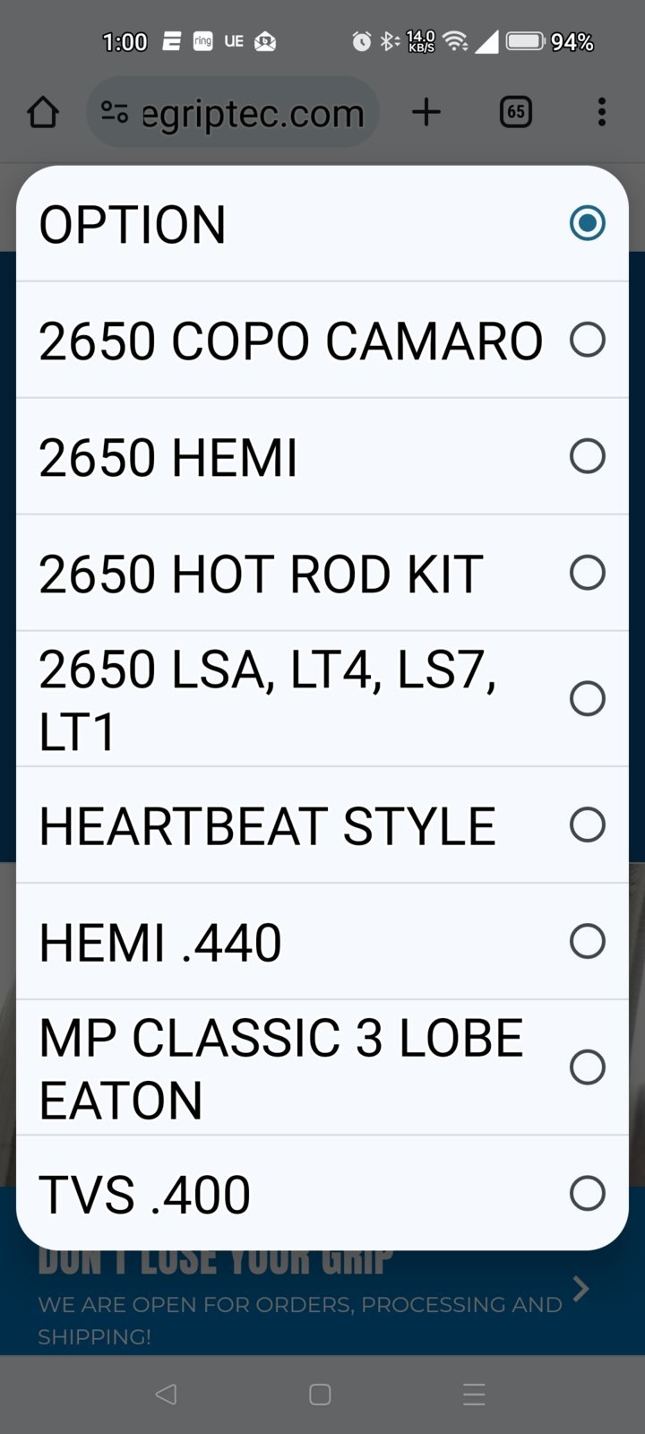

    Looks like ZPE carries a slew of pullies..... But not sure what TVS kit the Tundra falls under:confused:

    That is correct, Magnuson states warranty is invalid if a smaller pulley is used.... I'm going to reach out and and ask about the guys running the kit at high elevation. 86mm may be great at sea level but up here it's no bueno lol

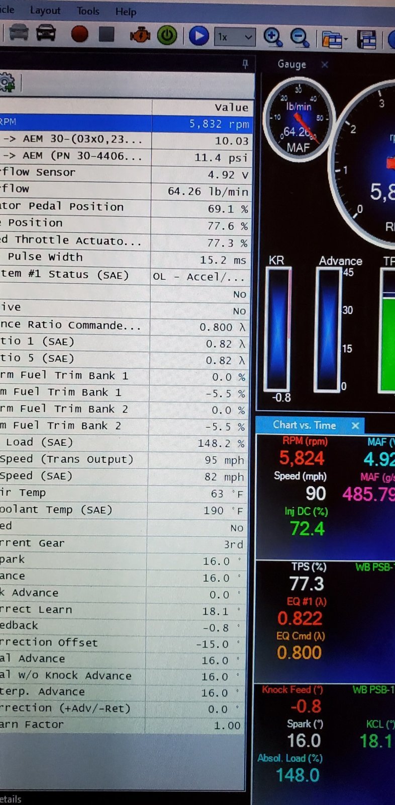

    Got @snivilous tune loaded and headed out before the rain starts up again. I was hitting about 10.7psi before 2.2 pulley and 4.5 intake. I do have an ASP overdrive pulley and LT with full 3 inch dual exhaust with 200 cell single cats. I hit 11.4psi and it was pulling nice and strong! Even with 4.5 intake MAF hit 4.92v.
    I hit an on ramp that is a little over 1/4 mile and went WOT but I hit a wet spot and it shifted right when I went over it and started spinning and fishtailing...Fun times. All in all it runs great and have an awesome tuner that aims to get it right!!!! Thank you @snivilous

    That's some boost!! Start the new budget!!

    @HulkSmurf14 I have the tune on the rich side for protection and am also spraying, just re-adjusted from 10psi, W/M at a 70/30 mix at 9psi to aid in cooling. At some point when I get off my butt and sell my house to get away from Seattle/Tacoma area I'll start on a forged build, built transmission and replace my Auburn with Powertrax... Hopeful thinking!

    Oh damn that's right!! You're good to go man... I'm jeally of that boost!! I need to get my damn injectors, fuel pump and Sniv-awesome thrown on!! Ooooh man!!

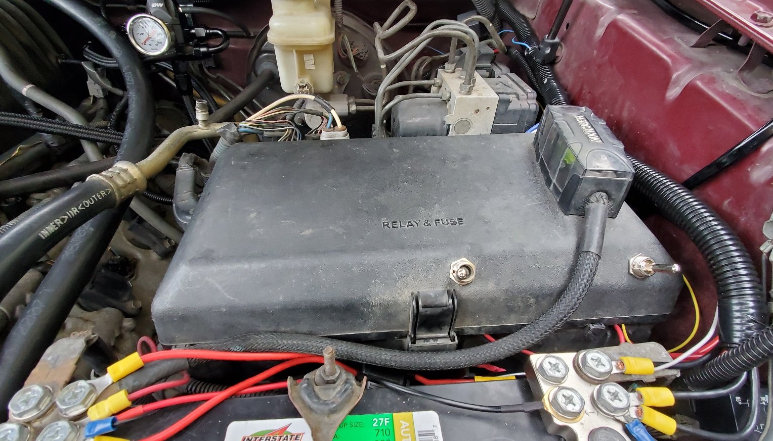

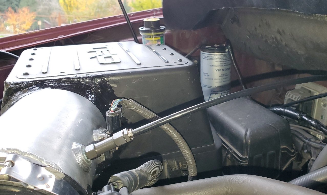

    I went to go throw a zip tie on my boost line supply from SC and it was split. Guess I'll have to recheck it. May be a little more psi. Of course it's raining again!
    The W/M pump fits just aft of the airbox. I also wired in a switch to shut off fuel pump, IC pump, inside fuel psi gauge and AFR/boost gauge. Gotta come up with a wire management system.

    That is extremely cool! How is the water meth activated? Is it stand alone or controlled by the gauge or something else?
    You guys pushing a lot of power are super cool and fun to watch. I think it'd be a lot of fun to have a Tundra dedicated to maximizing the power stock internals can handle for street use. Maybe when I get a tow rig to replace the Tundra some day.

    @snivilous my brother gave me his meth/water kit. But the tank was broke the controller was fried and nozzle was trashed. The pump was good though.
    I am utilizing the W/W tank with a 70/30 mix. I'm using a Snow activation switch #81014, which is full flow, and a 325cc aem nozzle. Activated by boost sensor at 9psi but is adjustable. It's the smallest nozzle and only want it for cooling at the higher psi. You don't want it set low as it can bog the engine under 3000rpm. I added a green activation light so I know when it's doing its thing.

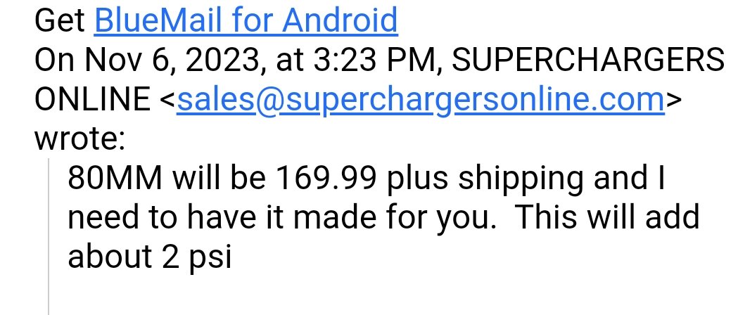

    Alright so I was able to get some info on pullies for the TVS 2650. SCOL said that they are looking into it but the cone nose may be to small for a smaller pulley?! I was confused by that statement. ZPE does not carry any pullies yet for the TVS. They said if I shipped them my stock 86mm they could fab some up that would work for our application. Magnuson confirmed changing the pulley will void the warranty..... Don't matter if your a mile high, on the moon in a black hole shits voided. Good news is they do have a 2.9 pulley but it isn't shown on there website. Was told I could order through sales. Part number for said pulley is as follows, 57-99-08-029. He said it'll produce around 3/4 more psi fyi

    Well, I guess it’s clear SCOL was wrong if they don’t think you can run a smaller one but Magnuson tells you there is a 2.9” pulley a available. 2.9” is like a 73.5ish MM pulley which would normally not be advised for most to run at sea level, but if you’re at elevation then it’s probably fine? Hopefully they will offer smaller than that at some point, since that’s still less flow than Snivs 2.0 on a 1900 by a good margin, as well as the smaller Harrop offerings (65/70mm) on their 2650.
    Maybe you can order that pulley through SCOL using that part number to prevent magnuson from being aware you have a smaller than stock pulley installed if issues arise.

    Fawc, SCOL's response on smaller pulley
