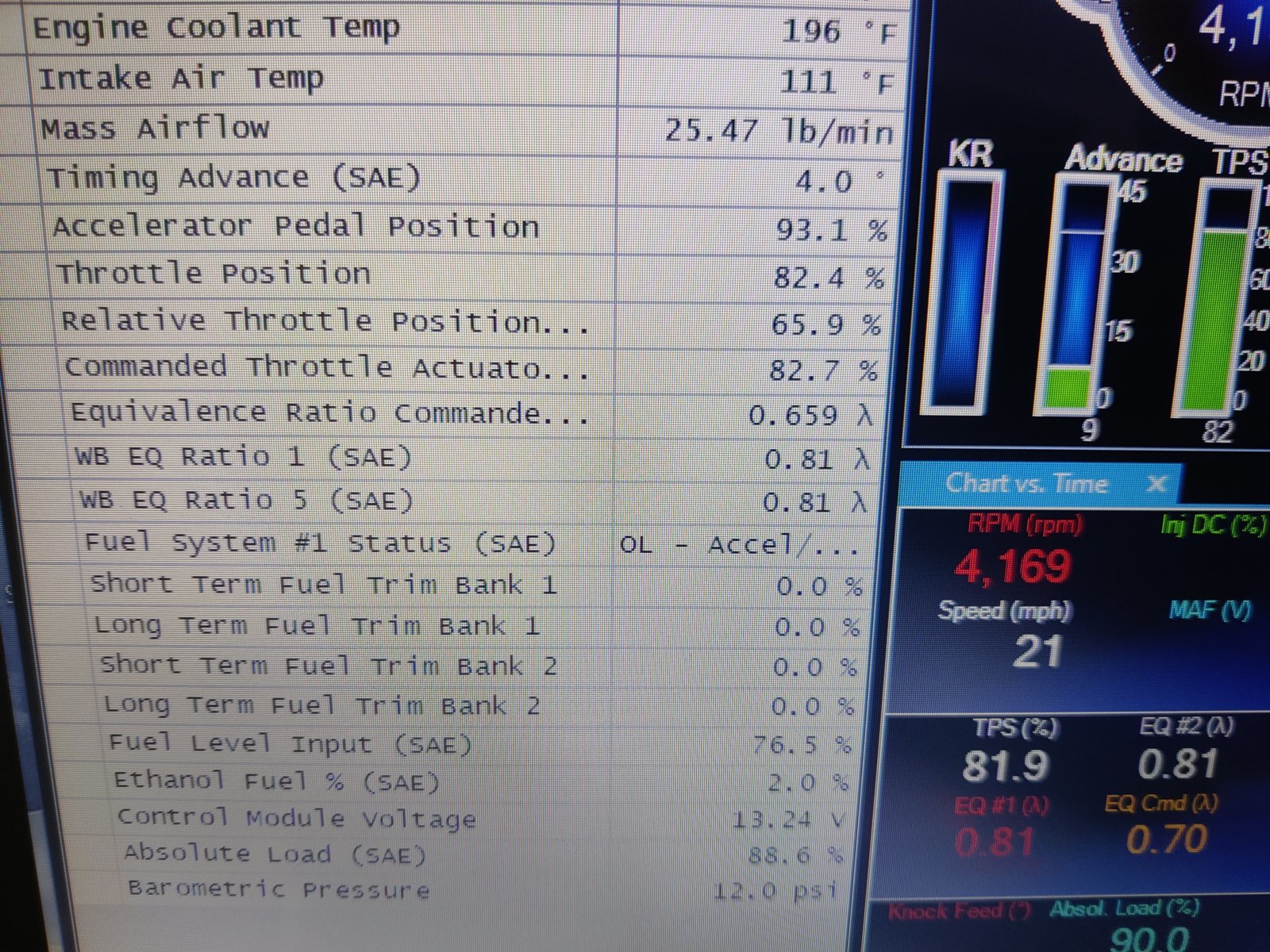

    Finally getting a good amount of data logs in. Thank you @snivilous for the channel/layout, much better then the load SAE defaults! Curious on what you guys are aiming for/data logging your AFR's? I'm consistently @ 0.81 Lamba/11.91 at WOT. Seems a bit lean but not seeing any knock and perfect LTFT's

    You're outside the range of the stock sensors, that's as low as they go. That's why we're all putting in separate widebands.

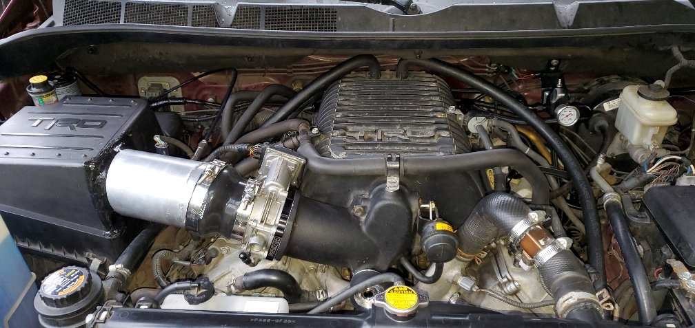

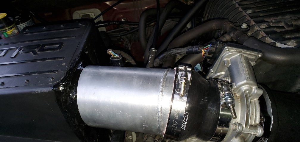

    Well I found my issue I was having. The O-ring was pinched at the lower snout channel. Must have hit it on the pcv valve when I was installing it. Got it all back together with the 4.5 inch intake, 750 Denso injectors, @snivilous 2.2 pulley and Water/Methanol injection at 10psi and up for cooling. Wired fuel pump directly for full flow. Thank you to all on your suggestions and especially @snivilous for getting me items to help troubleshoot and different tunes to try.
    Got some final tuning but it runs great and pulls like a MOFO!!

    Well shoot I'm an idiot. Went over this earlier in the thread and i forgot. Was hoping the scangauge 3 or HP would log but it's a truck problem, I'll get on the craven pod and WB AF/boost gauges asap

    @ARES35 I shoot for 10.5 down to 9.9 for maximum cooling of rings. Sacrifice a little power for safety.

    One more dumbass question and I'm done lol. I know we have 2 02's in front and 2 after the cats, If I were to run some wide band O2 sensors before the cats would the ecm pick up the valves thus allowing me to at least log these sensors for AF? Or is WB AF gauge the only way?

    Wideband logged through hpt prolink or serial USB adapter. Stock O2 can't go lower than 11.8 or something.
    Have wide band bung welded in about 18 inches down from manifold before the first cat at about 930 to 10 oclock position. You can add your gauges to to layout, like I have my AEM at top for afr and boost.
