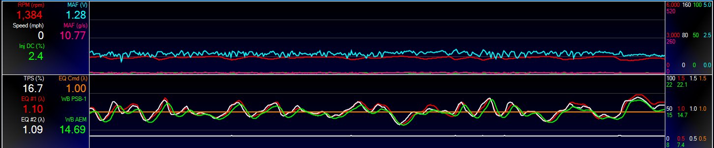

    How does the engine run with MAF disconnected?

    That's great news! Love to have that vital information for I'm used to watching knock at WOT like a hawk:D

    It stalls out

    All I can think of is the snout leaking or lack of fuel. I used a little grey flex rtv to hold Orings in place. Snout went on without incident. Fuel pump is a few months old. Walbro 450 and Holds 45 psi with boost reference and 55 with it disconnected. Still need to re-check injector isolators...

    Should normally throw you in limp mode....seems like fuel is being taxed/air is leaking after the MAF but at this point I'm just shooting in the dark.....

    @ARES35 at this point I am going to disassemble snout and injectors reassemble. Drop tank and look at supply tube from pump as I could have slipped partially off.
