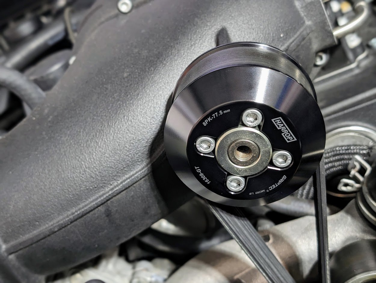

    Had no issues towing with the smaller pulley this weekend. This is the hilliest trip we take each year by far. It pulled great as always, lots of glorious sounds coming from under the hood and out the tailpipes. On a lot of the long steep grades I was watching my Throttle position, boost, AFR and IATs. Long sustained uphill pulls I was seeing around 6psi at about 45-55 (degrees?) TPS or roughly half throttle at around 2800-3000 RPM. I also saw typical rich AFRs above 40%TPS, and the highest I saw the IATs level out to by the top of the hills was 50 degrees over ambient. It would be cool to see how the other SCs on the market compare on post IC temps in that particular scenario.

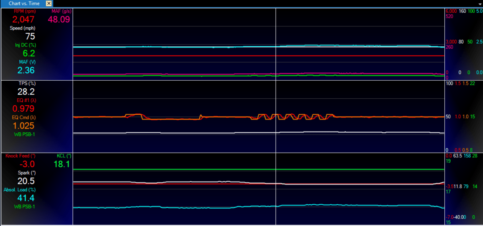

    When I looked the first time, I didn't notice that the gauge was indicating "02 E8". When mine isn't indicating it shows "02 HTR".
    And back to the subject of "anomalies", I collected this log on Saturday. Didn't notice a thing until I happened to glance at the screen. I don't really know of a reason to be worried about it though.
