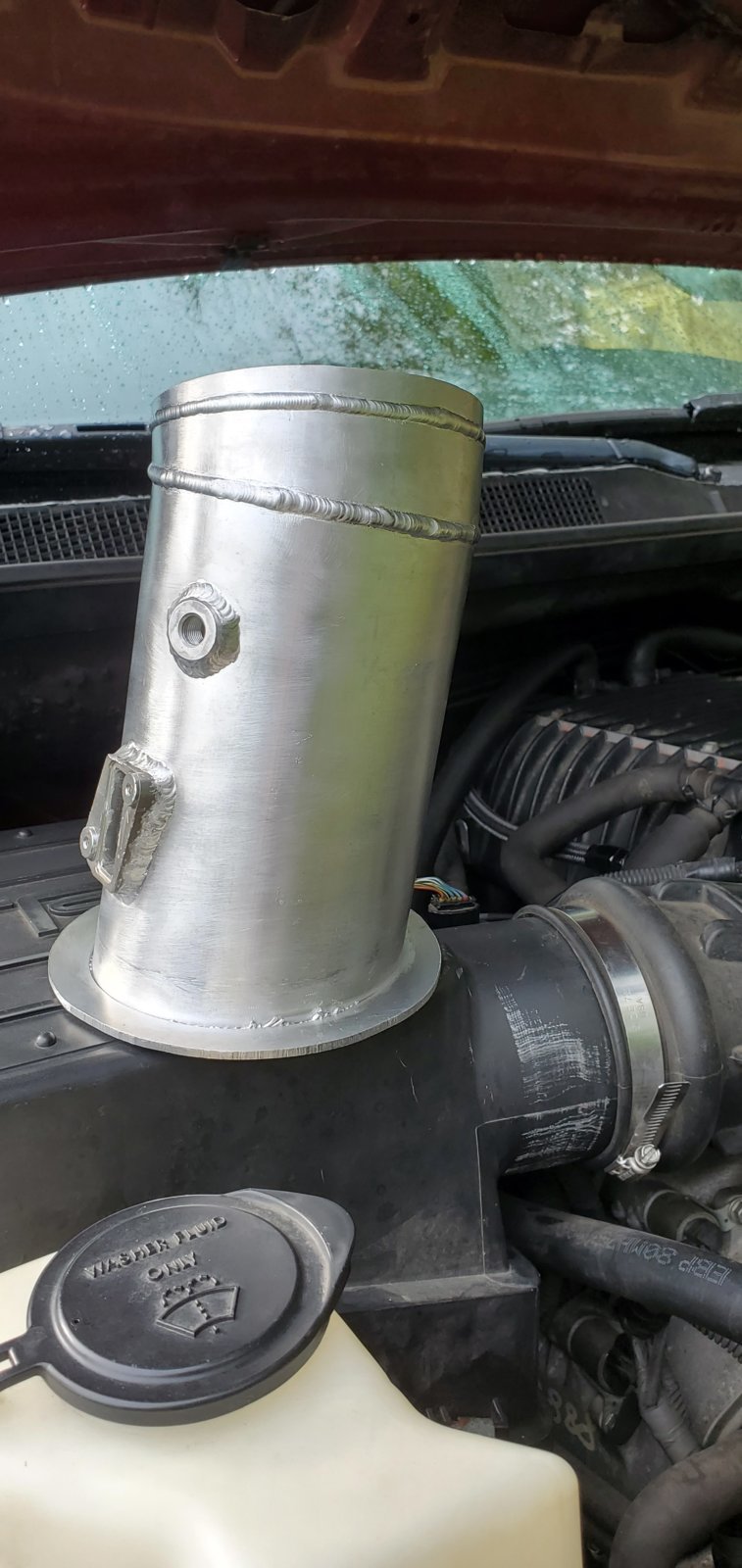

    My neighbor Nikole migged up the lobster tail on the intake. She did a great job. Now I don't have to use 2 silicone adapters, just one reducer. Time to get this going. 4.5 intake to RCF. 750 injectors remove bevel on fuel rail tubes for better flow(matt smith mod)and snivs 2.2 pulley. I'm at 10.1 psi and should be at 13. 3 inch exhaust from LT's to tailpipe should help. Hoping that overdrive crank pulley doesn't push me over 13...

    OK now you need to make more and hand them out to the rest of the class! Props to you and your neighbor!

    She works in the shipyard and anything that fits in a backpack is fair game. I still have to hack up the TRD box.
    Just ported the snout inlet for RCF. Broke a harbor freight special puller trying to get the urd pulley off. Fun times...

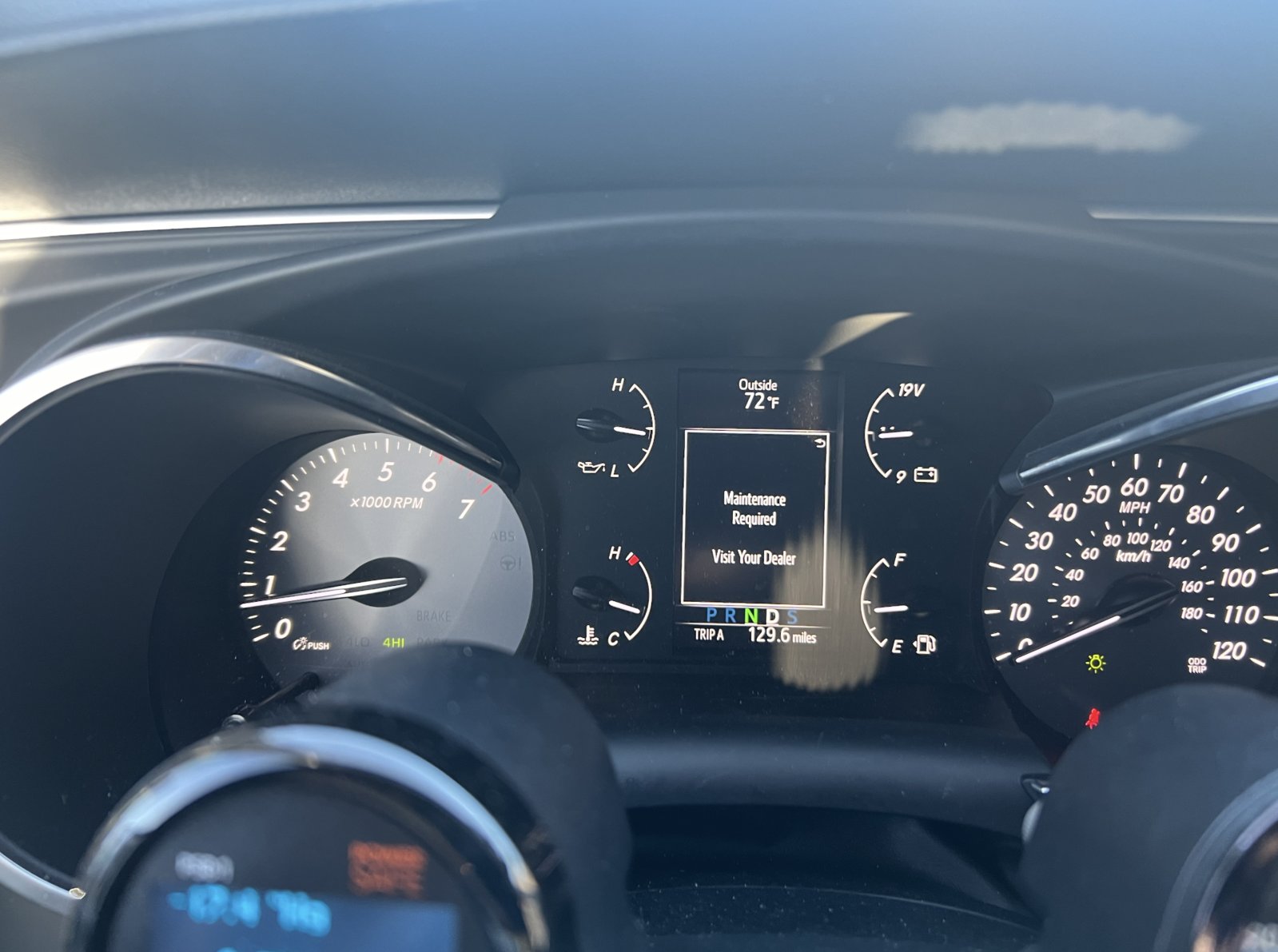

    Unrelated, my '18 cluster demands maintenance be reset using the steering wheel buttons so since it's cobbled to a '13 truck it's stuck. Anyone know if I can reset it in techstream? I have a 400 mile trip & I'd like to have the speed in the center box if I can.

    Do you not have any control over that screen with your steering wheel controls? There’s a maintenance reset in the screen under settings
    Not sure if you can do it with ts or not, never tried since I’ve always used the menu to do it.
    might be able to do the hold trip odo button when you turn on ignition

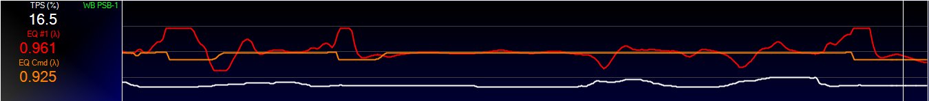

    I noticed this little anomaly in my log from yesterday. I don't know what to make of it, none of the other parameters changed. Cruise Control was set. There was nothing unusual on the WB. There was no sensation of surging. Thirty second snip. :confused:
    Found another.

    I know the autel can, and pretty sure I saw the setting in TS when messing with that. But unsure about the 2018 cluster on a 13 bit

    The screen has the buttons locked out. Happens in low fuel too. Easy fix there just add gas. I can't do anything through the cluster. Worst case, I'll have to pull the plug. That'll reset everything but mileage.
  26. Oct 15, 2023 at 7:13 AM
