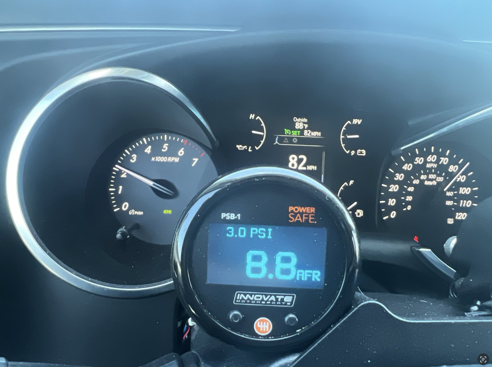

    Does the AFR from the factory o2 sensors w/obd2 show full rich (11.9) when this is happening?

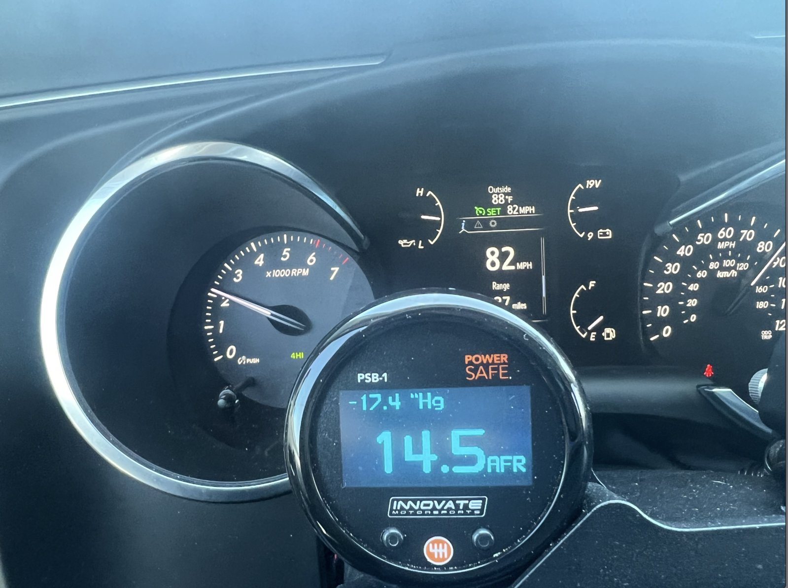

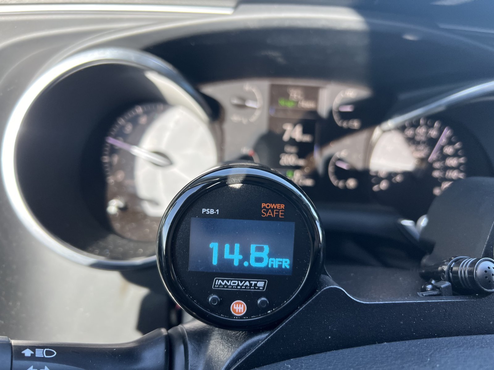

    I don't know, until last week the Innovate was reporting to HPT, I had to use Logworks yesterday.

    400 miles to LA. Oddity never happened. In stop and go taking off it went to 9.x then right to 14x
    Gaaa none of the 9s are legible.
    That's where it happened on the 10 West.
