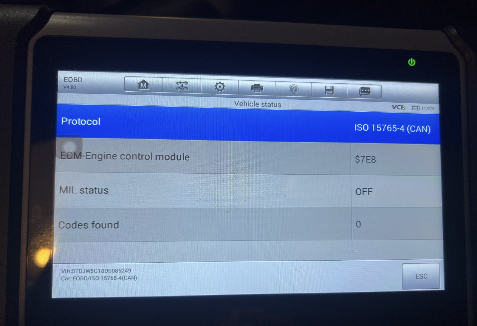

    Any codes?

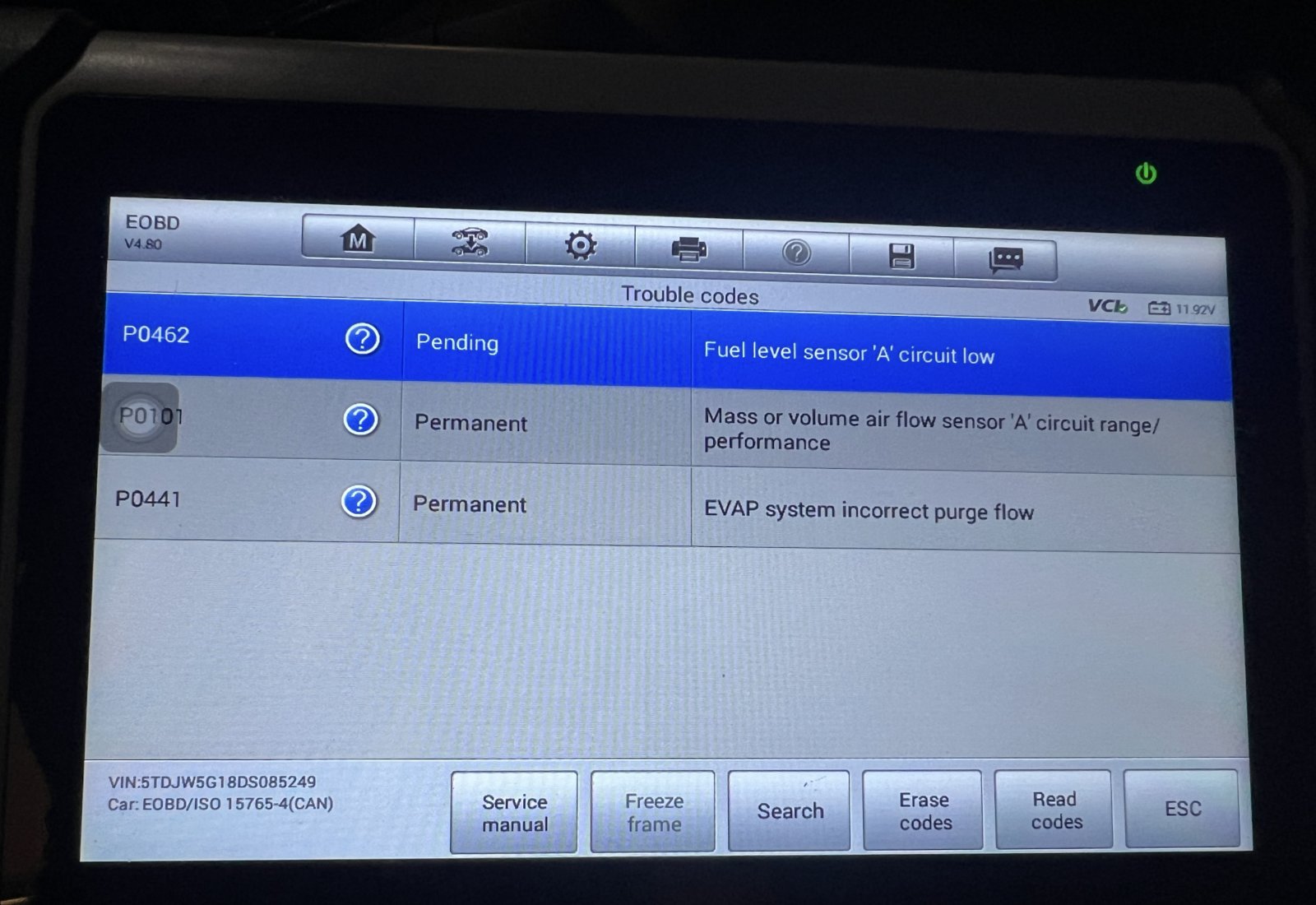

    No leaks, I have sprayed 1/2 a can of MAF cleaner on every possible vacuum location without any fluctuation in idle.
    Sniv said there are anomalies but all looks ok.
    The fuel level sensor is from the deletion of the flex switch/bypassing the fuel pump main harness that is only powering the relay to the direct harness that is running the pump.

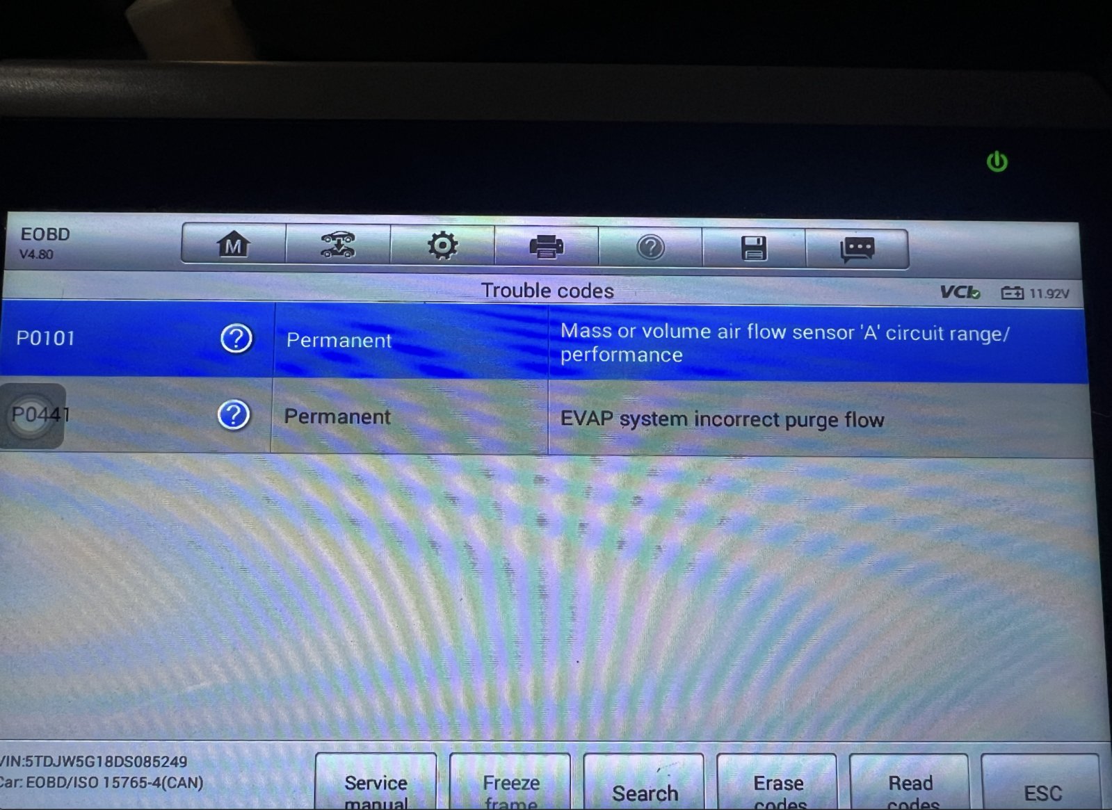

    After clearing.

    Is that code a vacuum leak or evap type code? Vacuum pcv valve for the evap? By the rail?

    @e30cabrio have you looked at the MAF harness for any shorts, loose pins? O2 wiring? I've always hated being a parts changer instead of finding the root cause...install a new MAF? It sucks to throw parts at it though.

    Something with purge flow for evap, gas cap, blocked line or wiring not switching. Not supposed to be a big issue. but not 100% in his case.

    I had an evap issue. Swapped the purge flow by the rail, gas cap then finally a canister. Purge flow and cap is an easy cheap fixes to try.

    That has been there for months, when I lost the fuel line a few months ago near Palm Springs & had it fixed professionally, they went over the system with a fine tooth comb, tested function, said all is as it should be & as it does not hurt anything & emissions tests ignore it (I passed smog with it) they said leave it alone.
    I cleaned the old MAF when it was pending, it kept coming back. I got a new OEM, it kept coming back. Not sure when it became perm.
    If the price of admission is a loss of a few MPGs I'm good, If I can improve the MPGs that would be nice!

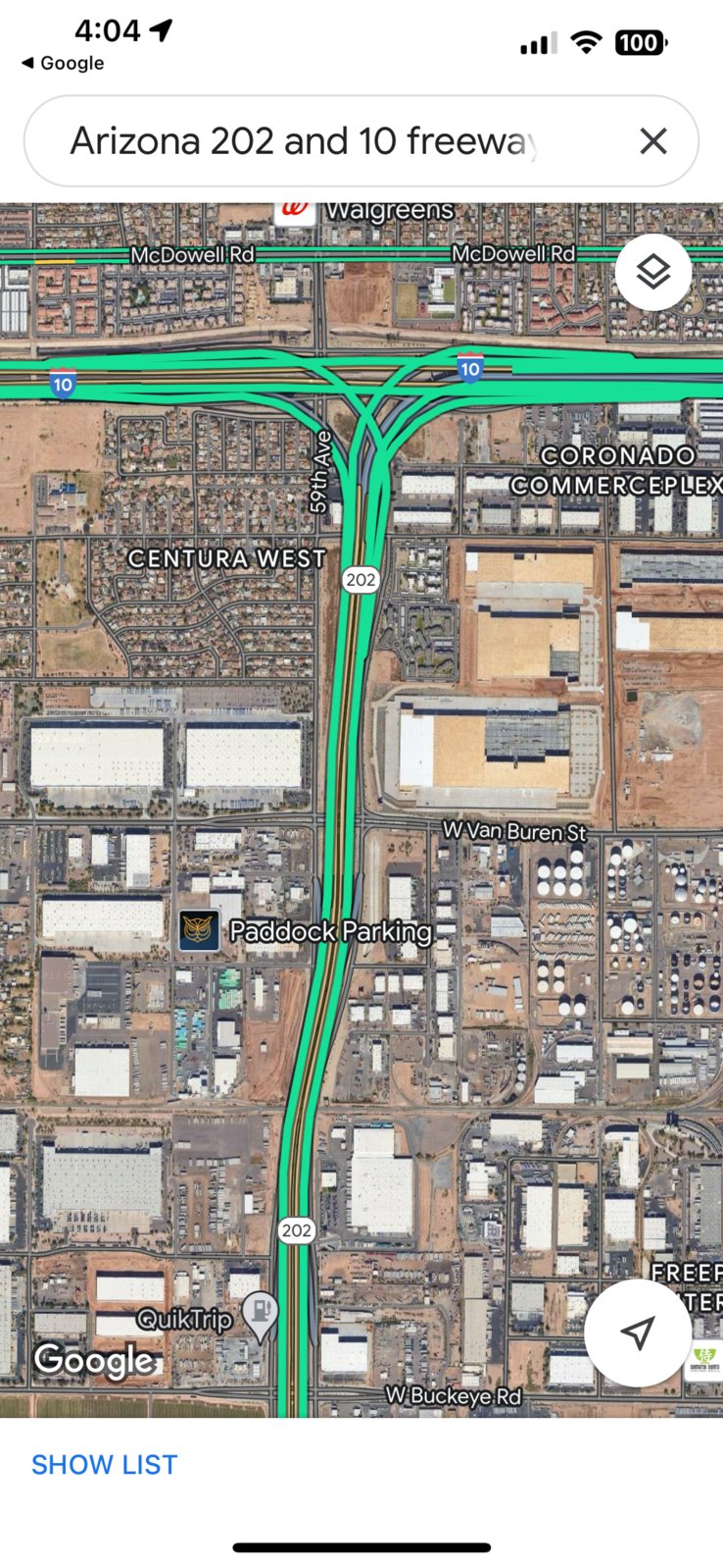

    I first noticed it on the freeway, on cruise pretty much flat road, nothing I'm doing changed, it stayed over 14 at that point.

  24. Oct 13, 2023 at 3:35 AM
    nobodyintexas
    nobodyintexas What?
    Jun 22, 2020
    #48303
    6,965
    South of Houston
    S/C'd 2020 White 1794 Tundra
    3psi on a flat road?
    is your bypass freaking out?
    Wynnded likes this.

    Yes. But it's been out for at least 2 months. This started this week.
  28. Oct 13, 2023 at 4:05 AM
    e30cabrio
    Oct 20, 2017
    #10410
    6,569
    West Valley, Phoenix, Az.
    Boosted 2013 Sequoia TRD FAUX
    Was about Van Buren when it happened.
