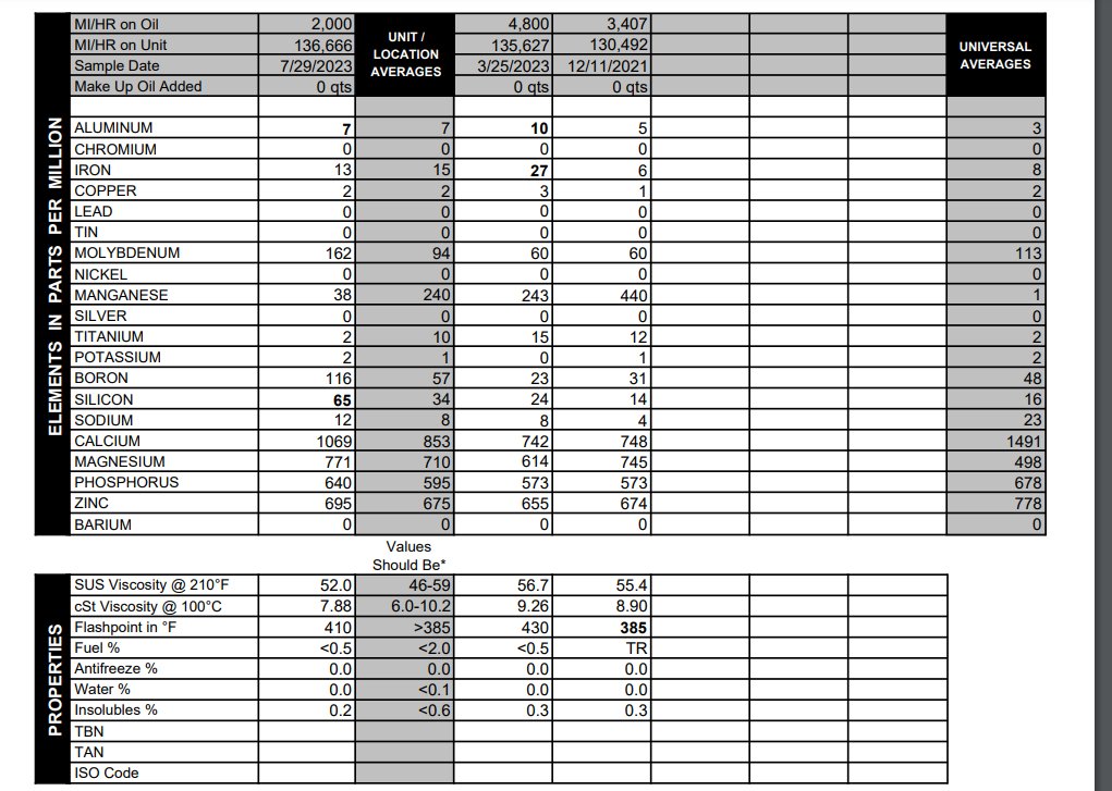

    I have been doing 5k oil changes and am nearing that now. I have to go back to L.A. again Friday, I had this report done @ 2k miles to see how the SC was treating the motor (2k on the sc at that time)
    Do you guys think I am ok to go about 500 over 5k?

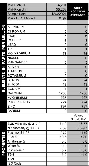

    in the future...TBN would help.
    this is Kirklands 0w-20 on the 1st 4200 miles of my S/C.

    I'm on Amsoil 0-20. I'll get the TBN next time, looks like I'm pretty close to yours but 1/2 the miles.
