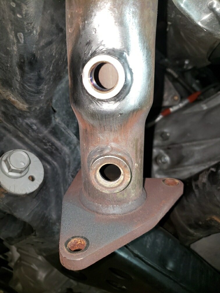

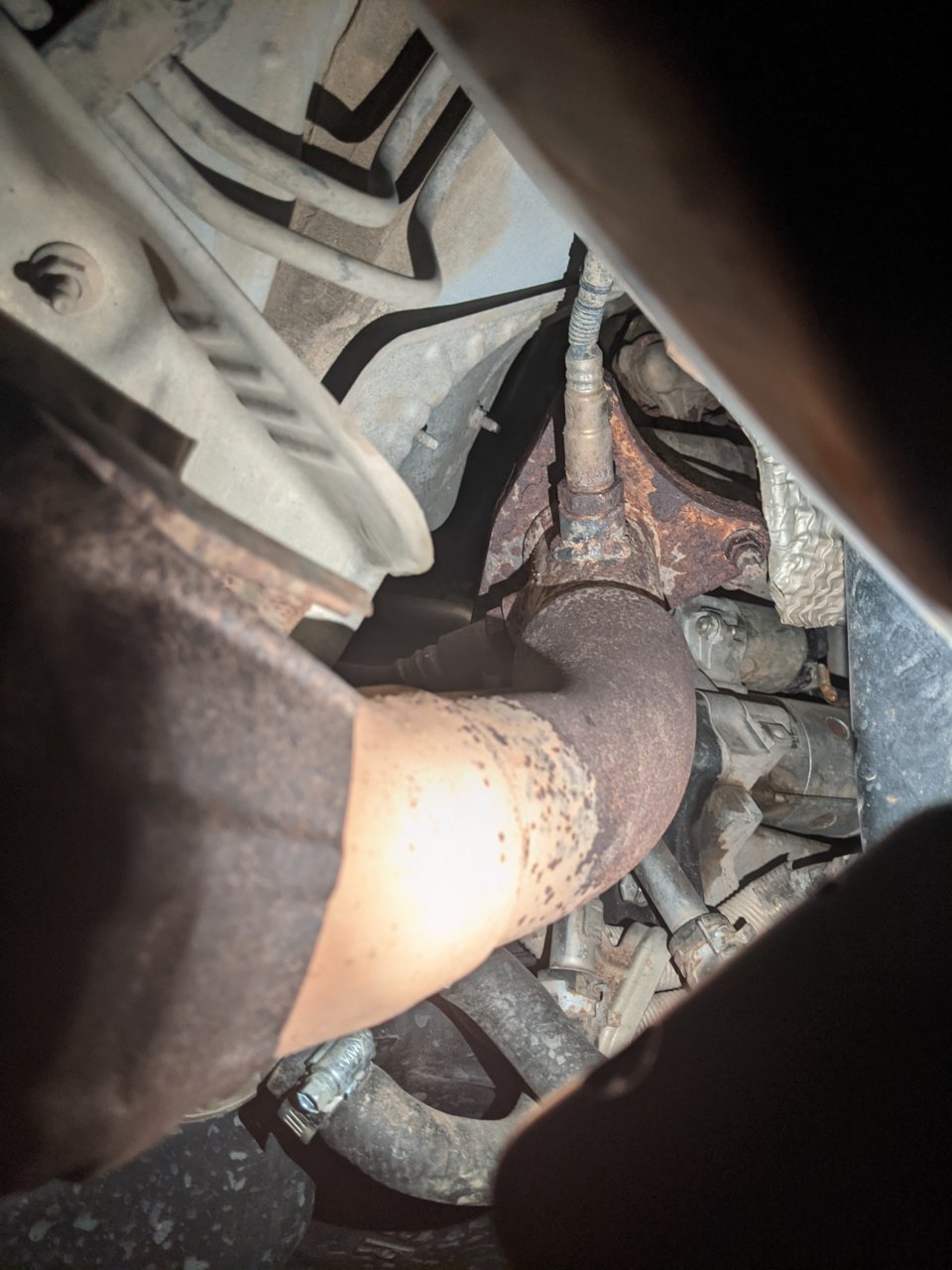

    Mine is welded in after the first O2 sensor on the drivers side. Ideally you would monitor both banks however. I may switch to a dual wideband one day. It’s harder to install it on the drivers side than the passengers but since cylinder 5 is the one that usually blows I went with bank 1.

    +1 for the innov8 boost/AFR gauge. Little spendy but I haven't seen anything else that can monitor both plus it has a lot of other capabilities, and if integrated into the dash looks pretty factory.
    Similar to above, but my O2 sensor is clocked about 90deg from the stock one on the passenger side.

    I had mine installed in the same location, only the passenger side monitored.
