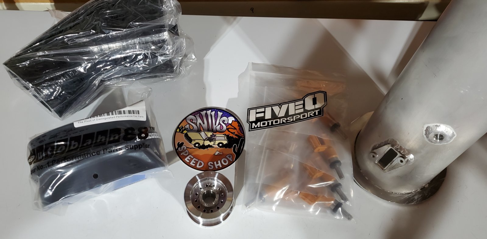

    Christmas came early. Guess the kids don't need presents. Well they are in their 30's...haha
    Got the Super Sniv pulley setup in 2.2, some 750cc fiveO injectors and a homemade 4.5 inch intake for the RFC throttle body. Getting up the guts to hack up the TRD intake. Will grind and cut flange to fit inside of intake. Want to keep drop in filter. Think I have room for a second SABM on fender. Will have 3m glue for aluminum to ABS and either rivet or bolt for added measure. Thinking rivets from outside in case one gets loose so its not sucked in. Will get in touch @snivilous for getting it dialed in.

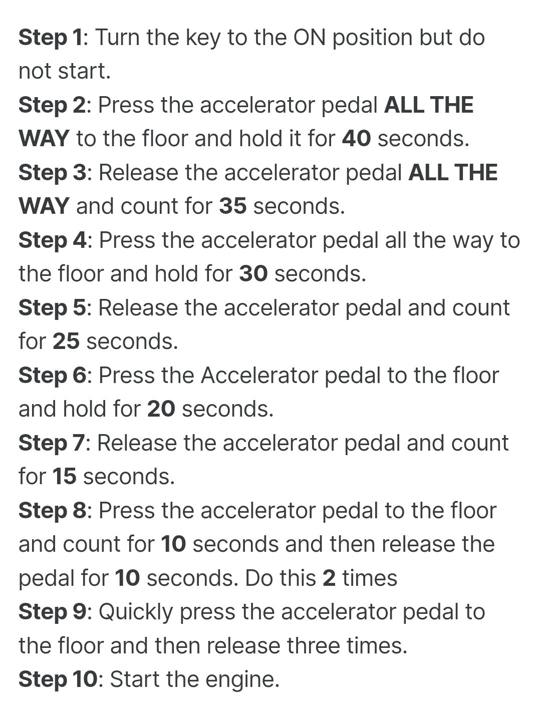

    @M3Tundra-JK do we have to do a throttle relearn after new battery? Saw this on Toyota nation. Thought it couldn't hurt to try...I never had to.

    I tried a version of that last week. Just steps people had posted, but nothing official. And wasn't sure if its the same procedure on the 2021 with push button start.
