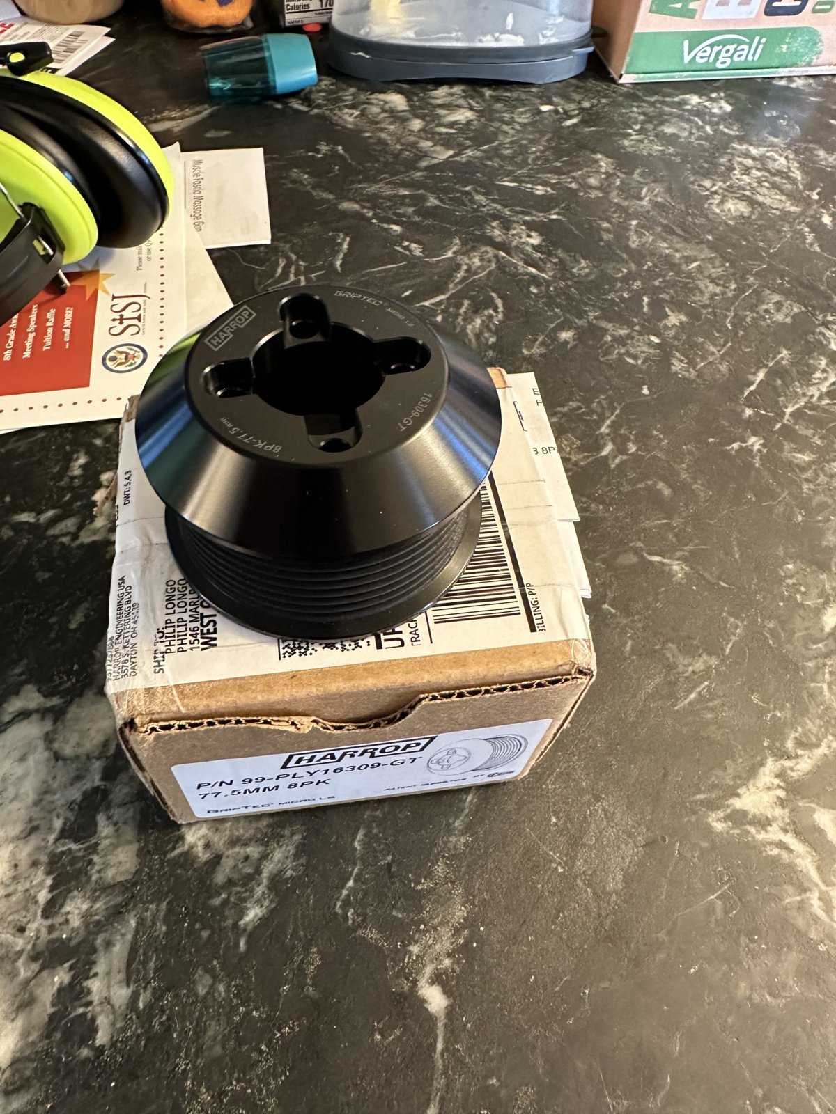

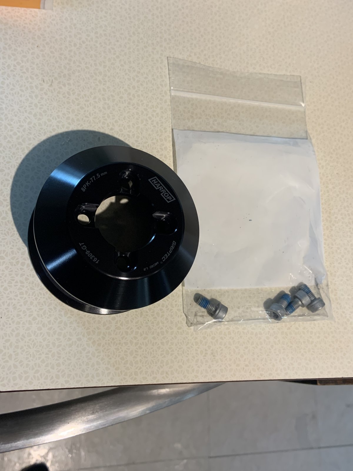

    It has arrived…. Not sure if I’ll get to it tonight or not. I also ordered a new set of bolts from Harrop after I ordered the pulley as a just in case.

    Sweet. Mine gets here tomorrow

    Mine came today

    Pray with me as I go from phase 2:
    To phase 3:
  16. Oct 5, 2023 at 3:44 PM

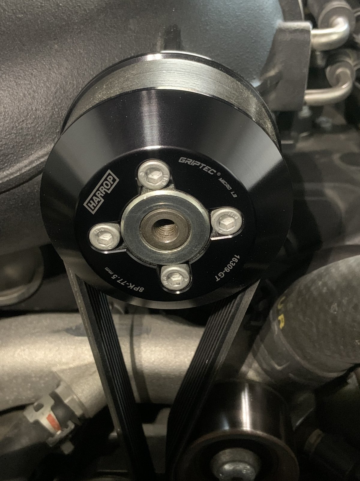

    Got the 77.5 on. Earlier today at 75 degrees I noticed mostly 7-8psi. This evening granted it’s 10 degrees cooler at 65 but I saw mostly 8-9psi. I’m sure a longer pull/cooler weather would result in 10. So an extra 1 psi as expected. Have to keep an eye on things over the next few days, supposed to tow my camper next week so it was probably stupid of me to swap it before that trip. Probably fine though.
    Also, don’t be a dumbass like me and double check the belt didn’t skip a few ribs on the lower pulleys on the engine before starting it back up lol. :rofl:About shat myself when I started it and heard a noise similar to a worn coupler, luckily nothing but some surface scuffing on the one side of the belt. Between that and changing my coilovers/shocks last weekend I’ve decided I’m really not an auto mechanic.

    So the stock Harrop belt was all good? Good to hear.

    I don’t see any issues so far anyway, it seems to have gotten plenty tight. I’ll have to see if there is any belt slip issues or anything as I drive it more but have not noticed anything in my brief test drive. It’s such a minimal size difference.
