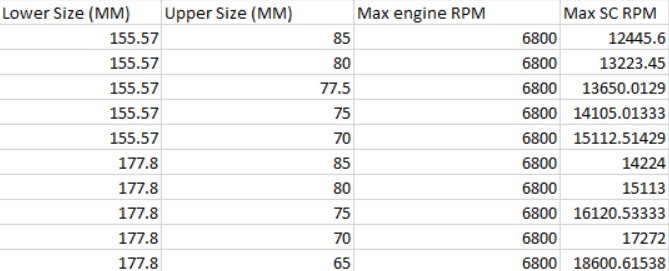

    Magnuson told me yesterday that going to a smaller pulley will void the warranty FWIW.

    I wonder what Harrop's perspective is, with them actually offering smaller pulleys.
  30. Oct 5, 2023 at 9:36 AM
    Chris@Harrop
    Chris@Harrop New Member
    Feb 19, 2020
    #42864
    32
    As long as blower speed stays under 18k there is no issues.
    Unless you are running a larger lower and a 65 upper or revving the engine more than 6800 you won't get outside the warranty rpm.
