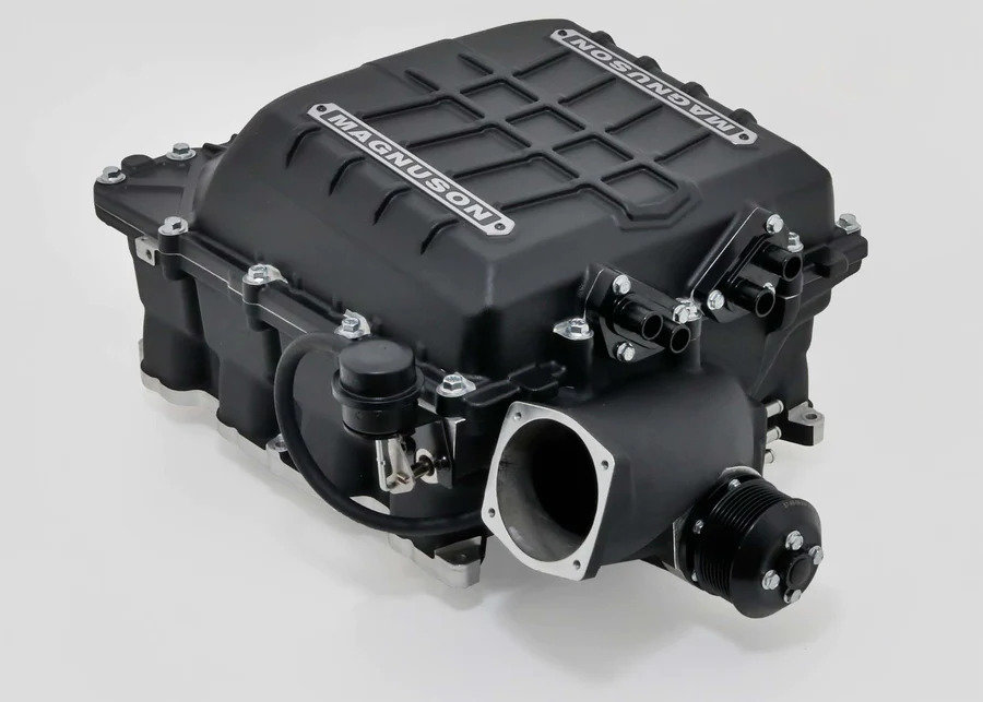

  17. Oct 3, 2023 at 6:11 PM
    mZiggy
    mZiggy Honey badger
    Sep 11, 2021
    #67918
    300
    Marc
    2020 Tundra SR5-CM; 2020 4R TRD Pro; 2008 4R SR5 v8
    Magnuson TVS2650 arrived this afternoon
    VWTim, rockmup, M3Tundra-JK and 11 others like this.

  19. Oct 3, 2023 at 6:57 PM
    Saltyhero13
    Saltyhero13 Throbbing Member
    Aug 12, 2020
    #50704
    4,947
    Fuel delete mod Cup holder upgrade
    Cool, seems like Magnuson was able to ship these out quick.
    Any first impressions?

    assuming the pulleys are the same size...and...85mm being "stock" pulley:
    selfishly, I'd like to see this 2650 perform damn near exactly as the Harrop....because, well, it is.
    maybe we will will also see the slight performance differences in design.
    mainly:
    one blows up, the other blows down - does it matter?
    does post blower IAT sensor affect tuning/performance?
    <hat tip to those that are getting the 2650 Mag>
    I'll be sitting over here waiting to see the dynos & dragys.
  25. Oct 4, 2023 at 4:35 AM
    mZiggy
    mZiggy Honey badger
    Sep 11, 2021
    #67918
    300
    Marc
    iirc it's a 3.4" pulley, so ~86mm, comparable
    Saltyhero13 likes this.

  29. Oct 4, 2023 at 5:44 AM
    ZPhilip
    ZPhilip Custom title here
    Sep 20, 2019
    #36383
    1,487
    Philip
    West Chester, PA
    2015 Platinum Super White Crewmax
    Harrop supercharger, TRD Pro Fox suspension, CB +1 shackles, 295/70-18 Toyo ATIII, TRD Pro forged rims
    Let’s hope the IAT sensor is post blower so we can compare temps to the Harrop. Up vs down, etc.
    Mdl and Saltyhero13 like this.
  30. Oct 4, 2023 at 5:54 AM
    Silver17
    Oct 3, 2021
    #68847
    3,739
    Eastern PA
    2017 TRD 4x4 Harrop SC
    Nevermind I see it is a quick change in the pics. I wonder what the process is to change the coupler out on this style? Doesn’t look like a removable snout like the old one but can’t really tell in the pictures.
