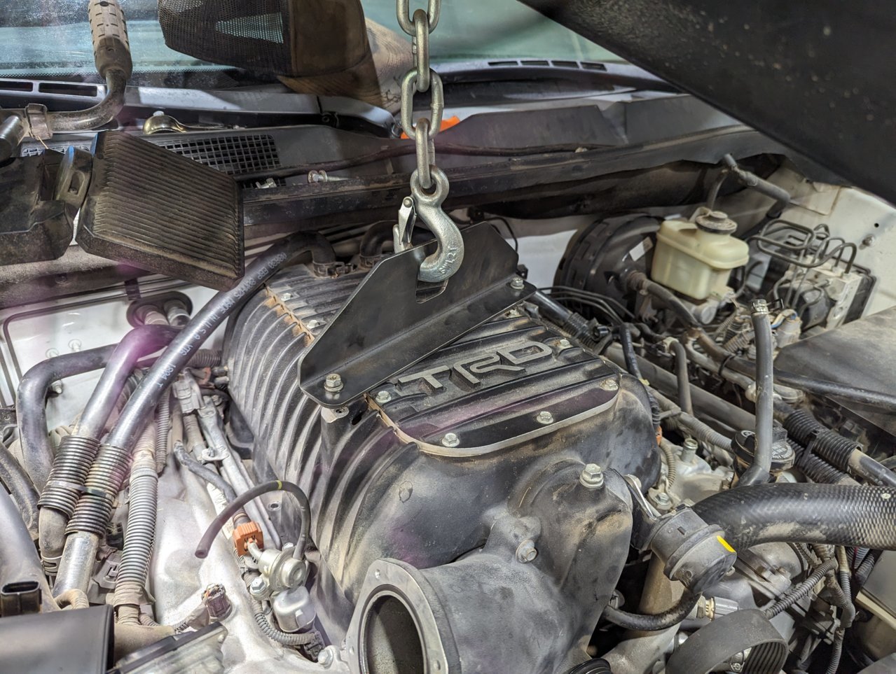

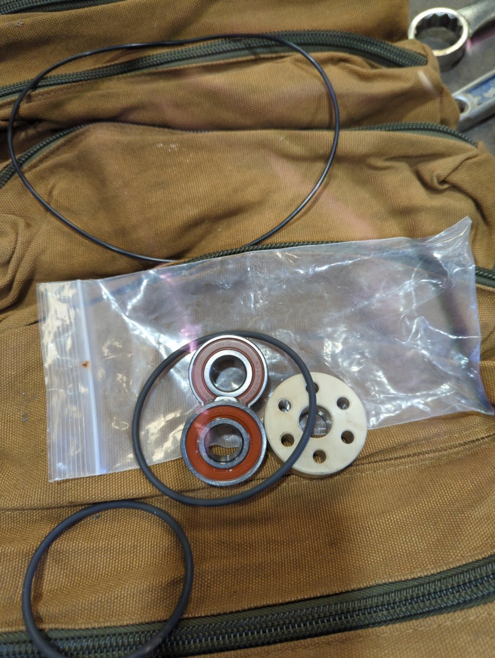

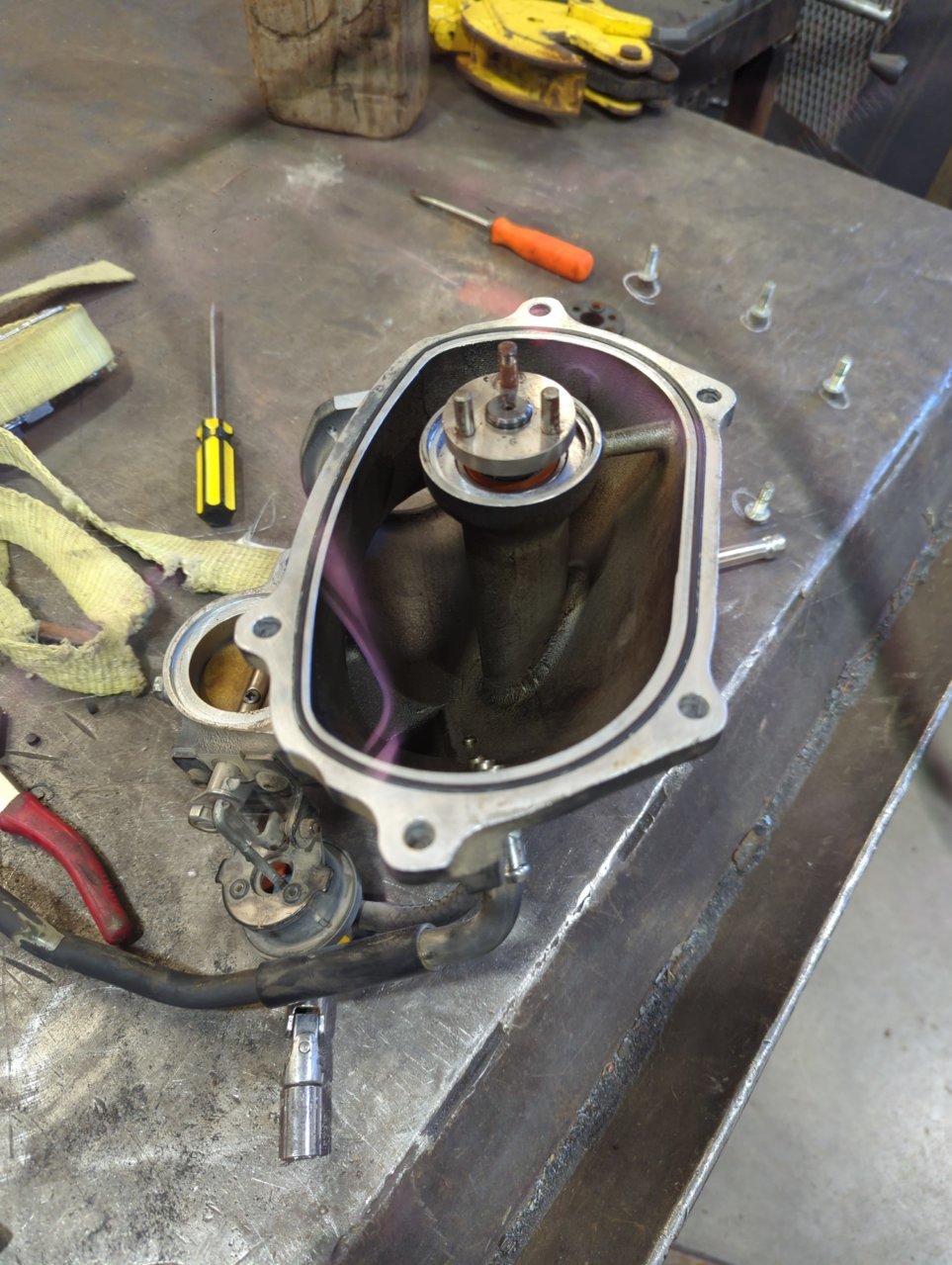

    So I decided to yank the supercharger out this morning for the coupler. The rebuild kit came with the truck and I didn't realize it was the kit with new bearings. Can anybody point me to instructions for the bearing portion? I'm to the point of putting the new coupler in and putting it back together now. Should I even worry about the bearings?

    Yes, do them while it's all apart.

    I second replace the bearings. The pulley is a bear to get off sometimes. But everything else should go well.

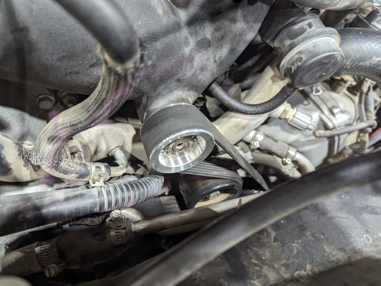

    Got it all done. All quiet now. The new pulley from @snivilous is pretty sweet. I went with a 2.2 and it made a noticeable difference.
