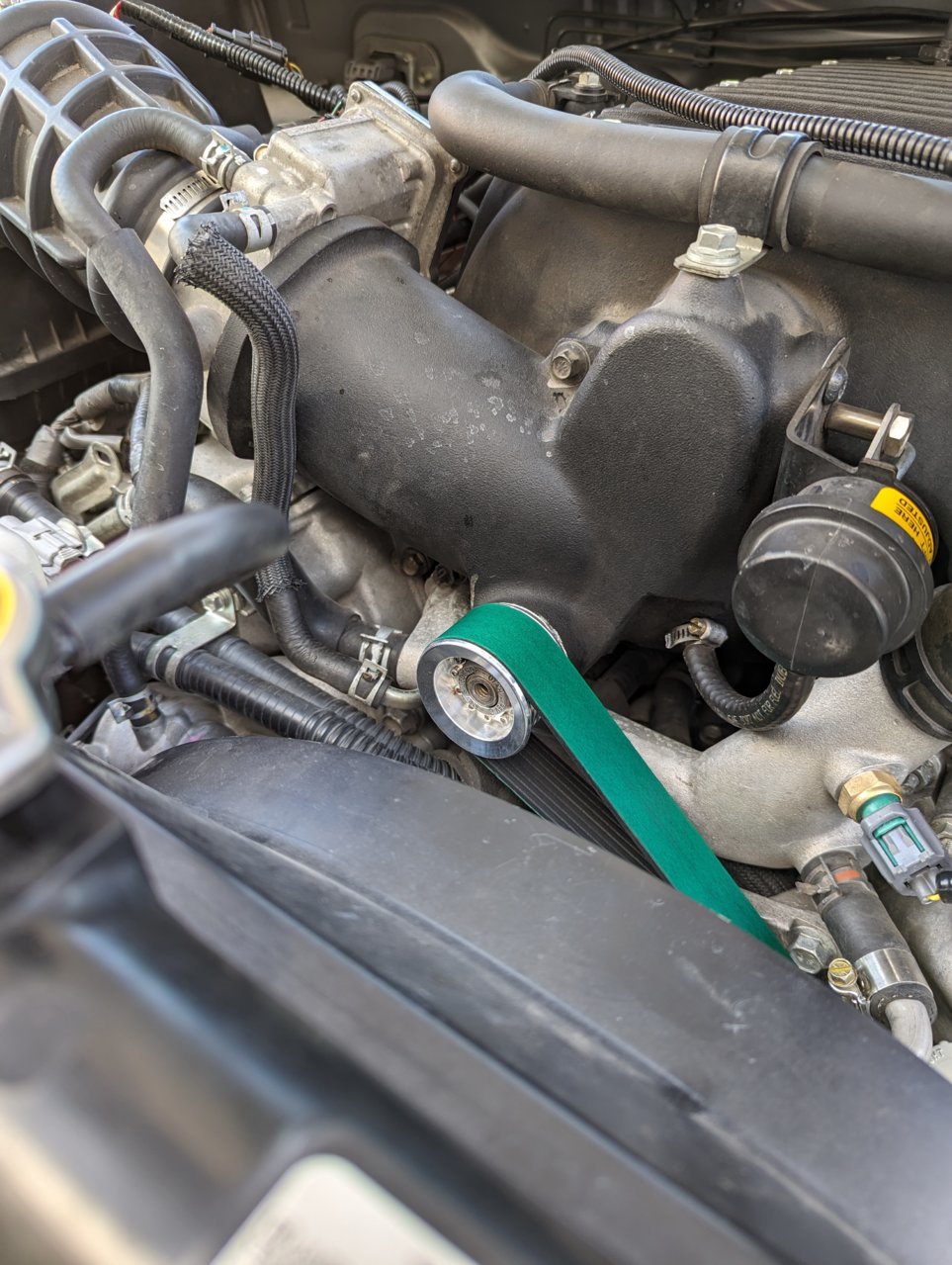

    "The Heat" is on...:burnrubber:

    Green belt definitely means business. That sniv pulley looks sick

    What size did you go with?

    The 2.00". I'm at 8k ft. elevation, so this should give me the estimated equivalent of what the base pulley produces at sea level.

    Gotta go out to get a couple of logs now and fatten up the top end fuel.

    So, what's your first impressions with it even though you haven't completed any WOT runs? Noise, boost timing off idle...? I'm excited for the 2.2"!

    On startup you can tell that the blower is spinning faster, the sound is different. There's a little more whine getting up to 45mph. I did get a few WOTs to check and adjust the Power Enrichment table. I got it bang on with the first try, brought the AFRs down from 11.5-ish to 10.5-ish, proud of the gas I saved.:rofl:
    I was surprised at the difference in acceleration, much quicker getting up to speed on the interstate. I had the passenger side window down part way while next to a concrete retaining wall at about 80% throttle and the exhaust had a bit more snarl. That was unexpected from the Dirty Deeds 10".
    I don't think fuel trims changed as I didn't drive that much, but I subtly adjusted the very low end just because. Weirdly, there seemed to be less Knock Feedback as well, but I think I need to bend @snivilous's ear a tad in that regard. I need to determine what I think I understand in order to formulate any questions first.
    Very satisfied.:thumbsup:

    That's awesome!!! I recall there being a pretty noticeable increase in whine going to the 2.0" too, kind of an unexpected perk.

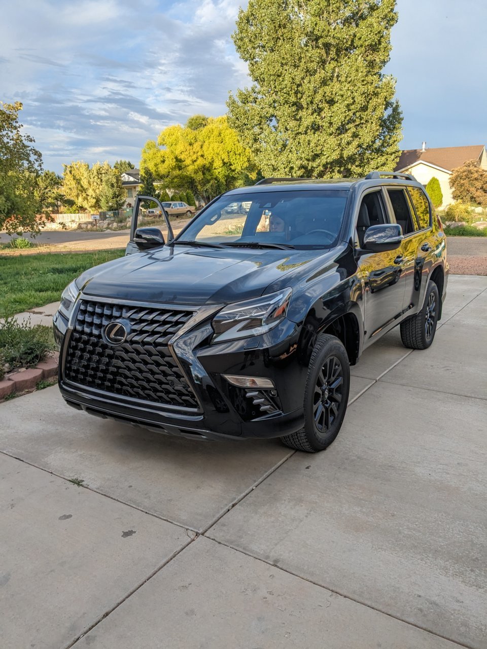

    We came home with this today! 2022 GX460. And you know I'm already looking at blowers and tuning, which as expected is extremely limited so might have to throw some Sniv Speed Shop engineering at it :D

    Upgraded the 4Runner?

    Yes sir, it actually got rear ended about two weeks ago. Still waiting to hear back from insurance. We had been looking around at cars semi seriously for awhile though, the 4Runner was at like 298k and just getting long in the tooth. Her getting rear ended made us a bit more serious looking at stuff, and a few coincidentally had popped up for sale locally and this one had all the options and color setup the wife wanted.
