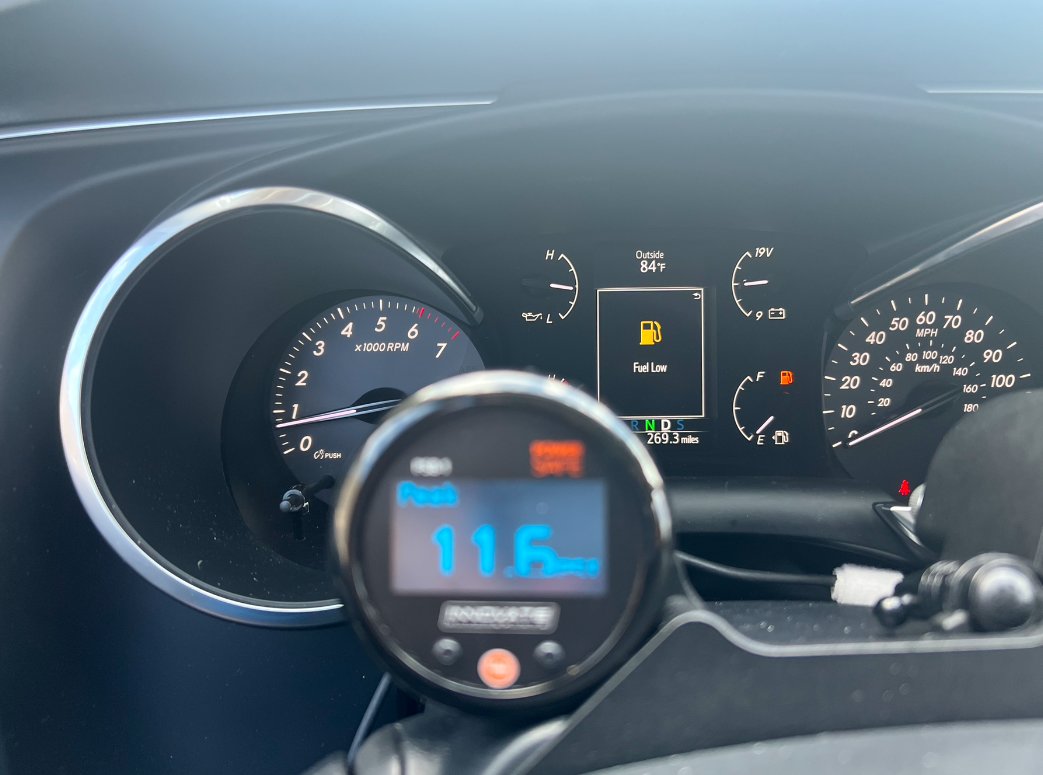

  23. Sep 20, 2023 at 11:11 AM
    e30cabrio
    Oct 20, 2017
    #10410
    6,337
    West Valley, Phoenix, Az.
    Boosted 2013 Sequoia TRD FAUX
    Just saw 11+ for the first time.
    Fastlane47, Mdl and Tripleconpanna like this.

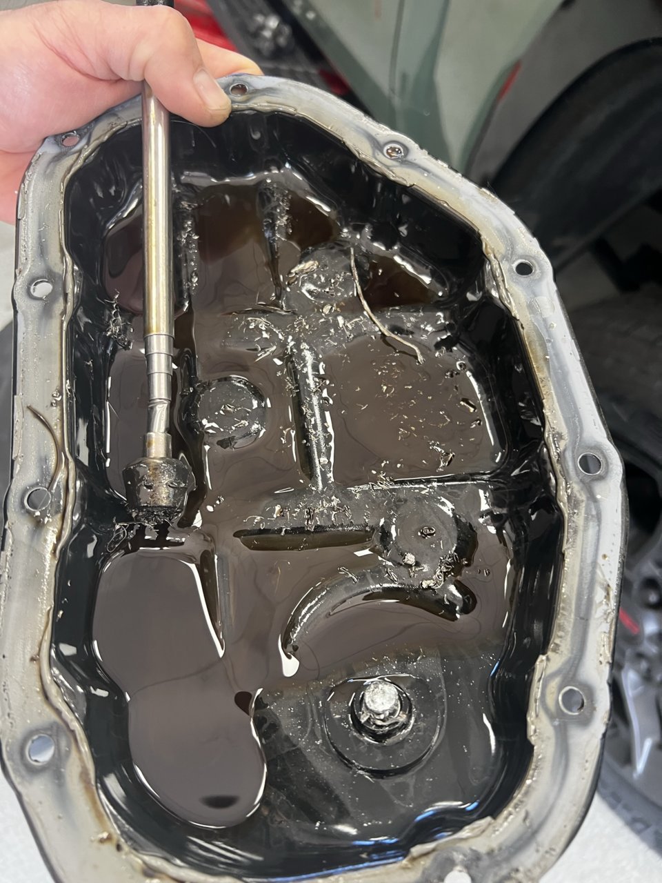

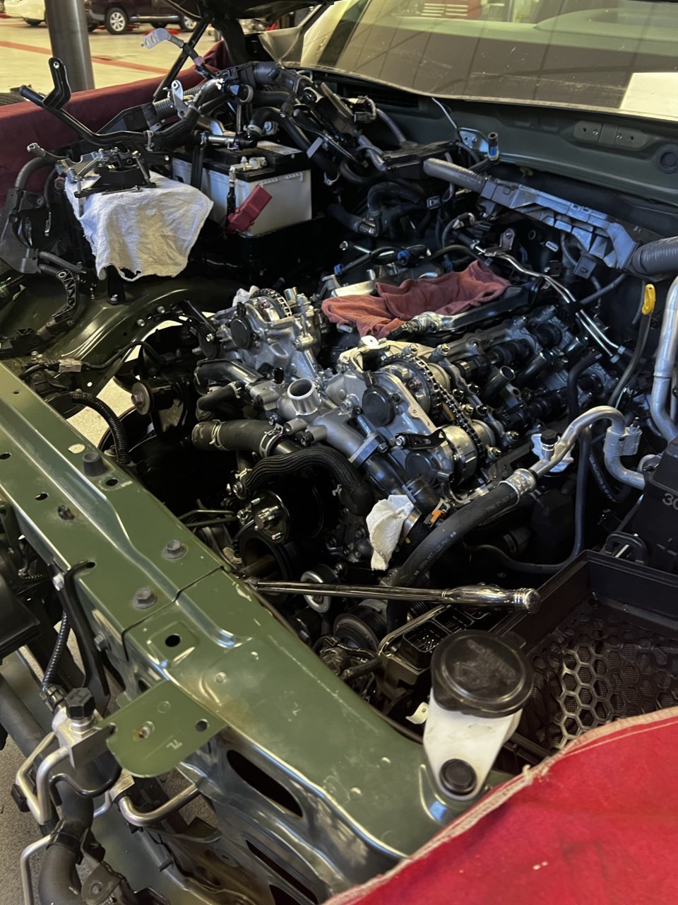

  24. Sep 20, 2023 at 11:14 AM
    ssmokedz
    ssmokedz Toyota Master Diagnostic Technician
    May 9, 2019
    #30282
    327
    Shelton CT
    2019 Super White Tundra TRD PRO
    From what we keep hearing in our tech conferences there is casting slag that is getting sucked up the oil pickup and wiping out the main/rod bearings. We currently have our second one in the shop right now completely locked up. 14k miles. The last one was at 28k. I will gladly take apart a 5.7 twice instead of taking apart this new engine once.
  25. Sep 20, 2023 at 11:16 AM
    e30cabrio
    Oct 20, 2017
    #10410
    6,337
    Wow. I'd be very unhappy if my 14-28k "new" motor was opened up like that.

  27. Sep 20, 2023 at 11:49 AM
    Tripleconpanna
    Nov 11, 2021
    #70515
    12,694
    2021 TRD PRO CM; 2008 SR5 CM
    Let me guess.... just before that blast of boost, the fuel level read 1/2 tank :rofl:
