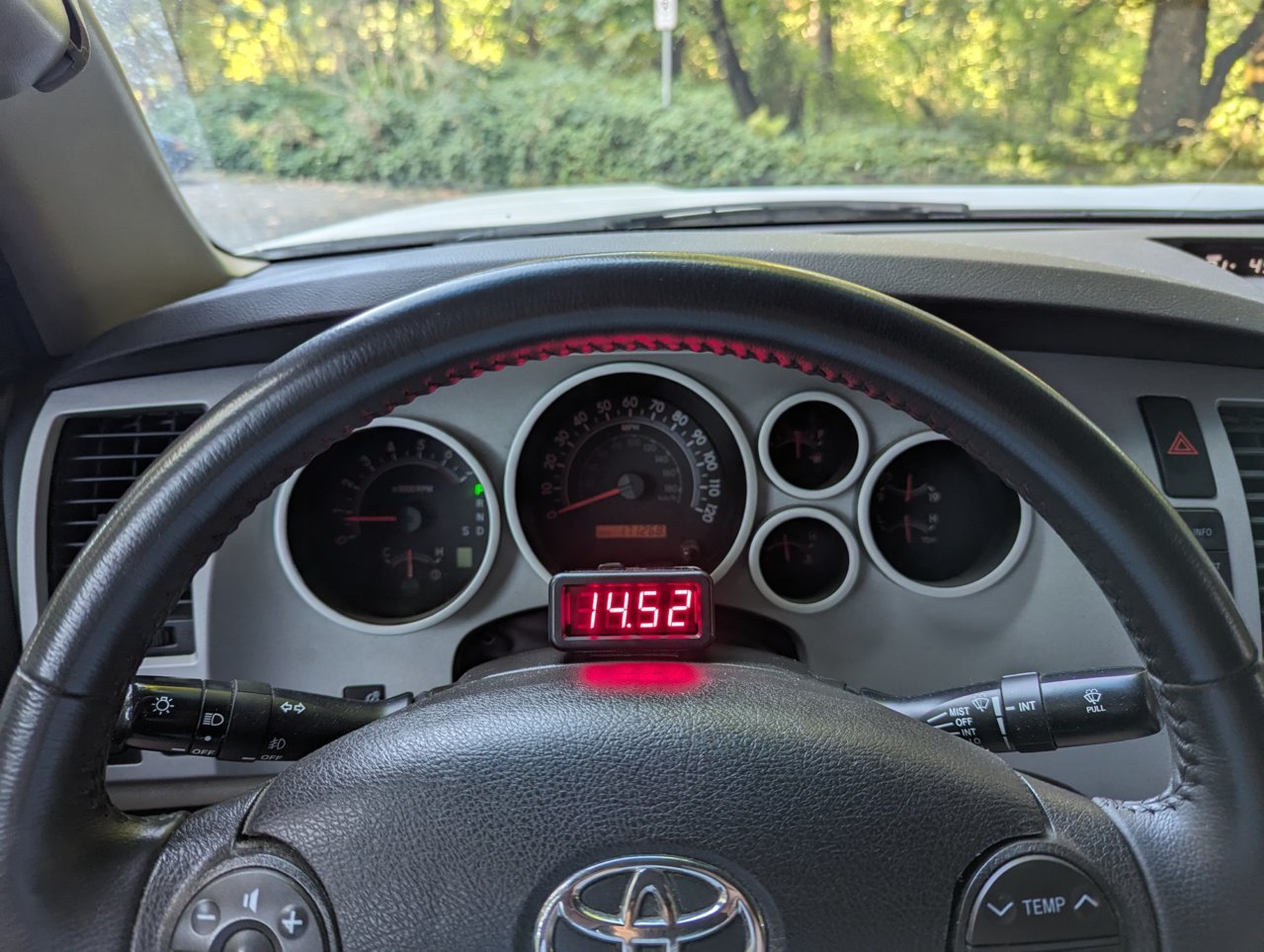

    PXL_20230913_235819760.jpg Wideband installed, would have been pretty seamless until my 2nd weld pass on the sensor bung was a little hot. Had to drill out the plug and retap the threads.
    Did a gross fuel adjustment on the PE table for ~10:1 afr yesterday. Just did a quick drive to meet friends and it's 9.2-9.6:1 at WOT, very close, and cleaned up the little bit of pre-ignition I was getting. I'll try to log tomorrow am before heading to the airport. Then start playing with timing tables based on those logs.

    That's neat!
    "Why is you clock always changing time?"
    Mdl, Silver17 and Tripleconpanna like this.

    My wife is going to absolutely hate it. Already planning a piece of velcro webbing to cover the screen.
    reywcms and Saltyhero13[QUOTED] like this.

    I think it's his 0-60 time :laugh:
