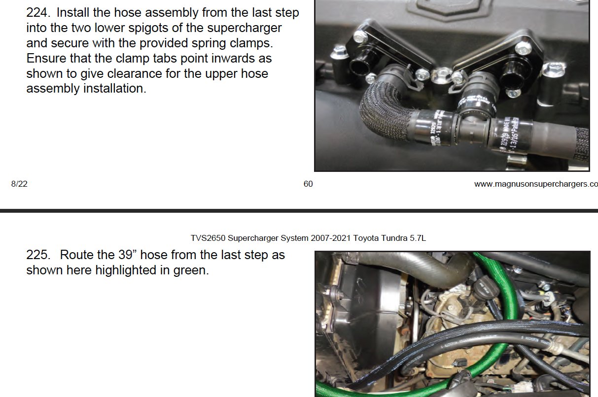

    There is only one reservoir, I asked for the install manual.

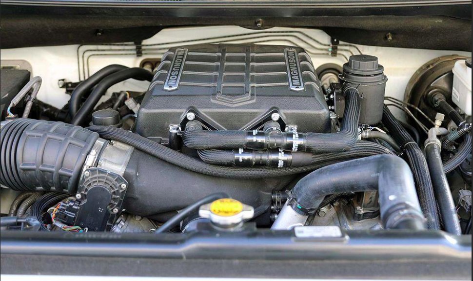

    The IC set up is just using T's from a similar setup.

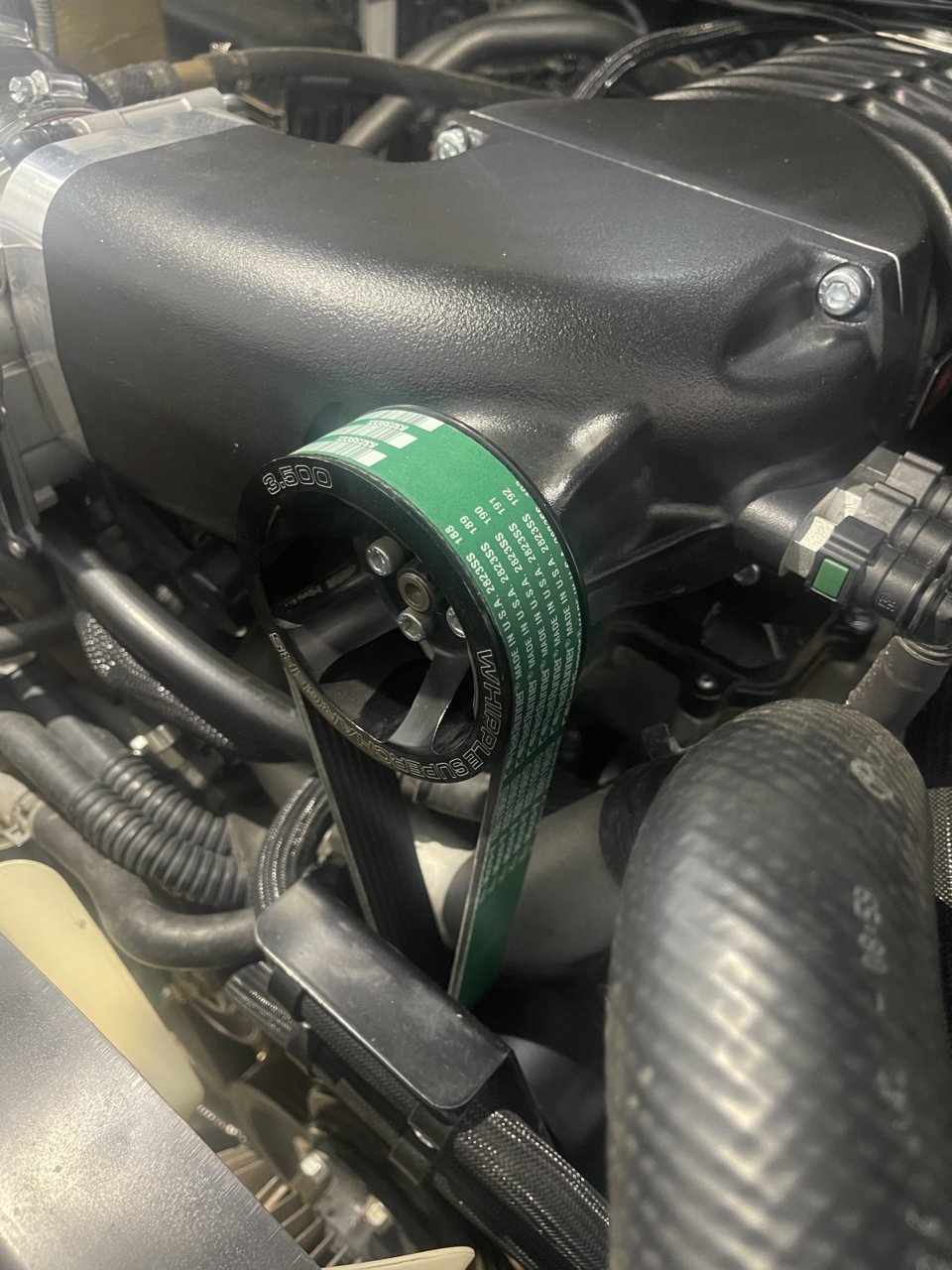

    Moved to the green hd belt. May start looking for a shorter one if possible. Lots of adjustment left on the tensioner.

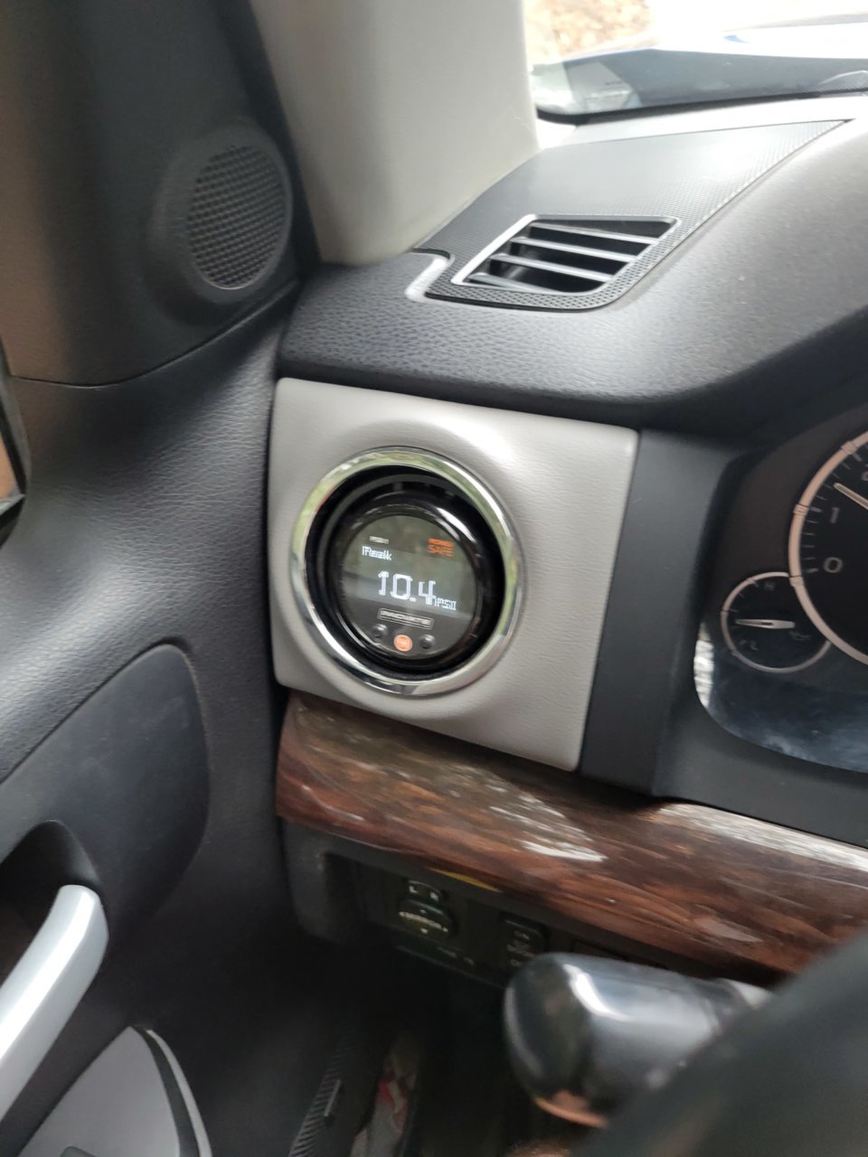

    Alright, all I have to say is sea level elevation is a literal game changer on boost and zippity freaking gone!! I consistently get over 10 psi here in CA and I have to say, my aunt's supersnake f150 doesn't feel as fast...it is, but not enough to buy IMHO.
    I was gifted a 1955 ford f100 and I'm hauling it back to the MTns so we'll see how bad my fuel mileage changes! :pI love booooooost!
