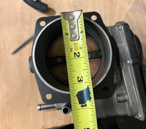

    Boosted 2013 Sequoia TRD FAUX

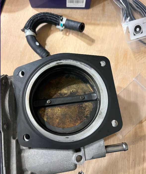

    TB going on, It is on the SC but it's 116 & 60% humidity, I was sweating so much I could not see from the sweat in my eyes, had to come inside.
    The original had the rubber ring & no gasket so I did not use anything.
    Mdl, reywcms, Silver17 and 1 other person like this.
  6. Aug 17, 2023 at 6:07 PM
    e30cabrio
    Oct 20, 2017
    #10410
    6,566
    West Valley, Phoenix, Az.
    I got the TB for under 360, the adapter was 115 I think delivered.

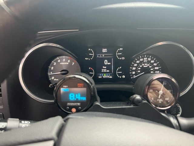

    So this happened today. Never seen double digit boost numbers. 90 degrees here.
    Harrop with 80mm pulley, SABM intake, stock exhaust.

    Did it look like mine? I don't understand how LKQ gets a new unused part but I really don't think it was ever used.
    Also, glad I took & looked at my pics, forgot to connect the maf.

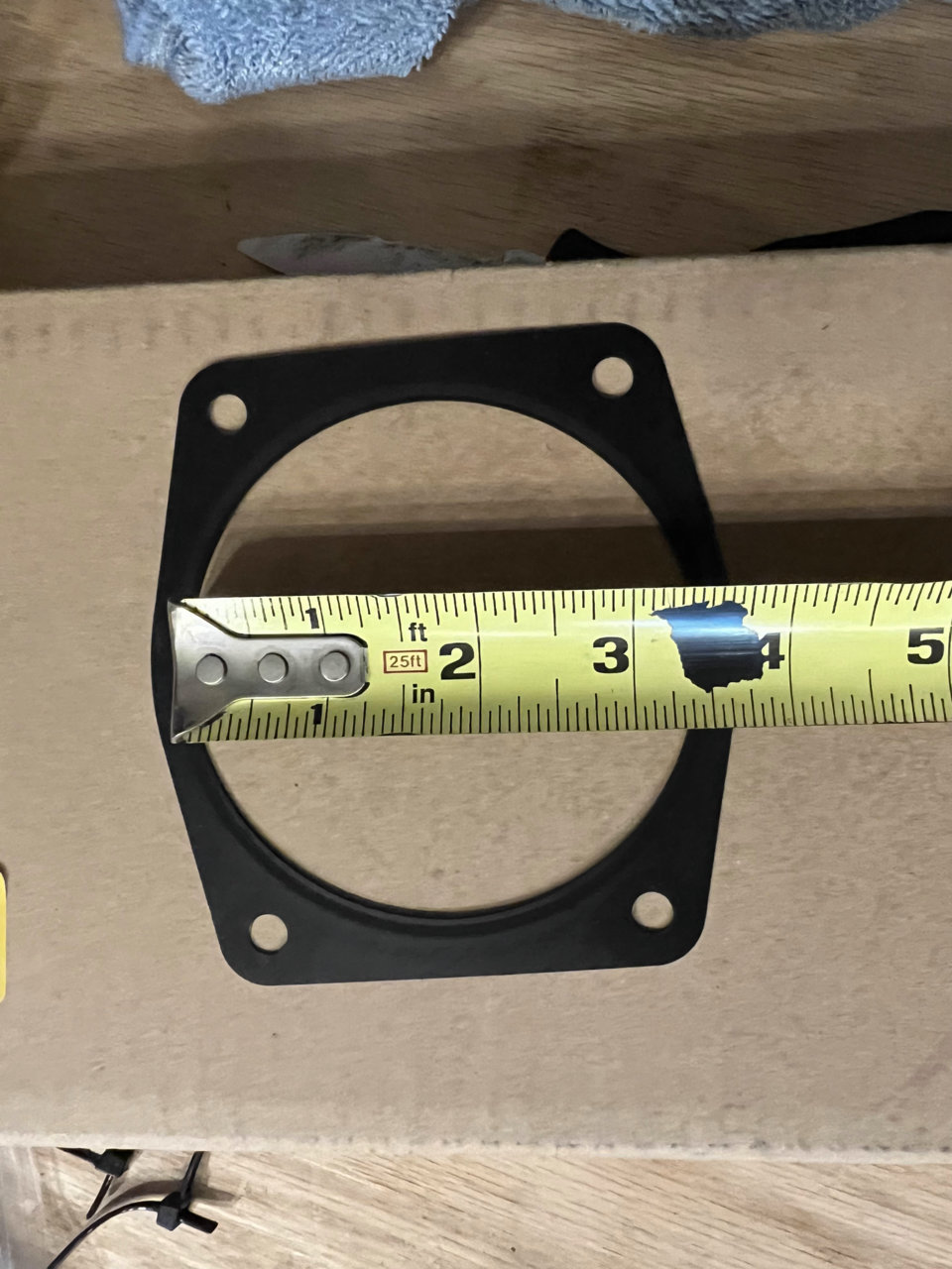

    Looks like a throttle body you should’ve measured the diameter lol. Should run fine mines untuned and drivability as far at the throttle body is the same as before with the stock unit

    I meant how it is clean, it is definitely bigger, was a massive PITA getting the intake tube on.

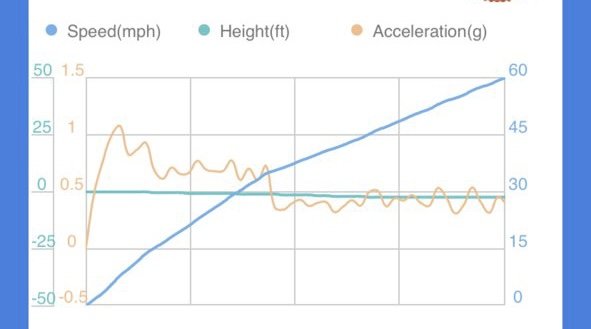

    from what we see on these pages, the 1.9L mag performs quite well...as it builds boost VERY quickly.
    The dragys prove the performance - the initial G's on the 1.9L maggies is demonstrably better than kinda-similarly equipped Harrops/2650's.
    The bell curve for S/C performance with non-built engines is very tight. dragy's prove that point.
    said another way...our ~600hp trucks perform like ~600hp trucks regardless of S/C size.

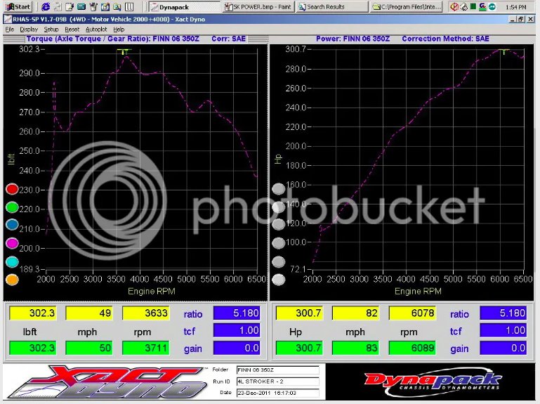

    How about 12k+ for 50 hp 70lb?
    This was my 2006 350Z
    https://my350z.com/forum/na-builds/516492-96-5-11-0-1-88mm-bc-crank-na-build.html
    My 22k engine replaced by Nissan is using 3 quarts per 1k miles.
    I am doing an NA stroker and can't wait to get it back!
    Specs are BC 88mm crank, BC rods 96.5 JE 11.0.1 pistons +1mm Manley valves and Jim Wolf S7 cams.
    I bought a sub 10k oil consumer block & heads so the build could be done and I could keep my car.
    Oh, also, it took over a year shuttling it from bad shop to worse shop to finally someone that completed it (poorly) it failed after a few k miles & I sold it for 3k & dumped an eBay motor in & dumped the car.

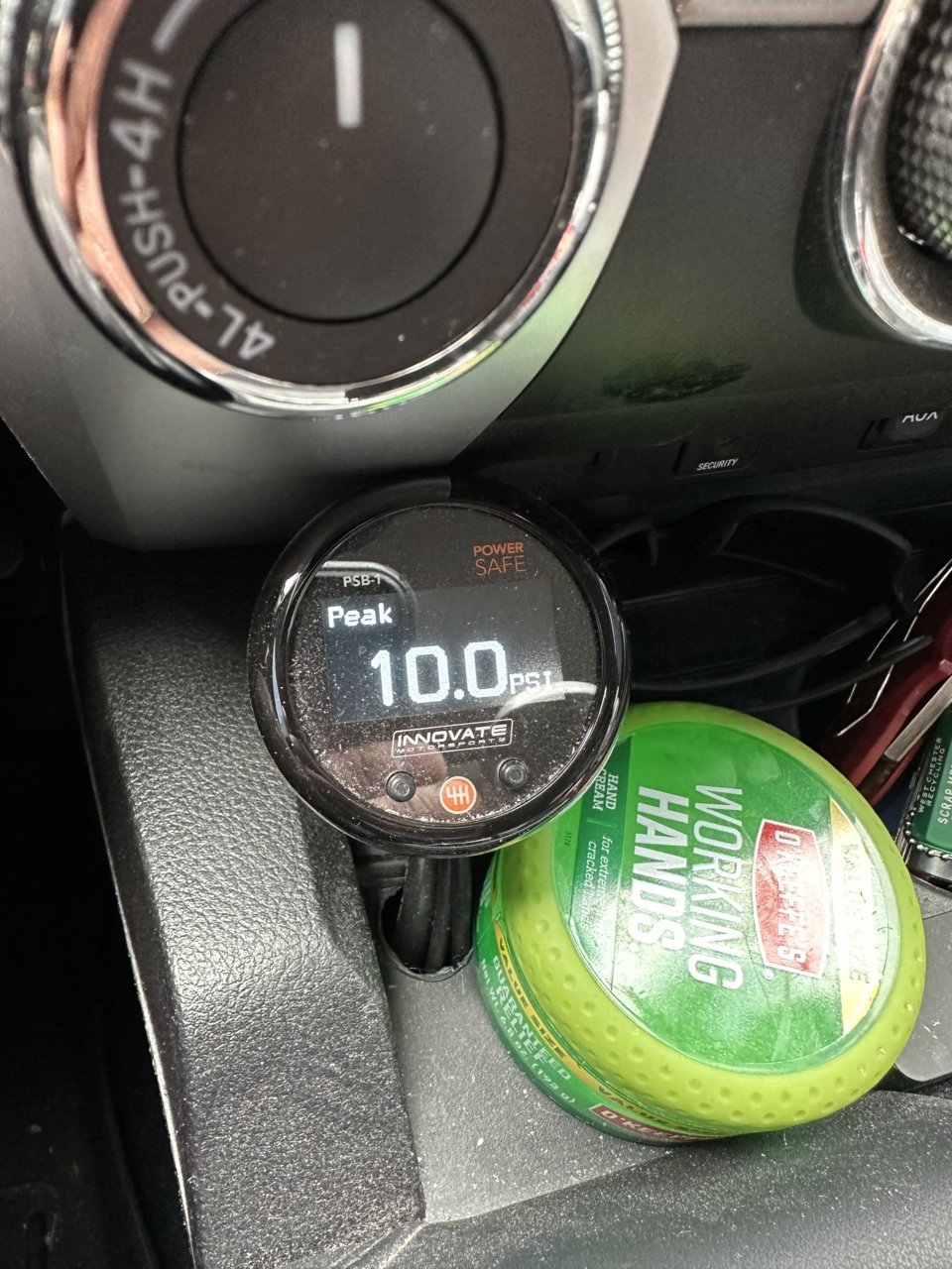

    Highest spike I’ve ever seen was 10 for a split second. Usually the peak is 8 or 9psi.

    Here is a comparison of the original TB & the RS-F

    It hits 7psi by 2700rpm, and then is 8psi by 4000rpm, and 9-10psi between 4 and 6k rpm.
