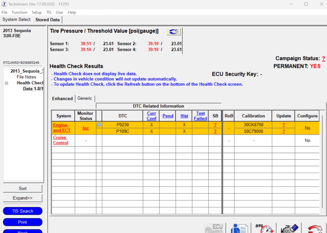

  8. Aug 17, 2023 at 8:11 AM
    e30cabrio
    Oct 20, 2017
    #10410
    6,569
    West Valley, Phoenix, Az.
    Boosted 2013 Sequoia TRD FAUX
    Figured out the ECU version, have codes my generic scanner does not see both are fuel pump/FFV switching valve.
    Now I need to figure out if version 30CK6700/ 50C79000 should have the ethanol issues.

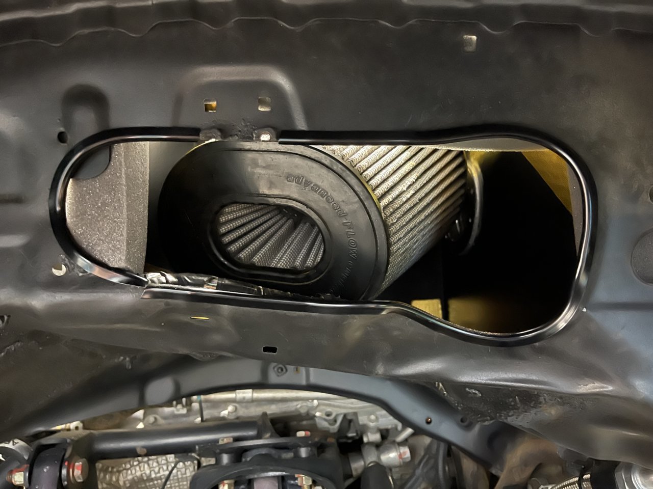

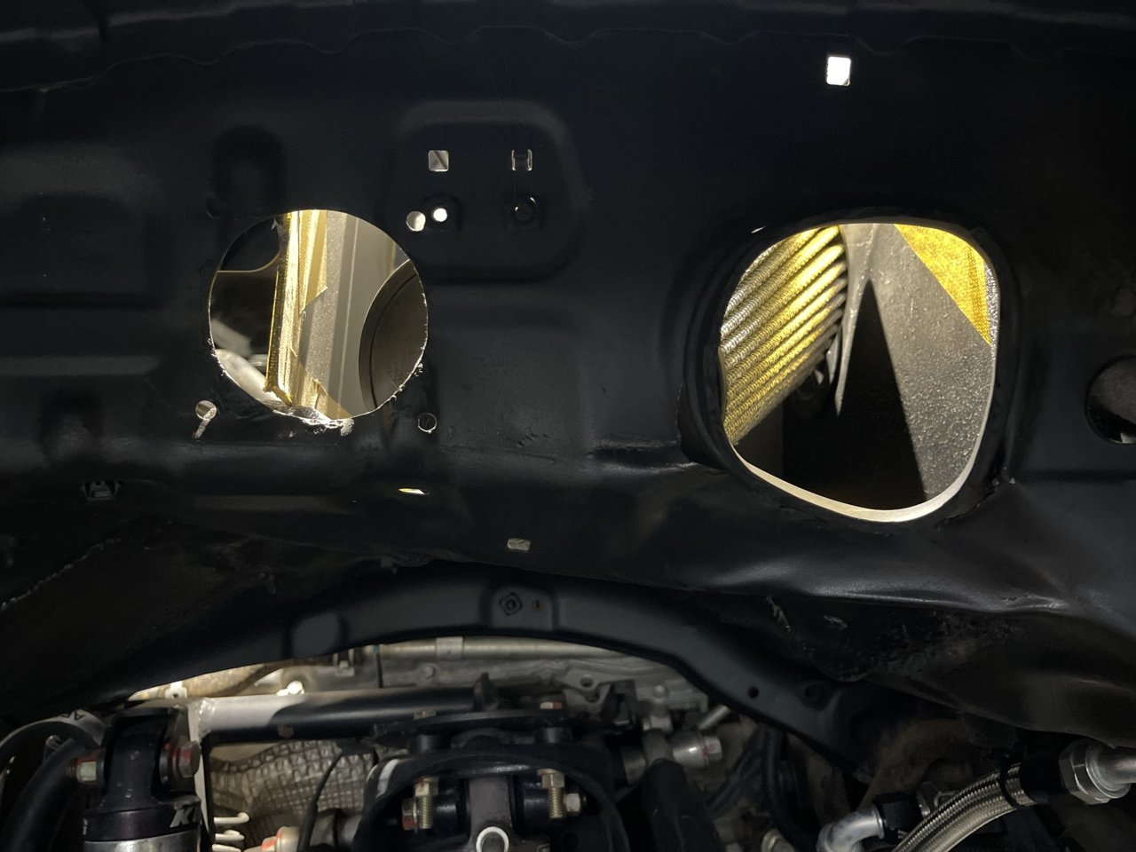

  10. Aug 17, 2023 at 9:19 AM
    reywcms
    reywcms New Member
    Dec 20, 2021
    #72040
    7,532
    Rey
    North Plains,Oregon
    2017 Tundra Platnium
    Too many mods to come
    Opened the hole up a bit and will be adding louver type thing. We will see how the louvers do during the wet season and again I can run my winterized block off plate.

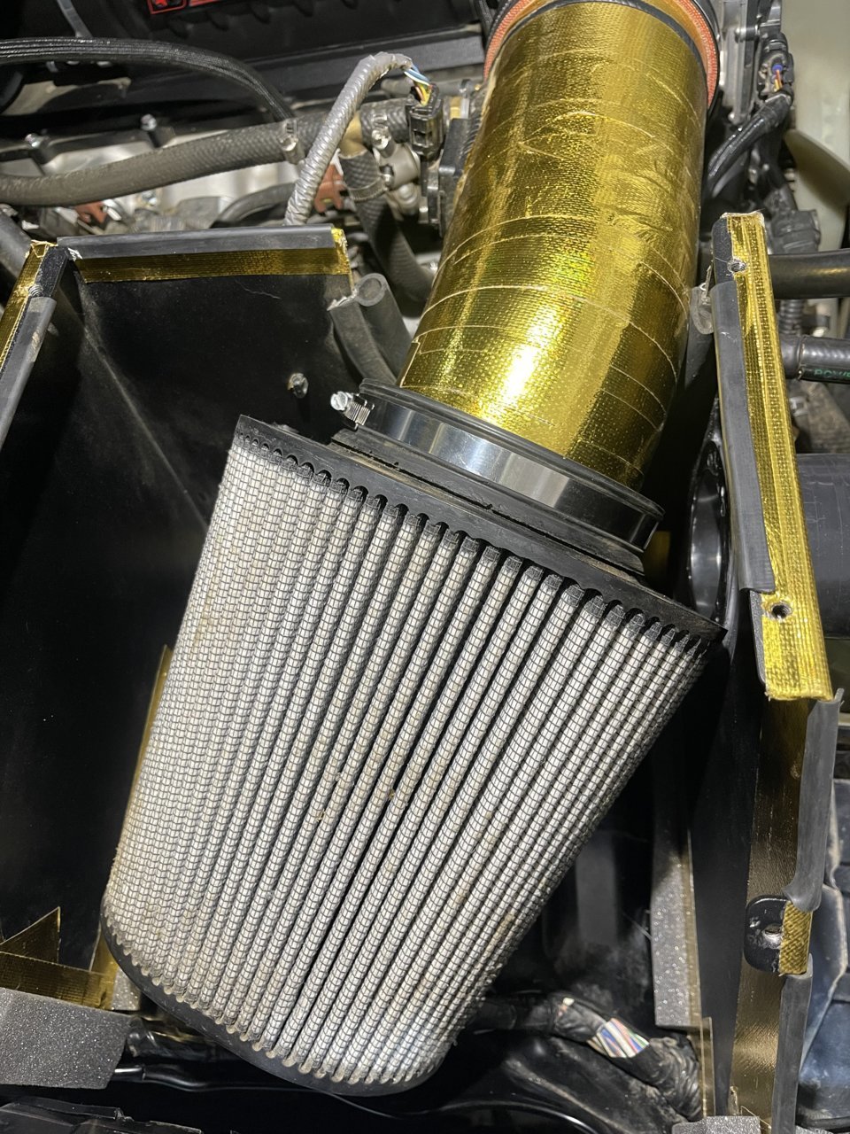

  14. Aug 17, 2023 at 11:07 AM
    reywcms
    reywcms New Member
    Dec 20, 2021
    #72040
    7,532
    Rey
    North Plains,Oregon
    Ok cleaned up the area and tried a new resealing of the box we’ll see how it does this weekend against some TRX at the dunes.

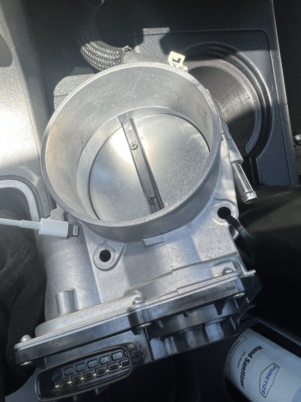

  22. Aug 17, 2023 at 12:45 PM
    e30cabrio
    Oct 20, 2017
    #10410
    6,569
    Seems new.
    Really seems unused, I see no evidence of coolant.
    Should I use the metal gasket? If so between the intake & adapter or the other side?

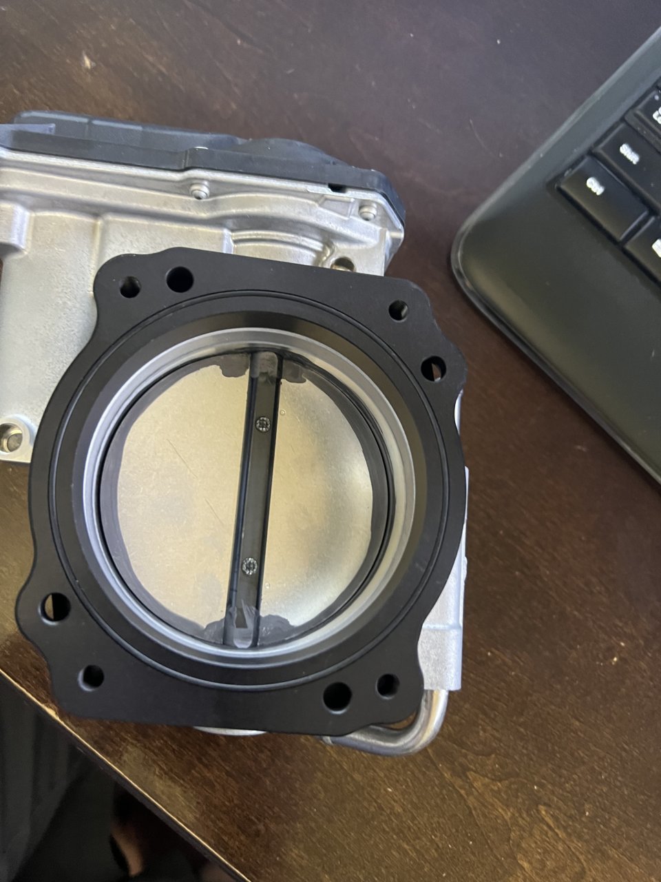

  24. Aug 17, 2023 at 2:29 PM
    e30cabrio
    Oct 20, 2017
    #10410
    6,569
  25. Aug 17, 2023 at 2:46 PM
    reywcms
    reywcms New Member
    Dec 20, 2021
    #72040
    7,532
    Rey
    North Plains,Oregon
    yessir
    e30cabrio[QUOTED] likes this.
  26. Aug 17, 2023 at 2:57 PM
    e30cabrio
    Oct 20, 2017
    #10410
    6,569
    Yup, when it goes in it will get the caps, Where should I use the metal gasket it came with? At the SC or the TB side of the adapter?
    Do I use the black Toyota liquid gasket maker? Really want to do this once.
  27. Aug 17, 2023 at 5:00 PM
    reywcms
    reywcms New Member
    Dec 20, 2021
    #72040
    7,532
    Rey
    North Plains,Oregon
    I can't remember if the prospeed spacer has an o-ring?
  28. Aug 17, 2023 at 5:07 PM
    e30cabrio
    Oct 20, 2017
    #10410
    6,569
    Yes, there are rubber rings on both sides.
