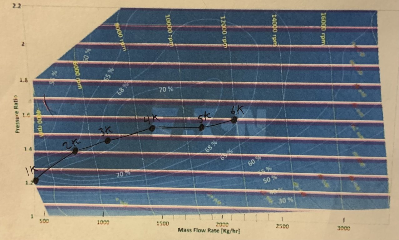

    I was bored and curious…With a lot of annoying math conversions, and figuring out pressure ratio at each 1k engine rpm interval from 1-6k by watching a replay of my boost gauge to redline I was able to plot my efficiency curve on the 2650 compressor map on the 80mm pulley. It may be a little muddy at the 1k rpm area as I guessed 3psi at that range to calculate pressure ratio (didn’t have a true reading). It’s hard to read, so cliff notes for efficiency for each engine rpm is:
    1k - 65%
    2k - 66%
    3k - 69%
    4K - 70%
    5k - 70%
    6k - 69%
    Considering the peak efficiency island is 70%, I won’t complain about that! It’s right in there for a lot of the rev range. If anyone else would like theirs plotted I can probably do it if you have your pulley size and know your boost reading at each 1k rpm interval. It’s nerdy, but cool!
