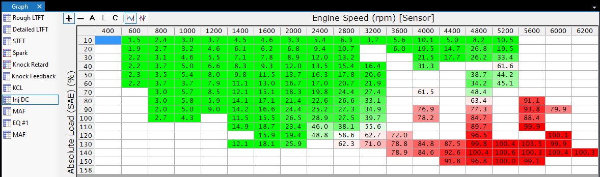

    Whats your afr's at WOT? I believe it was @snivilous that showed tables

  22. Aug 2, 2023 at 7:18 AM
    #9802
    snivilous
    snivilous [OP] snivspeedshop.com
    Apr 16, 2019
    #29192
    4,873
    SW UT
    300k+ Supercharged 2008
    @ZPhilip was the datalog where it was running out of injector, and I believe he has the 85mm pulley? I can't find where he says what size pulley he had, but on stock injectors he was maxing out duty cycle by 4800rpm.

    hi 10’s. On my recent dyno tuning
    I don’t do WOT in real life
    maf was maxed. 650 Injectors at 90%

    This is incorrect, you must be thinking of the stock injectors (the Harrop kit doesn’t include injectors). The included pump is plenty up to the task even with the 80mm. Prospeed will tell you otherwise though and sell you a lot of BS you don’t need.
