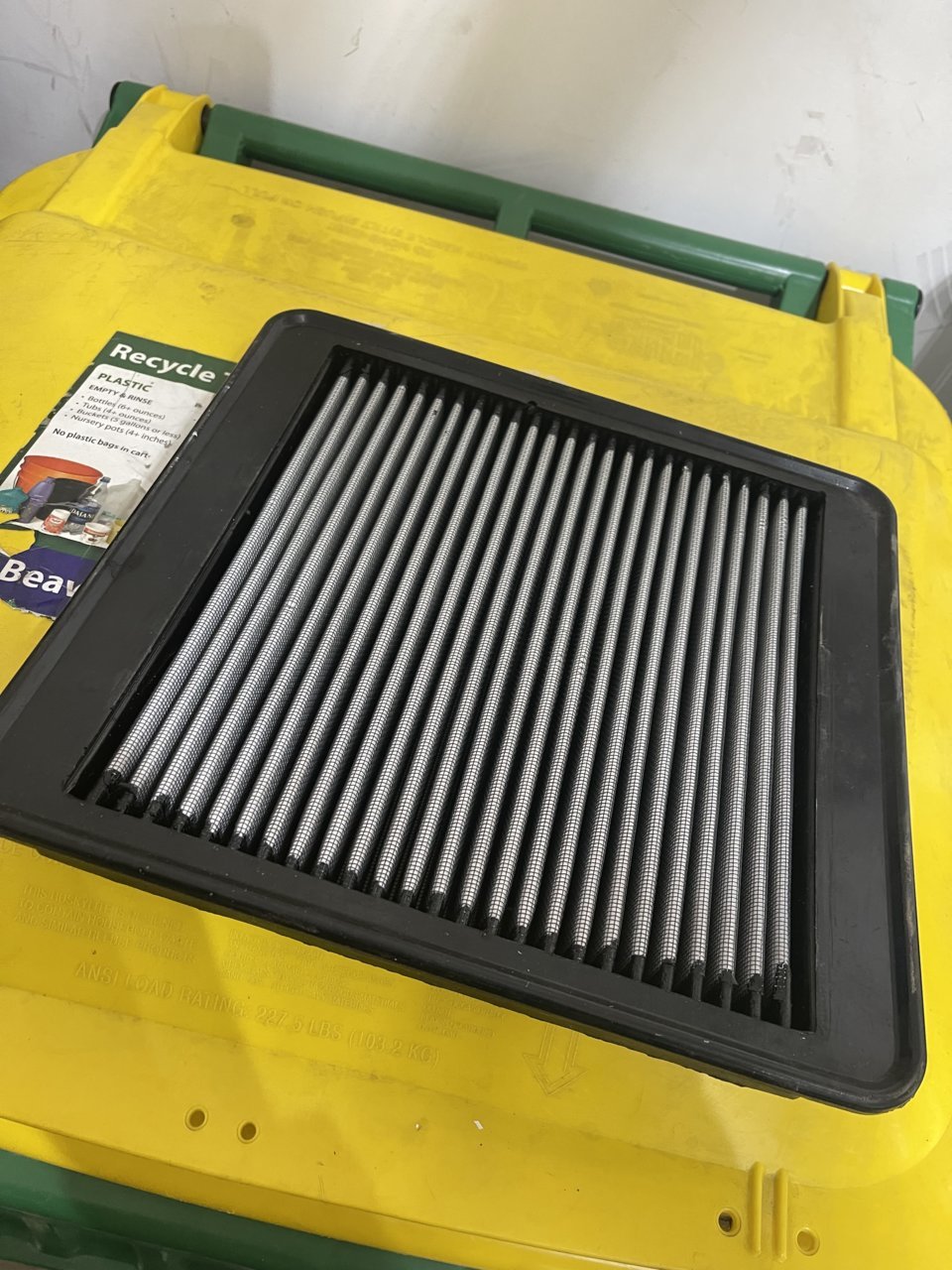

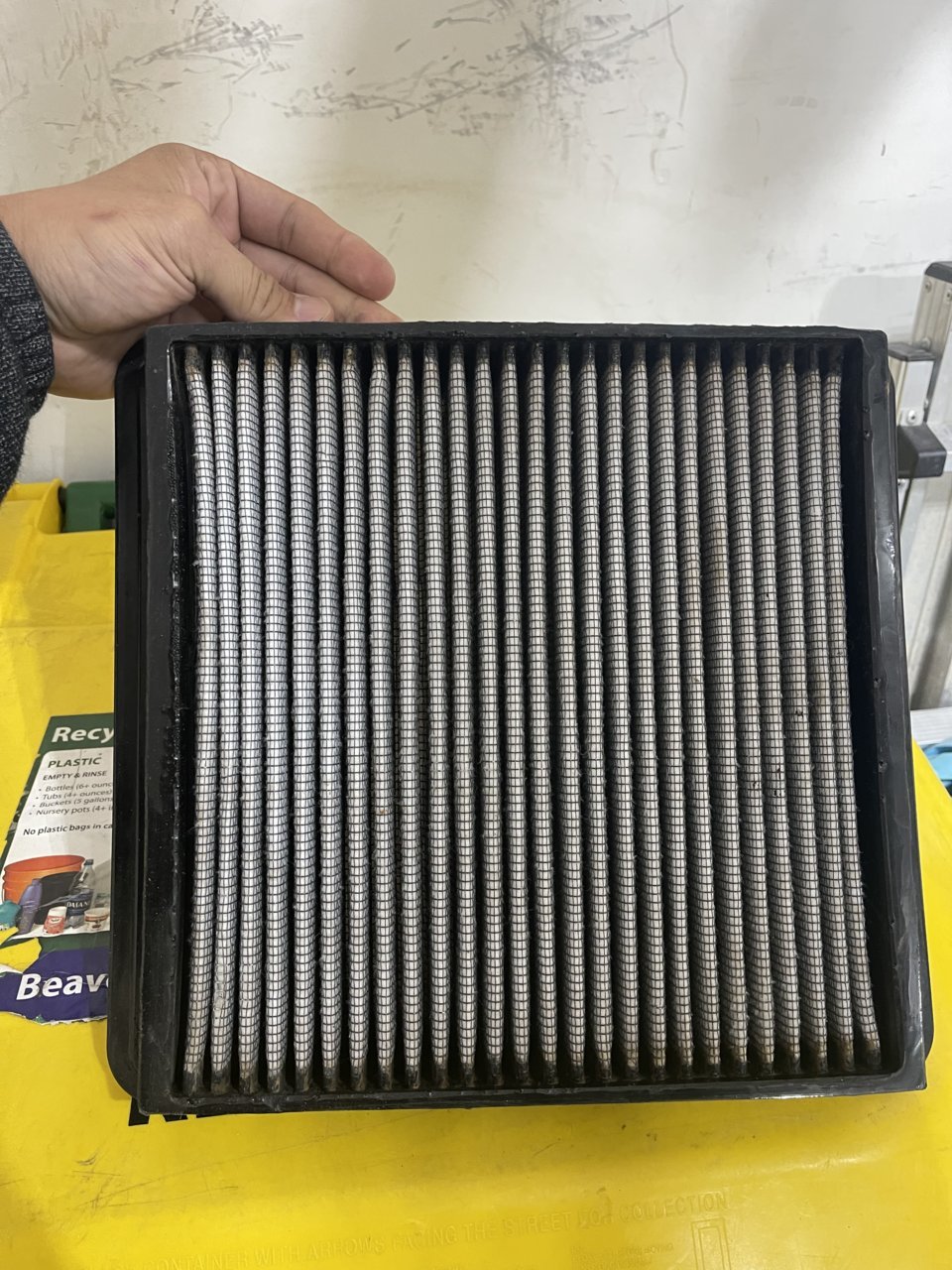

    Anyone with a maggy box need an AFE dry? Not using it.

    Is it the same as the SCOL one?

    I believe so.

    That is what I have, one is good, 2 has to be better no? lol
    How much do you need for it?

    I used two one for in the truck then back up for when I cleaned the other. Just cover shipping and it's yours. Pm me your info again!
