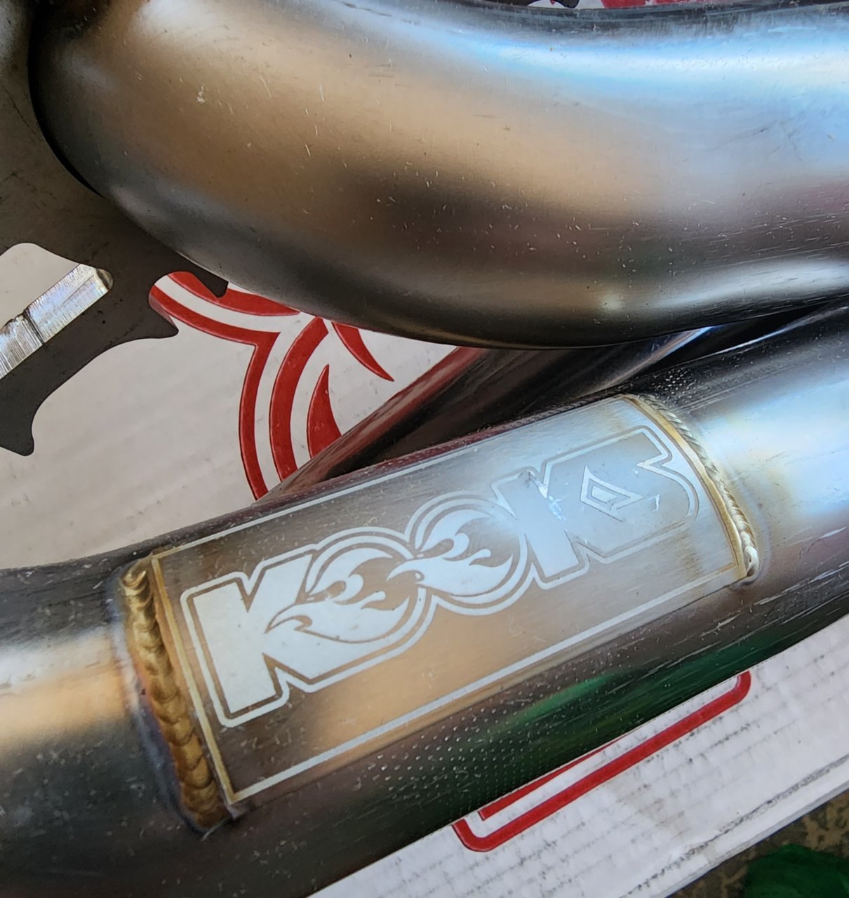

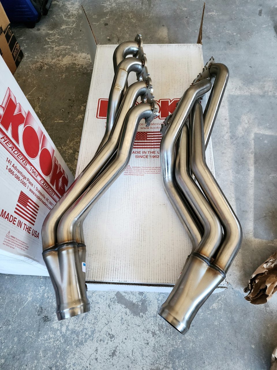

  15. Jul 23, 2023 at 1:21 PM
    #9675
    V10Ace
    V10Ace New Member
    Jul 6, 2018
    #16793
    559
    Salem, Oregon
    '21 TRD PRO
    Harrop w/ Prospeed goods & Kooks LTs
    Quality stuff

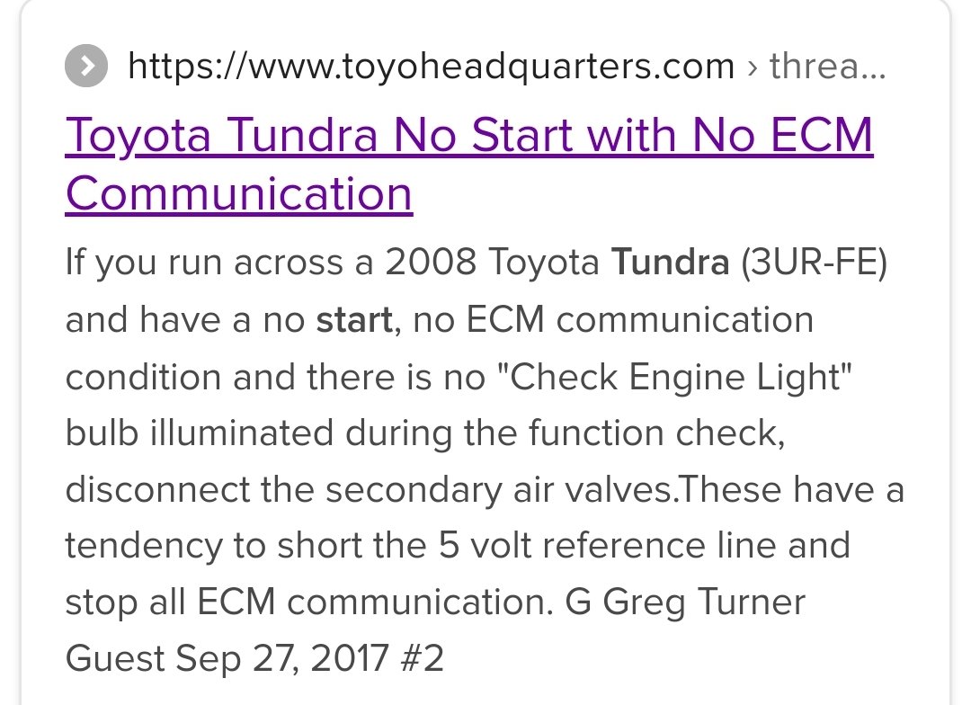

    Hey,
    I just wanted to put this out there for anyone who may have this issue.
    I thought I bricked my ecu. I had no power, communication, with obd port to ecu and no codes all fuses good. I bought a ecu and still no luck. I stumbled upon a video and post concerning the 5 volt constant for the ecu. It was my aip pump connection.
    Thanks @Fastlane47 and @snivilous for the help and suggestions. Now I need to get some data logging done.
