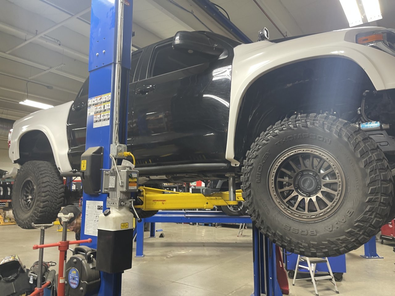

    Cutting the secondary cats friday. Curious to see the difference.

    Compare your boost psi and see if there is a loss. If I recall you should not lose low end torque and may increase a little further up on the rpm's. The stock pipe size should maintain velocity and not be affected by the 2nd cat.

    This is exactly my thought on what will happen.

    Friday came early lol

    Hot as hell here today and not long of a drive. Afr dropped a point richer. Sounds very rowdy when on it. Idle revving is also very different much smoother. Going for a longer coffee run in the am and will report more findings

    Been wanting to do this one day mainly for sound. I think the richer AFR is interesting, what would explain that? I would have thought there would be higher flow and therefore be leaner, but must be thinking about it wrong. Looking forward to hearing more about it.

    I was curious about this also. I noticed a difference when I had the muffler delete same afr. Then when I added the carvens it bumped up a little leaner but more boost. Now here less boost (higher flow I imagine) then back to richer. The sound is a great it’s a good between from mufflers and no mufflers. I may pull the negative cable and let the computer reset let it sort this new thing out and see.

    I had my secondary cats removed for a while. At idle and cruise its only a very mild difference. At wot it sounds mean! You will be happy i guarantee it! Edit: i didnt realize you already removed them. But i loved how it sounded without them. It might scare you the first time it hits the rev limiter because it makes a pretty damn loud pop!

    Morning coffee run findings. Confirmed afr is much tighter meaning less back and forth/ tighter spread at idle and driving. .2lbs less boost so now spiking at 9psi before settling down to 8.0-8.1.
    Sounds awesome while on it. It's a good in between from the muffler delete being too loud to adding mufflers being too quiet.
