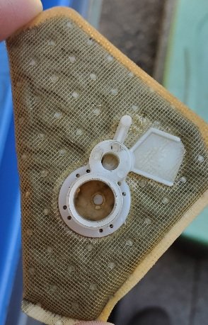

    Those that used the ti450 did you use the pre filter? I called and looked online for the ffv pump filter. Parts dept said they don't sell it only replace the whole pump and canister assembly. I laughed and said a $5 filter vs $3-400 for assembly.20230714_115813.jpg
    But guess makes sense as your dropping the tank and pulling the pump. I did install a 30 micron filter after the tank, will get a 10 when I do the injectors.

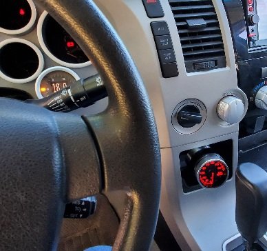

    Thanks @snivilous for the idea. Just. Used some arcylic I had and angled trim piece for the gauge. Thought of swapping the failsafe and fuel psi positions but don't feel like getting all pretzeled.20230714_135652.jpgit's a cheapo psi gauge but reads what the regulator is set at.
    I have pics set at small size and thumbnail.

    Yes, I used the pre-filter, it helps to protect the pump...Summit sells replacement filters, so do lots of other places, 11mm for the 450 inlet.

    I used a universal filter sock bought at O'Reilly

    Same here, I got the summit 450ti install kit that came with a new filter and few other items, I remember it being relatively inexpensive. It does not fit in the nonflex basket all that well.

    Thanks for the replies. I found a half circle one rated at 30 micron that should fit without being stuffed in. The one from the ti kit was kinda too crammed for my liking.

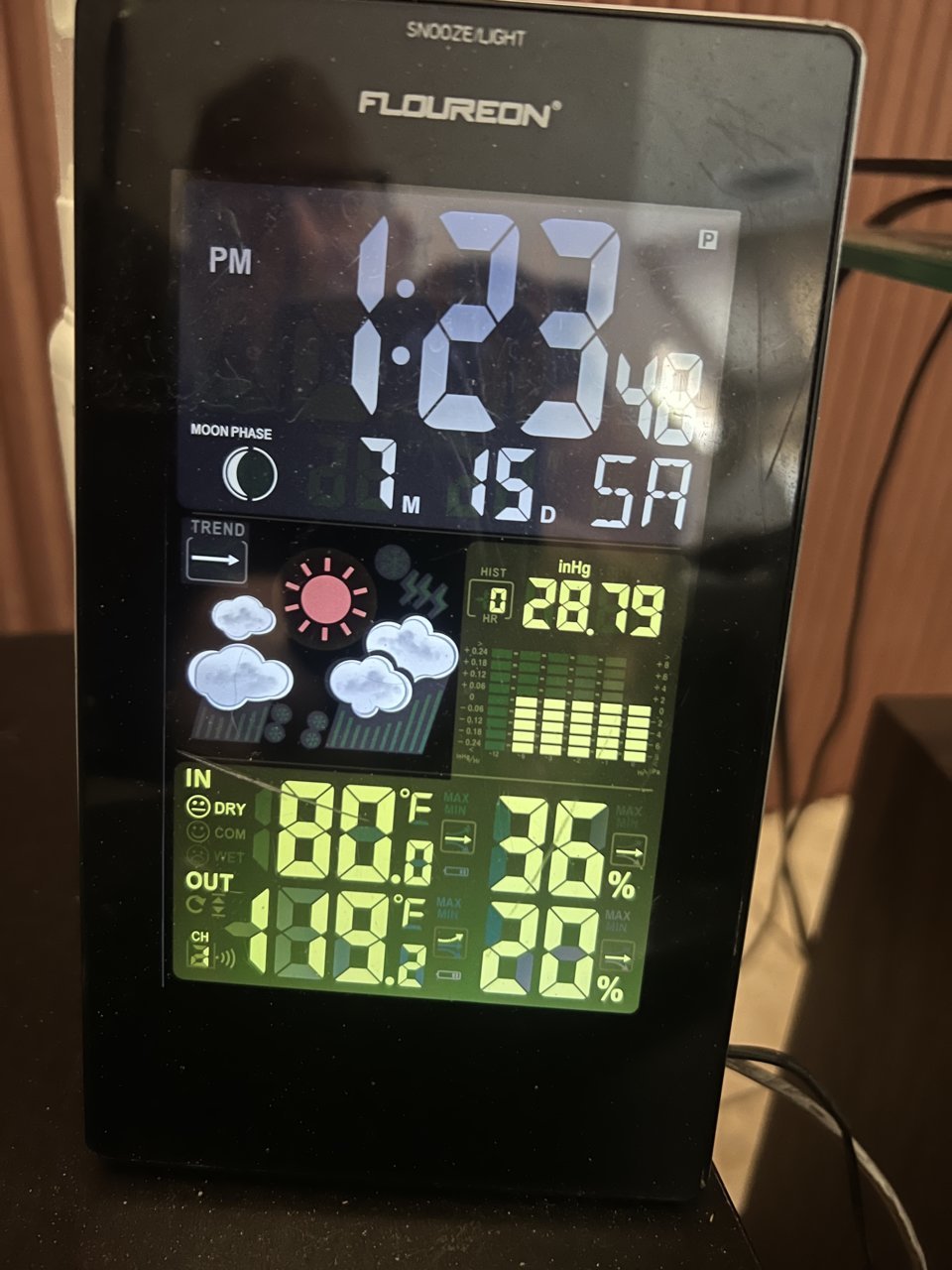

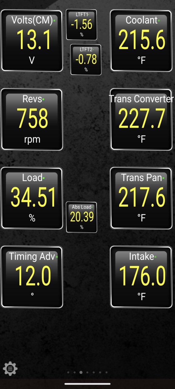

    Drive through test when it's 110+ out. Having a cool intake when you're doing 80 on the interstate is great but what about when it's hot as balls out and you're parked in line for 20 minutes?

    Looks like you need to upgrade to my 20-row Setrab!
