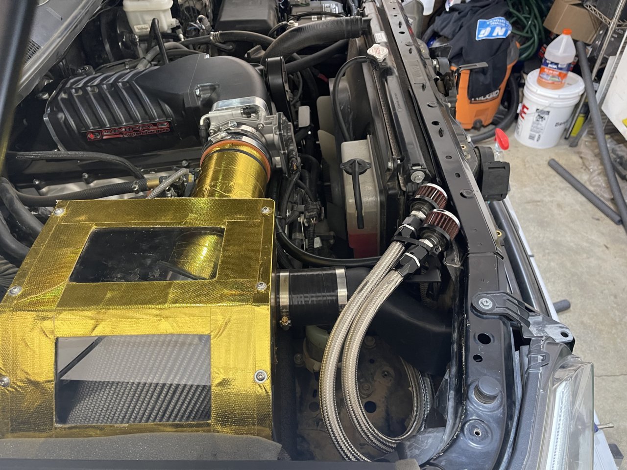

    That looks really good man, I might have missed it, but did you ever log how much the gooooold reduced temps?

    I would say it attributed to getting into the 30* delta and heatsoak prevention. It definitely delayed the heatsoaking.

    Cool, I've got a few sheets and a big roll to start wrapping when I get my sniv adapter and do the install. Right now I'm seeing about 21-25 over ambient while driving, so will see what the wrap does before moving forward with my interchiller install.

    I'm keeping an eye on all this...I avg 27 degree delta. (harrop sensor)
    I would think ~25degree delta would be the plausible limit to cooling.
    When cruising down the hwy @ 62mph...90 miles...I will usually see 23degree delta. ideal conditions...which means that's just the blower and or IC coolant(heatsoak) adding heat. lowering that number would take the killer chiller thing...but that is only temporary.
    I like the @reywcms front intake thing a ma jig.

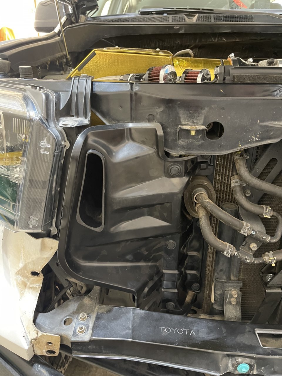

    Pretty significant temp changes. The stock unsealed PS had me at 50+ until I switched to Frankenstillen.

    Did you enlarge the hole in the fender?

    Yes but I didn't do a SABM to cut a second hole which I've seen recommended. I also didn't want to spend the time sealing up the box since it was pulling hot air from the bay on both the intake and fender side.
    The Stillen basically adds a SABM without cutting.

    This is what ProSpeed recommended to keep temps down with their intake:

    Yep I've the SABM hole as well from before. I also used my TRD accelerator just spun it around so it doesn't fall out. I'll send pics after my next meeting

    Thanks for the heads up on what the proper PS install looks like. Even with the enlarged opening the PS box will pull in hot air from the bay unless you seal it.
    That's a big nope from me. No restriction at my power level with my Frankenstillen. If I go for bigger numbers I'll consider a SABM before cutting up my fender like that.
