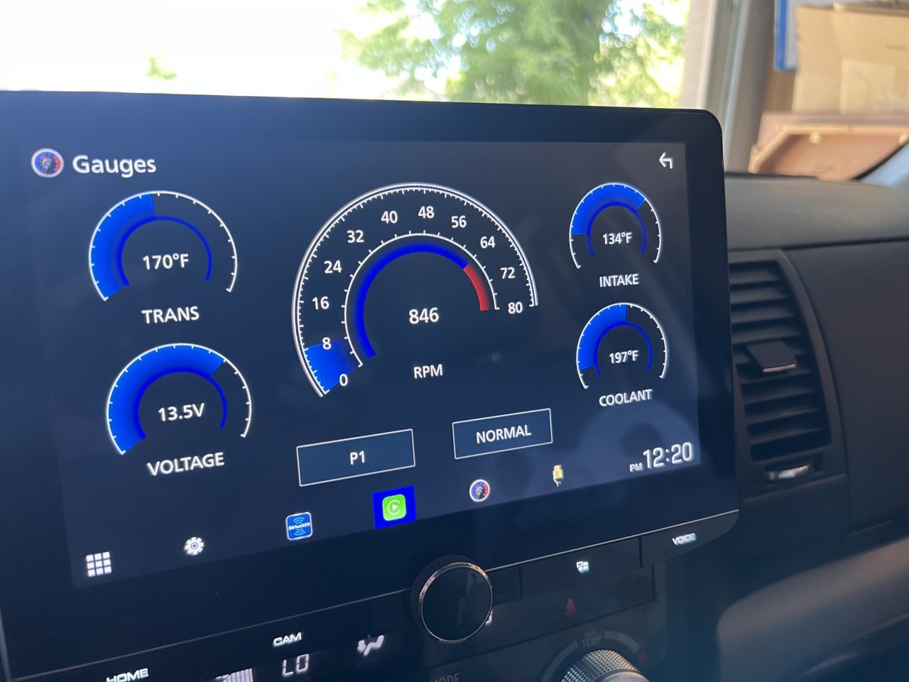

    what headunit is that? I use Joying Auto and LOVE them. This looks like a more name brand unit, though.

    Tastefully enhanced...
    Pioneer NEX 8200

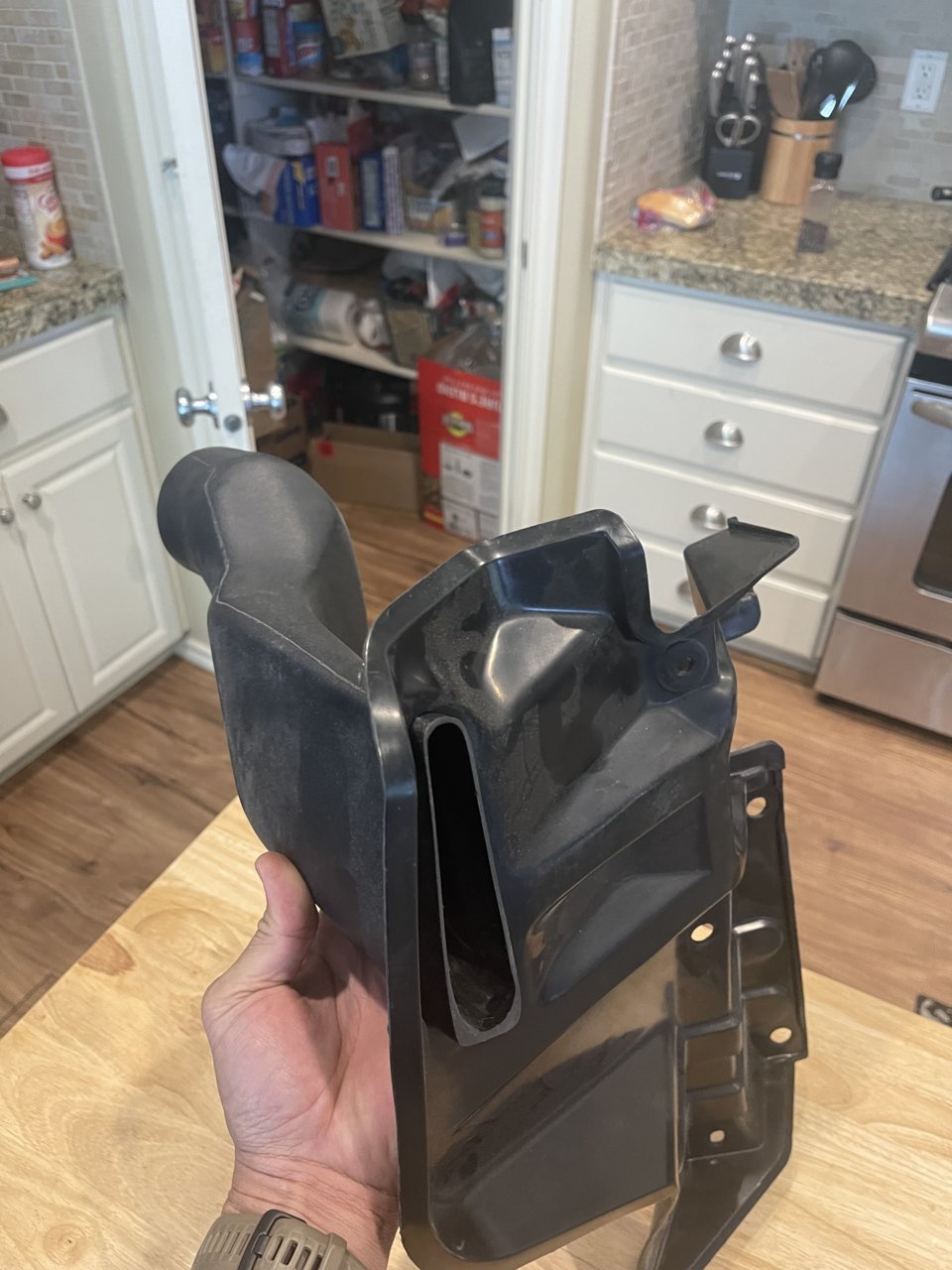

    Excited to see the results when I get this in.

    I think I've seen more pictures of your kitchen than I have of your truck...

    It’s a nice place, but I have to say I really was expecting gold countertops.

    Am I the only one that has no idea wtf that is? You could've picked that up on the side of the road for all I know :rofl:

    How did you get it on it's own? How much is it?

    On the stillen box yes, still pulls from the fender area as well. The tube i got is still 3”.

    Stillen will sell it on its own you just need to contact them. I was in communication with them but just before I ordered @M3Tundra-JK said he had the parts laying around. Not sure how much stillen would sell it for separately.

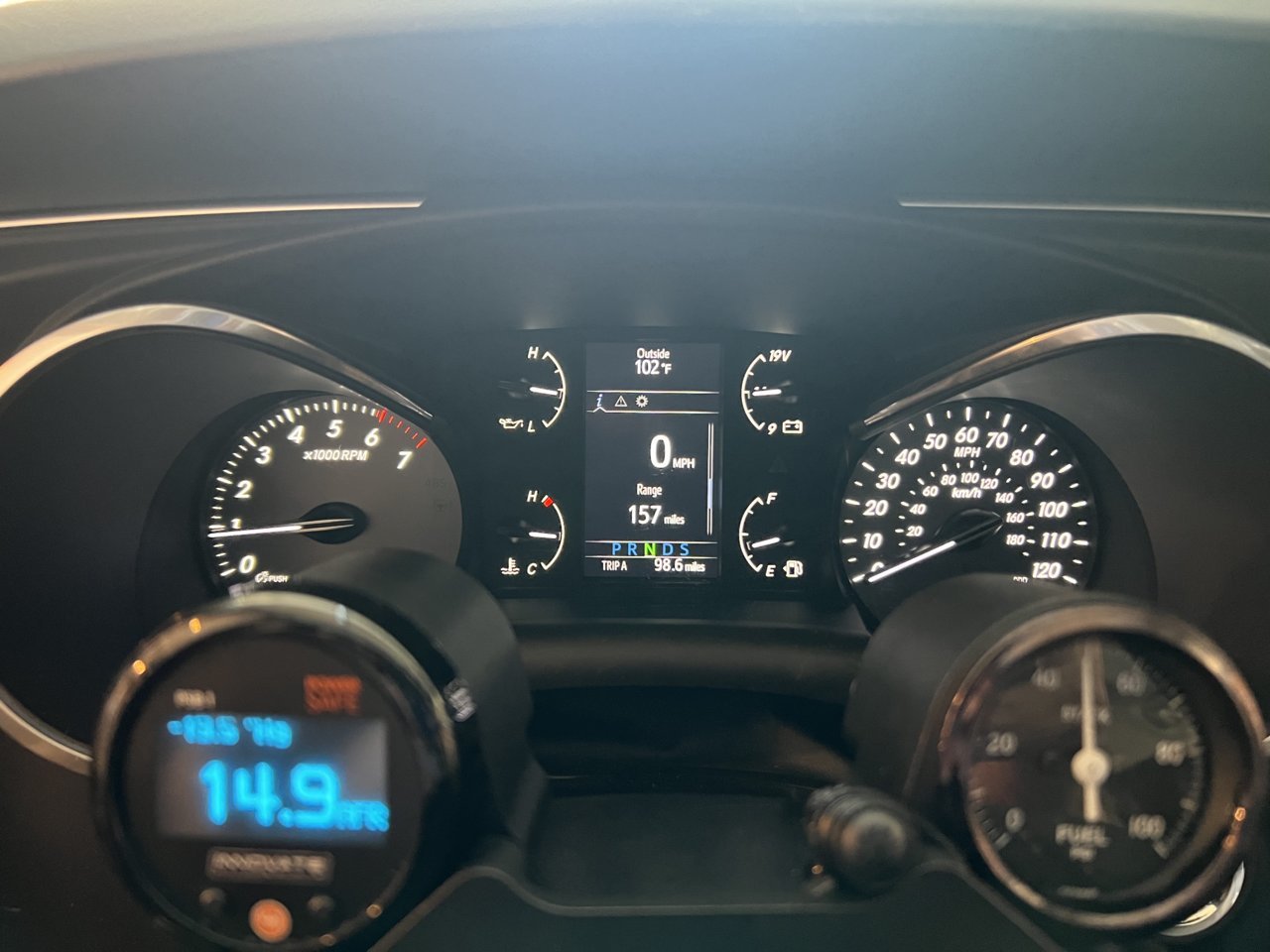

    Ok installed the washer tank relocation and the stillen tube. Some may recall the prospeed box was always at least 60+ above ambient. After sealing it off I was locked at 30 above ambient.
    Now with the stillen pipe 10-15 above ambient. In traffic less heatsoak and within 4 blocks down to 10-15 above ambient. Pretty happy with that. Did a few pulls and temp didn’t move while on the freeway. Boost held solid at 8.2 lbs. Note that this won’t work with the radium catch can single mount so need to move to the double mount.

    That's a pretty serious drop in temps from the original state of the box!
