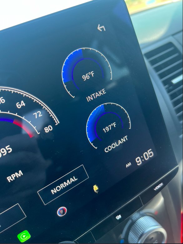

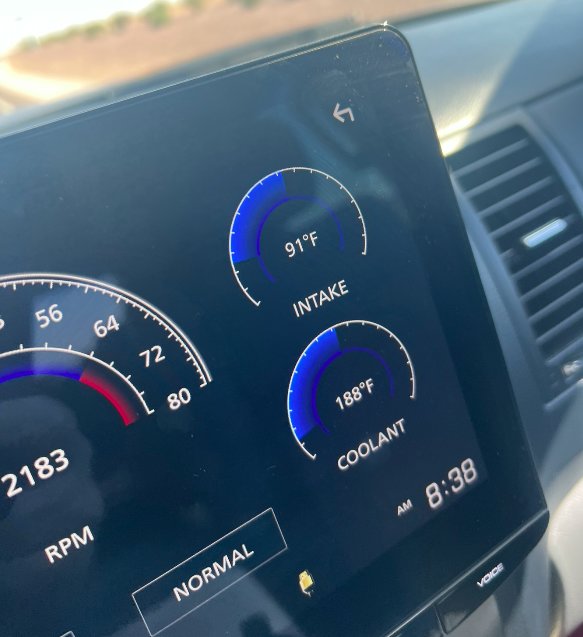

    Just took a drive, 20 minutes back & forth on the freeway.
    1)instant boost. Truck just takes off, immeadiately it's at 8.8 which seems to be as high as it is going now.
    2)no noticeable fluctuation in cruise driving & the IAT seems the same.
    3)AFR seemed slightly lower at WOT (10.0 from 10.5)
    The first ambient/IAT is just on the freeway, second after about 10 minutes on the freeway.
    I like it so far.

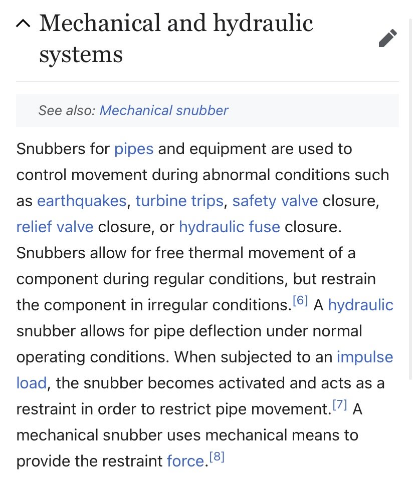

    I believe the correct name for the brass fitting is a snubber. I’ve seen them before in hydronic systems to prevent gauge damage from rapid pressure fluctuations.

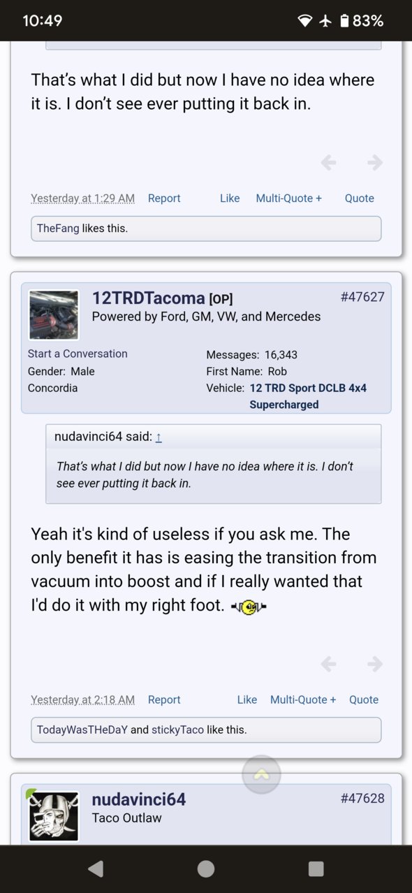

    Here's the Taco S/C thread OP's opinion on the bypass valve restrictor jet being removed and any throttle surge lol
    e30cabrio and Saltyhero13 like this.
