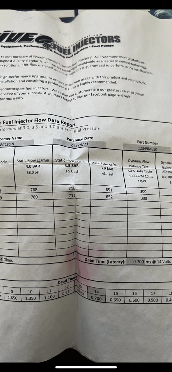

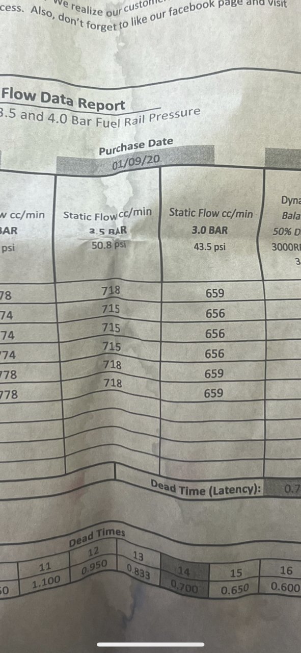

    Yes 5-O 650s but they are running at 50lbs which makes them higher. (I think 700)
    Found the sheet, 710-718 at 50lbs

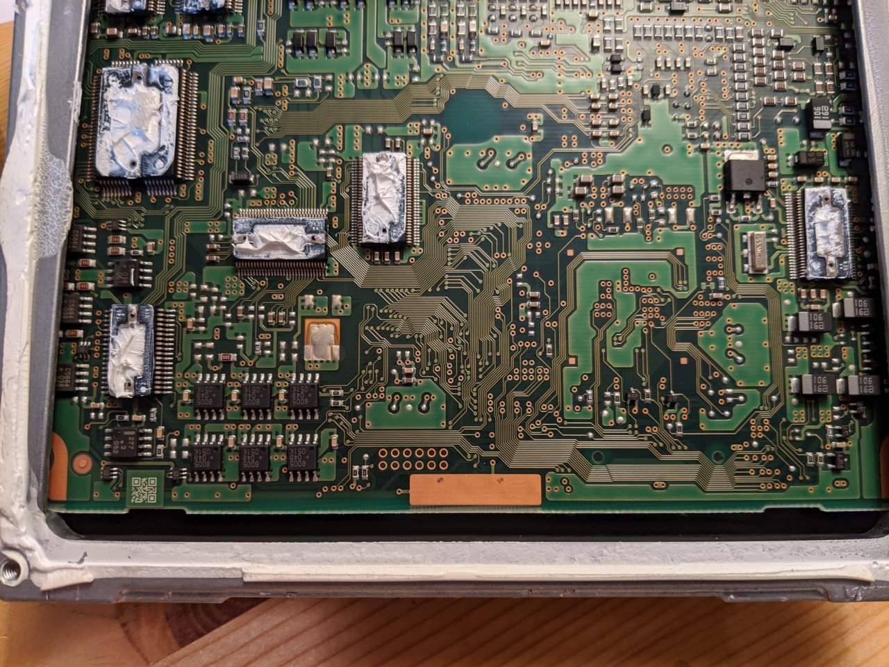

    Well, the truck is running. The PCM did fail, and when I bricked it, it took out a fuse link under the hood. With the new PCM in its running. I will upload a tune Monday and take her home. Thank you guys for all of the help.

    Wow, what was the value of that link? Had your ECU ever been opened up before? I just can't imagine what could've shorted in it to burn a fusible link. I've had mine open before and it's full of what I'd consider very low current capable components; surface mount stuff. :bananadead:
