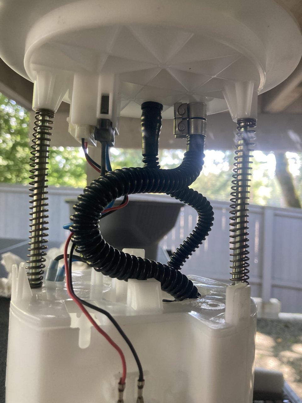

    I'm installing new supply/return fuel lines. Those that put in new fuel lines did you remove the factory or leave in place?

    I removed the stock hard lines and ran the new lines through the same brackets, zip-tied to the brackets.

    I removed all the lines from the engine, but I was also in the middle of the s/c install so that was easy. Left the hardlines, removed the ones on top of gas tank

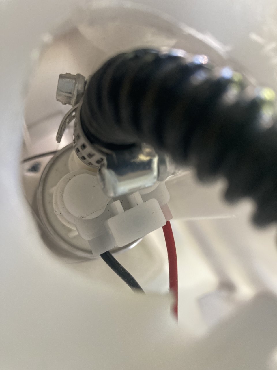

    Update, dropped the tank a second time. Put on a 5/16 hose instead of 3/8. Used a heat gun to warm up the ends to slip over the Walbro which is meant for a 3/8. Then used the heat gun to slip over the OEM 5/16 outlet. Then applied two hose clamps on both ends covering the meat of the barbs. Only been a day but start ups after several hours sitting are back to normal which is great, hopefully stays that way!

    @Ponderosa_Pine are you using a unmodified canister. No holes and factory venturi? Been researching the 450. I've ran a few different pumps over the years and have a 325lph from fiveO. Slowly upgrading...

    I’ve got the 450 rubber lines, and drilled out holes in the canister. No issues

    Similar to reywcms I removed the guts of the canister (2021 not flex fuel version) and then added holes (since no venturi, the inlet becomes very small). Tbd on how this impacts low fuel performance (driving around "normal" at 1/4 tank was okay so far). I manually drained the tank so saw that the tank does have a low spot where the pump is, but an incline/acceleration would put alot of the gas at the rear. The process I did was similar to Prospeeds write up here (and URD has the Tacoma writeup version too). Essentially the issue with the walbro pumps is that they have a fat bottom and won't fit into the OEM filter donut in the basket, whereas the five-0 and aeromotive/etc. will still, which honestly makes things so much simpler now that I have seen how theses work in person. Unless there is a very compelling reason to go to Walbro sticking with a smaller lph unit will save alot of headache. The other con of running a walbro is that we're removing the main OEM fuel filter. I am guessing its a 10 micron filter, whereas the inlet sock on the pump is likely a 100 micron. Thus if you install a walbro you really need to add back a 10 micron filter somewhere in the fuel system after the pump. I am going to add a deatschwerks 110 fuel filter for that reason. The new 750cc injectors I got even clearly said to install a after pump filter (which makes sense).
