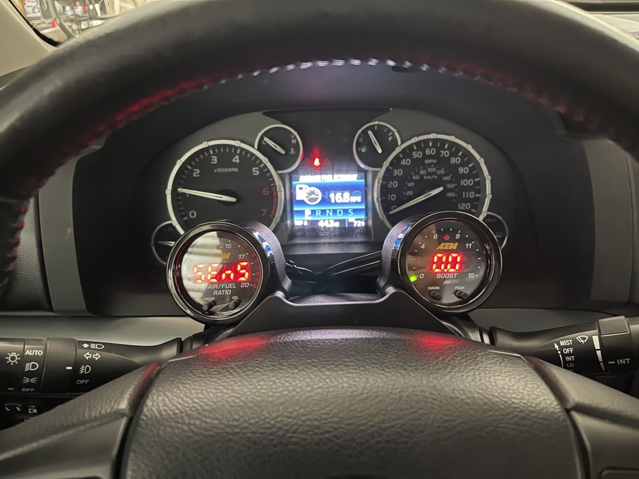

    You have a link for that? Might have get another gauge for that
