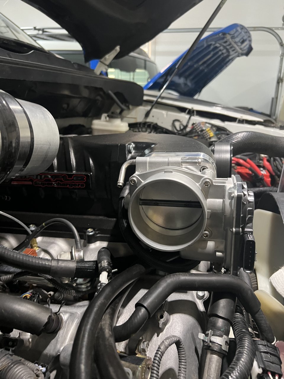

    Fingers crossed the harness works out. If so I'll have an RCF throttle body for sale with light use lol 103mm Nick Williams in the future

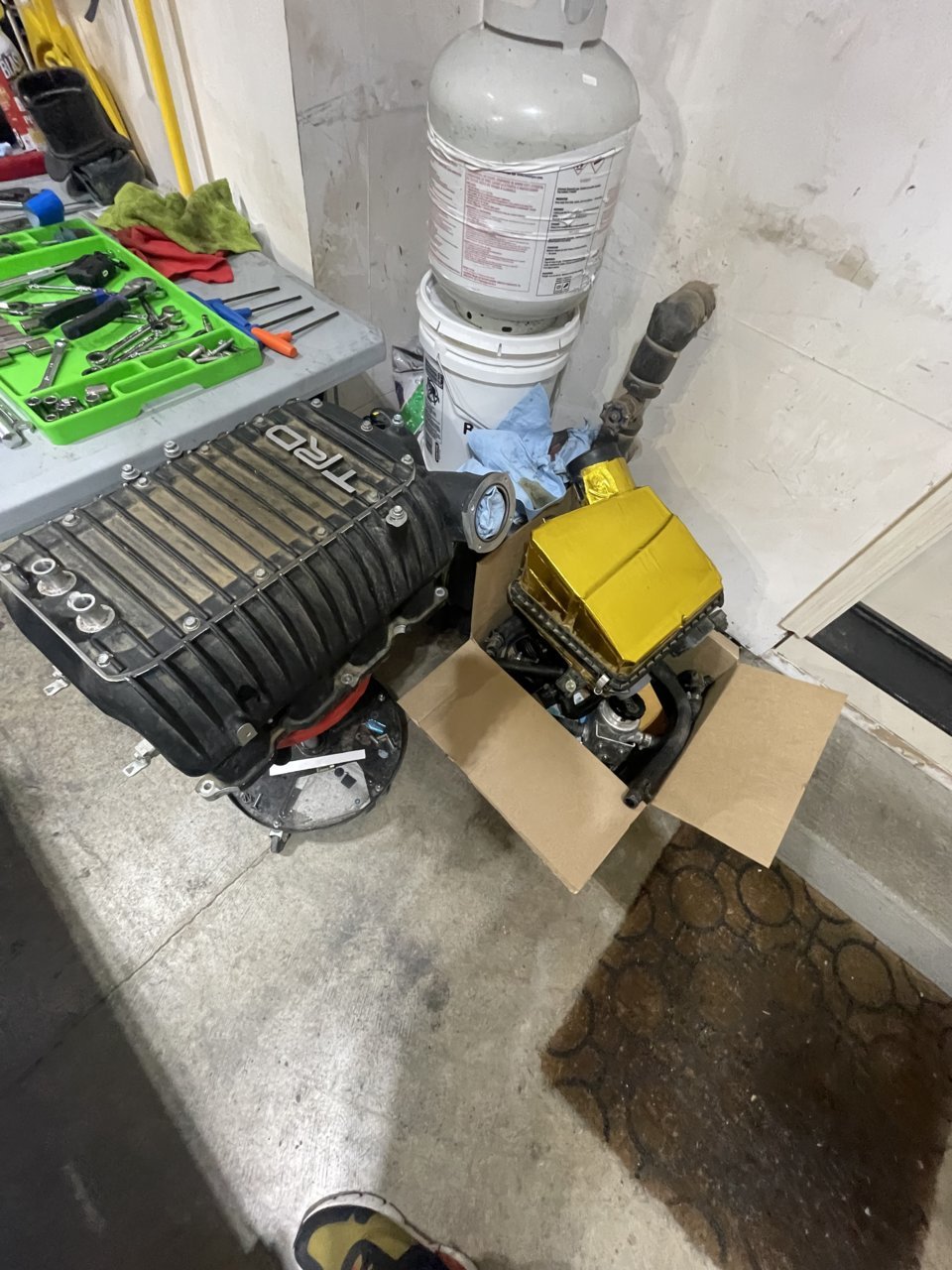

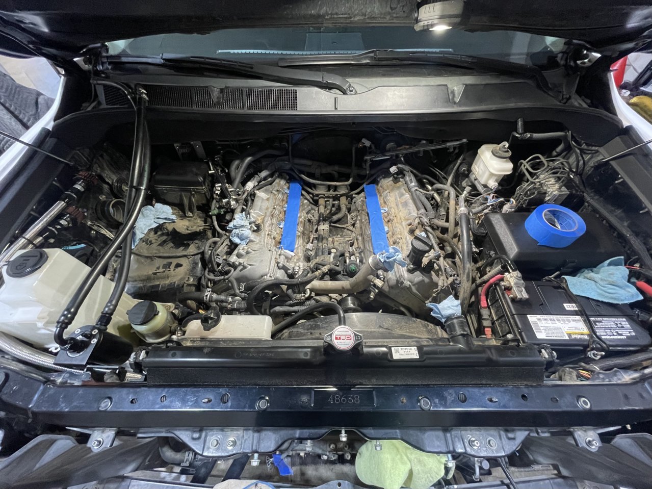

    Work from home/ sneak away and start this transformation to boost 2.0

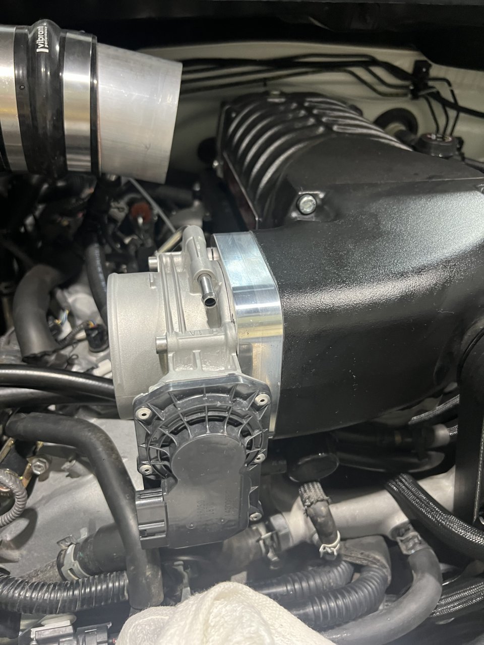

    @snivilous pops got his installed also just now. Looks good

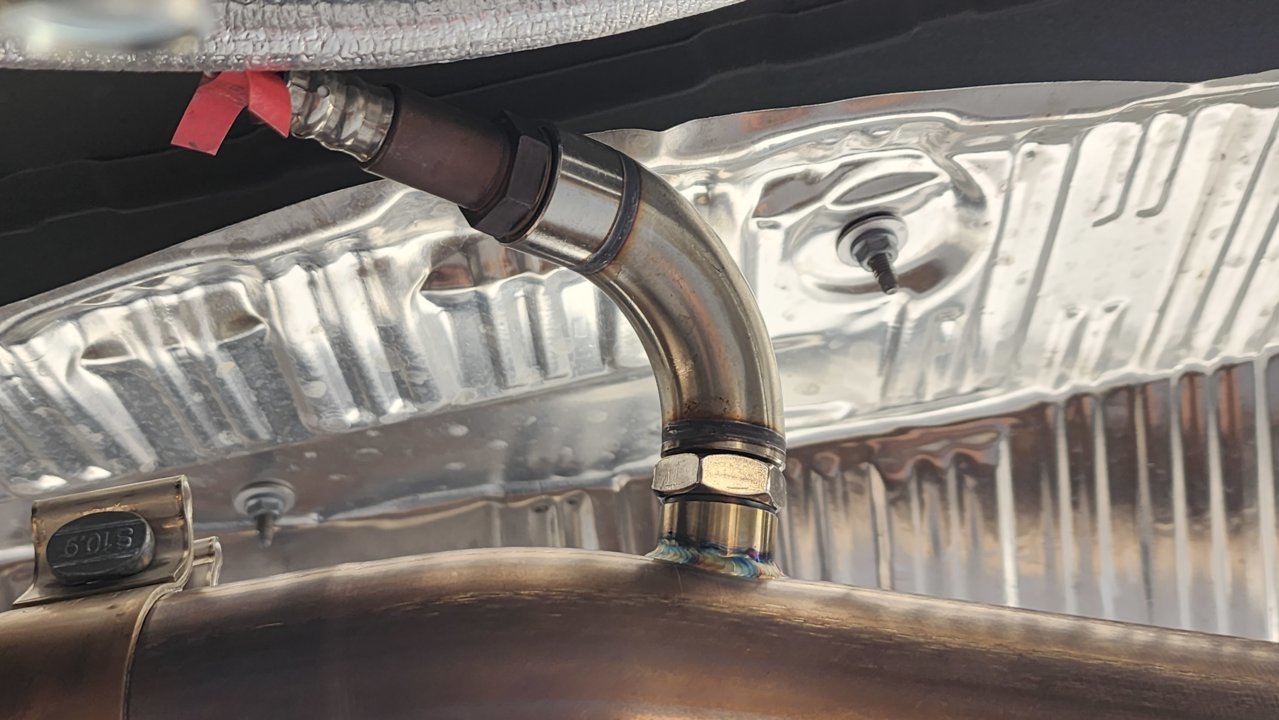

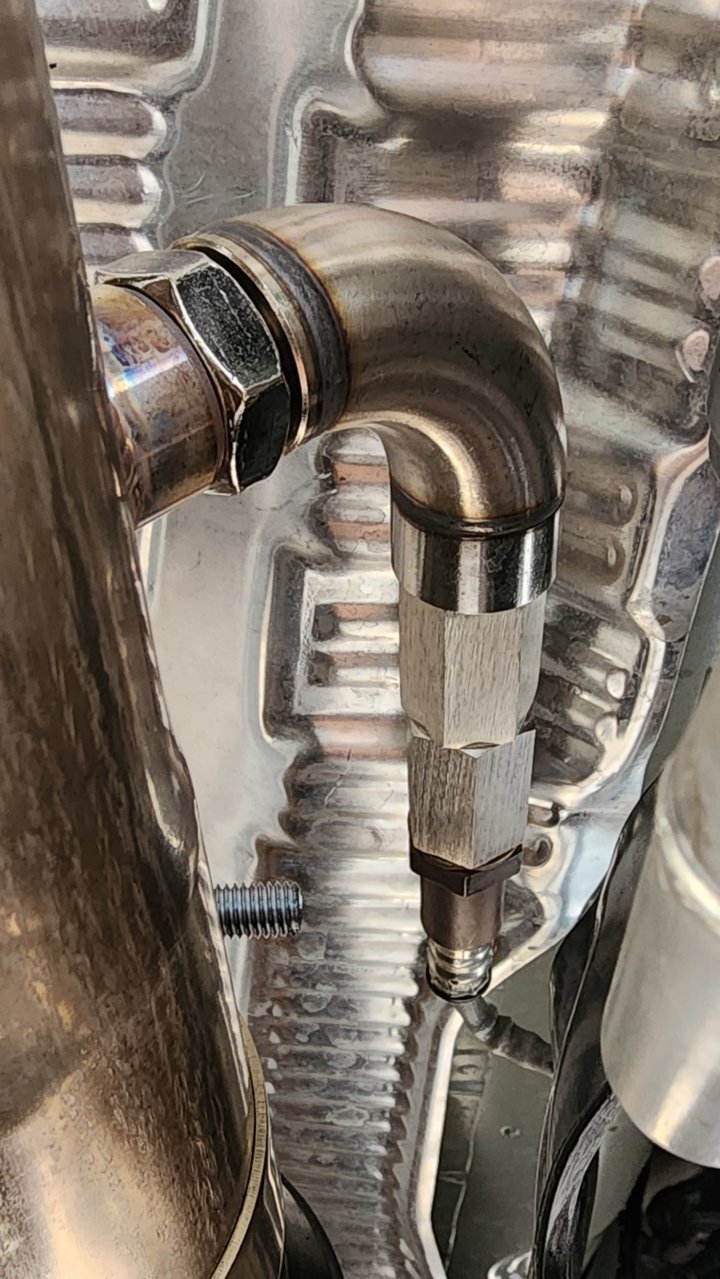

    just wanted to give you an update. I ordered the J-style extension from Jcarpart.com. It took care of my p0430 (passenger side) after 1 drive cycle. never came back. However p0420 kept coming back every 20 miles on the dot.
    From the same website, i ordered the spacers with the "mini cats" in them. stacked 2 of them together on top on the J-style.
    now almost 200 miles later, both p0420 and p0430 has not come back.
    passenger side and driver side:

    Thank you for the update and glad to see that they work! Sounds like your SW high flow cats are still holding up? I'll go crawl back into my hole now and continue the wait game :rofl:

    haha go with SW! no wait times! haha
    and yea i guess my cats are still surviving, i couldnt care less though

    What size insert did you go with? Glad to hear it worked for you. I did the exact set up even with the mini cats and the smallest insert on the j-style and still got a P0430 and P0137-Bank 1 sensor 2 low input.
