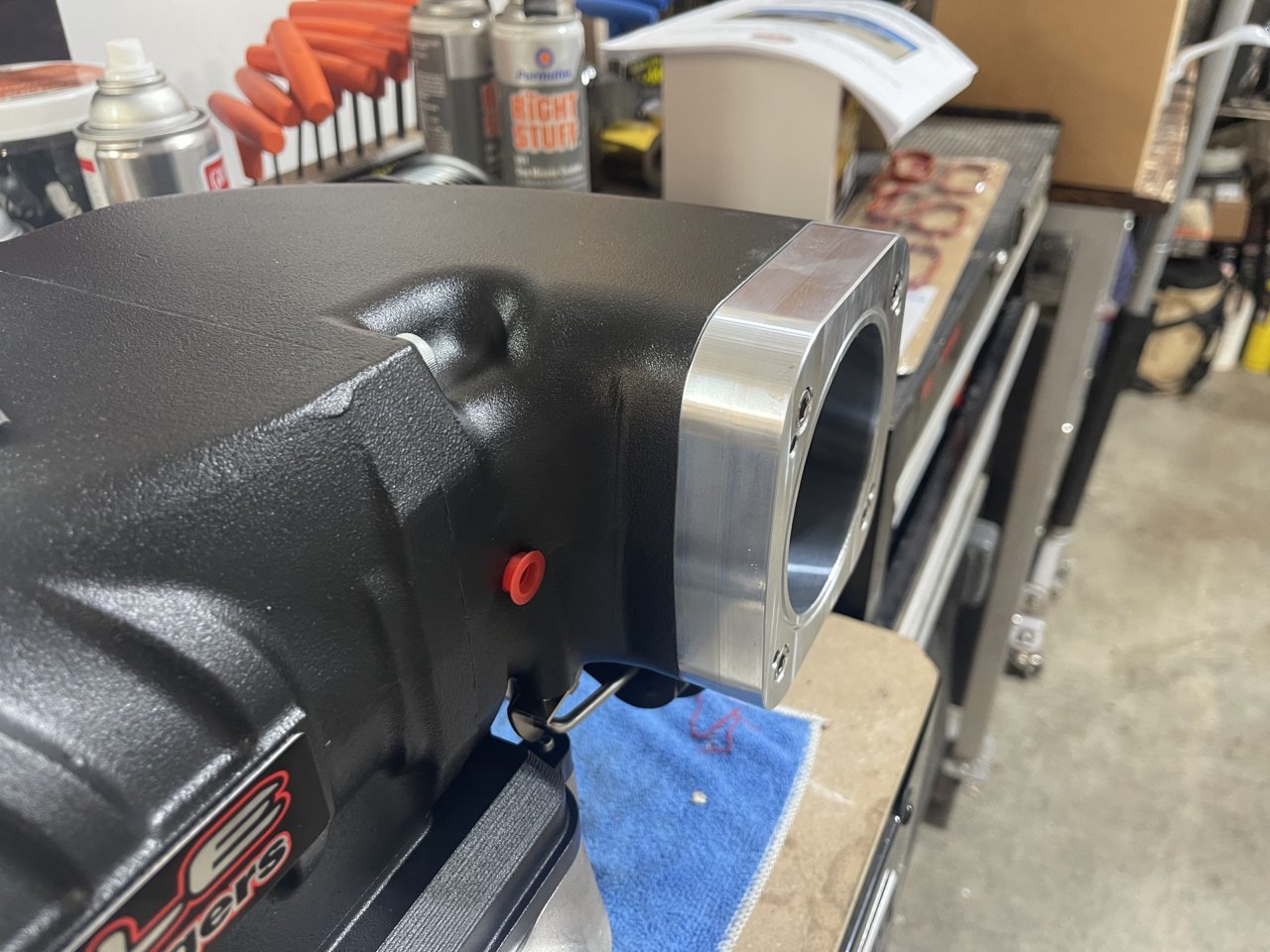

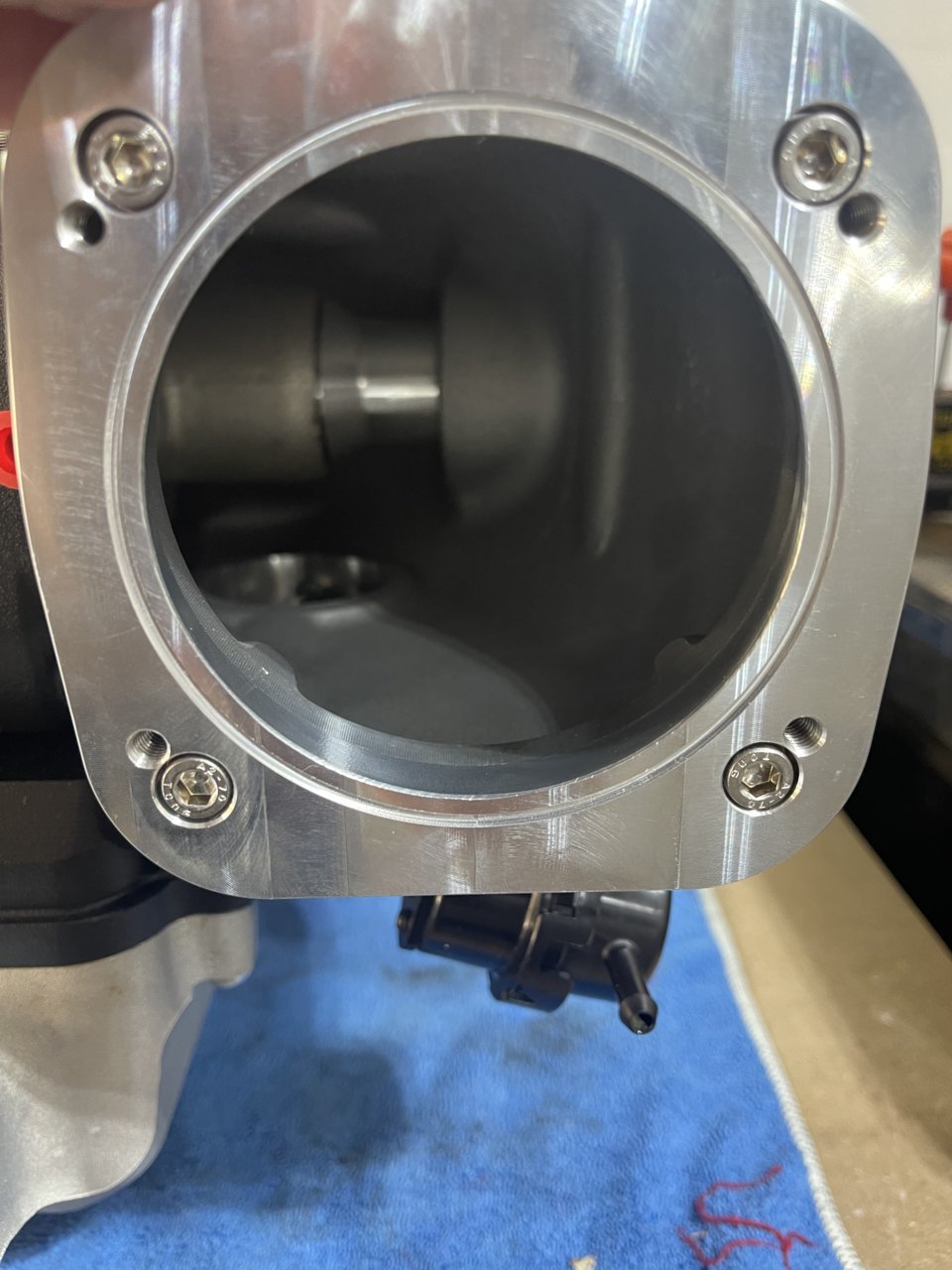

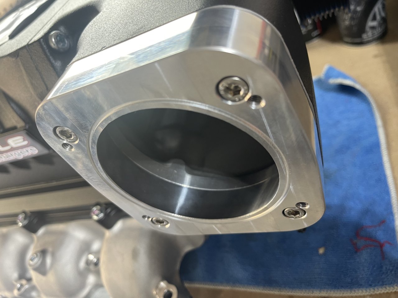

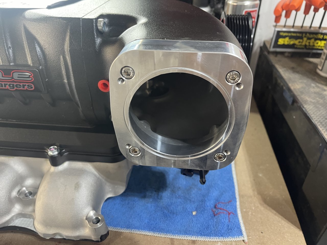

    @snivilous adapter plate looks good! Just waiting on my RCF to come and gauges hoping to get it all in next weekend.

    Looks pretty! Exciting, you gunna try to port/ polish any of the area pre and post adapter plate by chance?

    It’s machined with a chamfer for a smooth transition no need to port. But I have been considering sending the blower out for a full porting job lol

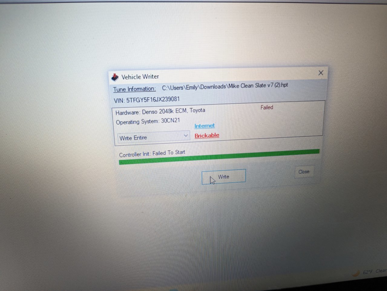

    I think I just killed my ECU, I started a upload of a tune on my HP tuner, I got to the first stage when you switch the ignition off for ten seconds and my laptop stopped, now nothing happens. I tried to reload the tune and I get this message. PXL_20230617_022224938.jpg
    Good times. Now the truck just cranks, I guess I'll be ordering a new ECU from Toyota.

    oh man im sorry. please keep us posted

    Damn, that sucks. Have you tried disconnecting and draining the capacitors by touching the positive and negative cables? Not sure if that would actually help in this case though

    Damnit. Did you have the computer hooked up to power? Sorry to hear

    How’s your truck battery? I’m guessing since it still cranks, it’s fine.
    In one of his videos, Viktor was emphatic about having a jumper hooked up to the truck when flashing. I did it about 5 times before I said this is annoying. Probably flashed another 20 times since without an external jumper.
