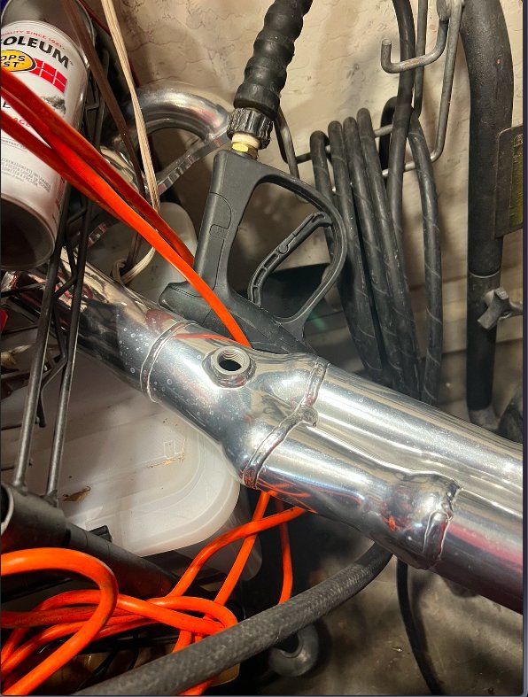

    ProSpeed was able to weld mine in with the headers installed, here is the passenger side

    do you have driver side?

    Yes, harder to see, and for some reason they left the sensor plugged into the header collector bung, so there is only a plug there

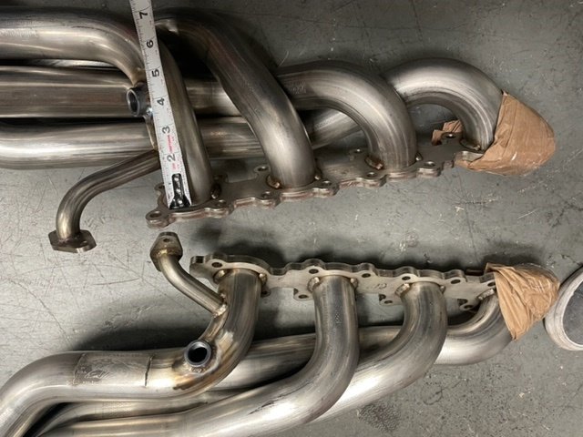

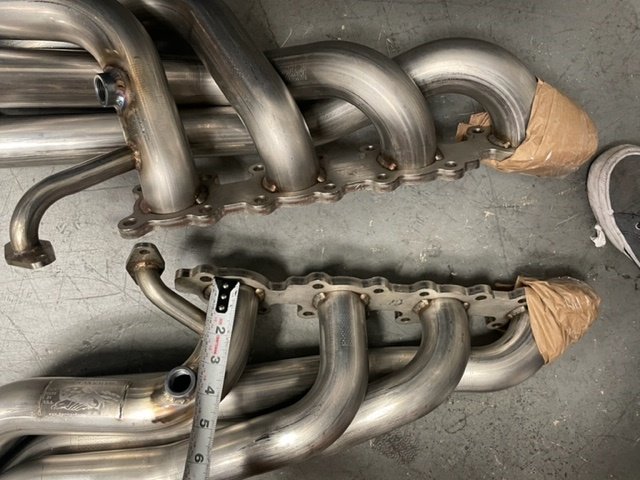

    Depends on how far from the OEM position. That is about the same position the SW LTHs have them on.

    I suppose I need to know where it needs to be, also I need to add another bung somewhere for my AFR gauge.
    Where did they go on these?

    These images are from Prospeed
