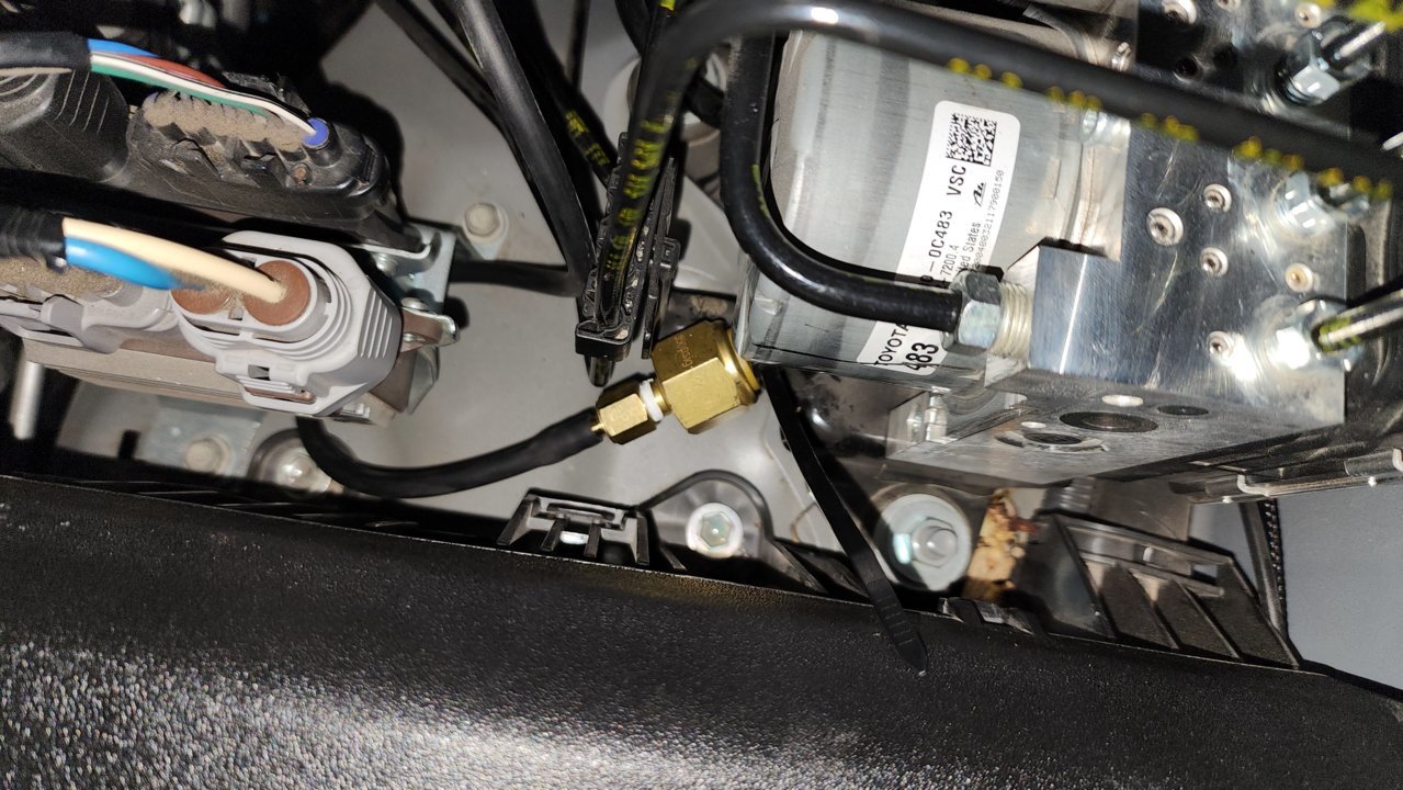

    mounted my boost gauge, went with AEM X-series gauge. she's reading negative 29 on idle haha and negative 24 on wot...vacuum leak? bad gauge? bad sensor?

    Where did you hook up the boost gauge's line to?

    2021 Tundra SR5 CrewMax Trail Edition 4x4
    please tell me i just did it wrong

    Where's the other end of the T going, the FPR?

    what does fpr mean? sorry im bad with acronyms. not sure where its connected to. but it does to the other side of the supercharger

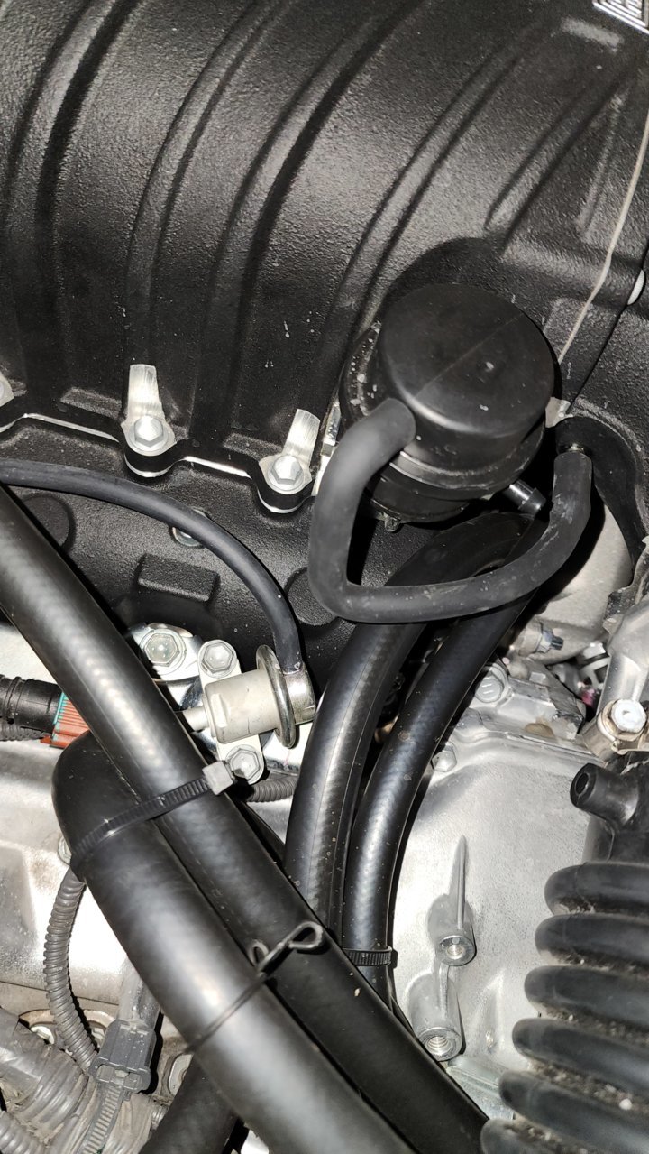

    Fuel pressure regulator, stock one is on the passenger side fuel rail.

    It can be seen here, silver with blue-painted bolts, in the middle of the picture with the small vacuum line attached:

    okay yea it still goes there then

    thats what i thought so too. so my boost sensor is T'd into that line but the hose is like 1 foot long and i have the boost sensor zip tied by the ABS module. checked the house for kinks, checked for leaks...nothing...

    I can see the bypass valve has a port not plugged?

    That's how it's supposed to be...
    @50Shades , looking at your last picture, I just noticed the small hole on the intake tube, does that go through, or it is sealed?

    yup bypass supposed to look like that.
    and wait good catch! let me double check now!

    nope its all sealed. black plastic thing covering it
