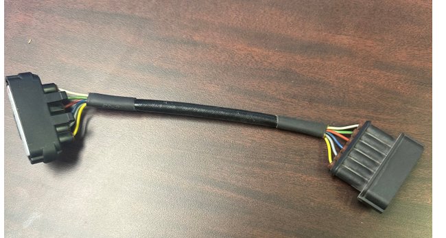

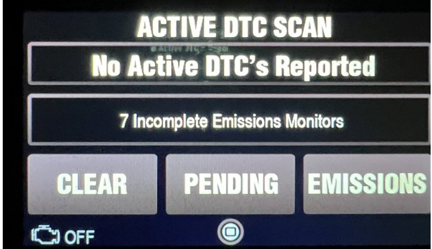

    Harrop guys. For the ones that were having problems with the MAF extension cable, what codes were you getting? I have one of my really good customers here with a stage 2 harrop that has a P0102-Mass airflow circuit low input, P0171-Bank 1 lean, and P0174-Bank 2 system lean. Before i start diving in trying to figure this out, it sounds like it could be an issue with that harness. Thanks in advance.
    Winks4x4Toy and reywcms like this.
  6. Jun 6, 2023 at 6:47 AM
    #8736
    nobodyintexas
    nobodyintexas What?
    Jun 22, 2020
    #48303
    6,922
    South of Houston
    S/C'd 2020 White 1794 Tundra
    I had all kinds of error messages. it put the truck in limp mode. like, when it went bad, it went very bad....there was no middle ground.
    it's been great since the new cable.
    my P0171's came from a vacuum leak from the vacuum connection, just under the snout. I tightened that up. all is well.
    I'll try to find the pictures I took of the scanguage messages....
    Winks4x4Toy and ssmokedz[QUOTED] like this.

    found it. not exactly the codes....

    I think the code I was getting with the Harrop TB extension harness was P0121

    Ok thanks. @nobodyintexas thank you but i'm looking more for specific dtc's. It is kind of a mess but this customer had somebody who may or may not be that mechanically inclined driving around in this truck for a few months trying to diagnose a transmission issue before bringing it to me. Long story short it ended up getting a transmission. On the initial road test those three codes come up pretty quickly and the truck drives pretty bad. He has a full prospeed fuel system and the regulator reads around 50 psi at idle. What sucks is the customer has not driven the truck himself for so long he said he doesnt know how long he has had those codes. I just want to help him out. I put the genuine cooling systems trans cooler in for him as well while the trans was out. Hopefully that prevents another trans failure.

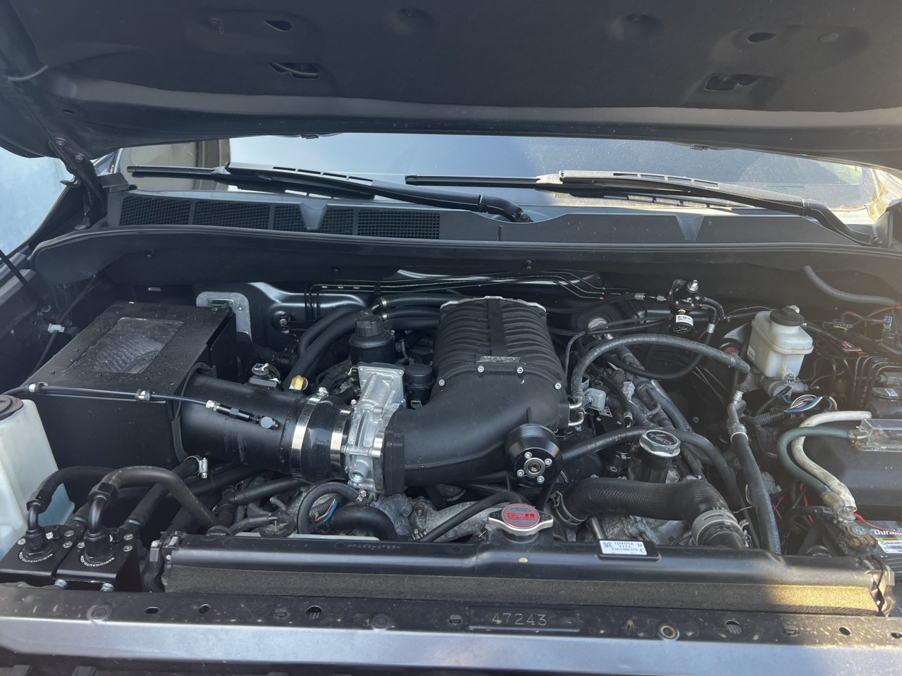

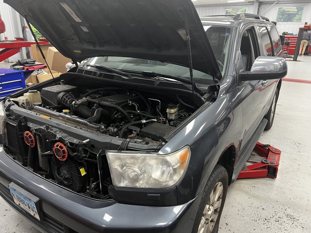

    On a side note there are 3 supercharged 3ur’s on the lot today. Mine, my customers, and a Sequioa i installed a TRD unit on over ten years ago and its still going strong! IMG_1777.jpg IMG_1443.jpg IMG_9755.jpg

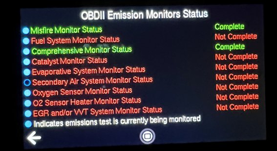

    ah! I found another picture...I only had emission related crap happen. I didn't throw codes.
    weird, right?
    sorry - I'm no help. best of luck on the diag.
    keep us informed...I always learn something.

    That is odd. Looks as if all codes were cleared and all the monitors have not been set yet. But i appreciate the input!

    I learned from my emission test hell, clearing any code sets all monitors to not ready.
    Freaking sucks. I got the 101 the day after I finally passed so no care that it's not ready.

    Did you have your headers on when you passed? I have to go. I can get 6 out of the eight monitors to pass. Catalyst and Oxygen sensor being the 2 that will not pass. I have cats but clearly they are not going to pass the monitor. I have tried multiple combos of 02 sensor non foulers etc but the waveform for the rear 02 sensors is never correct and it will always throw either a cat code or 02 sensor code. Its a pain! if the cel is on you can't use cruise control and that is annoying! I'm pretty sure here in CT you can pass with 2 monitors not being set but i don't remember if that is 100% true or not.

    whatever this is...

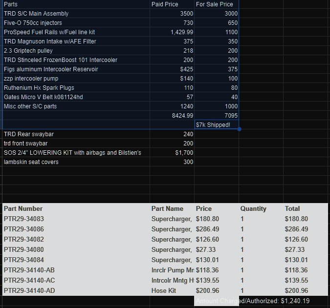

    Quick post for parts. I want to try and sell it as a whole set before breaking anything up to sell separately. Spread the word! "Bad-Ass Truck In A Box(es)" lol $7k shipped
    And if local pickup, $6500
