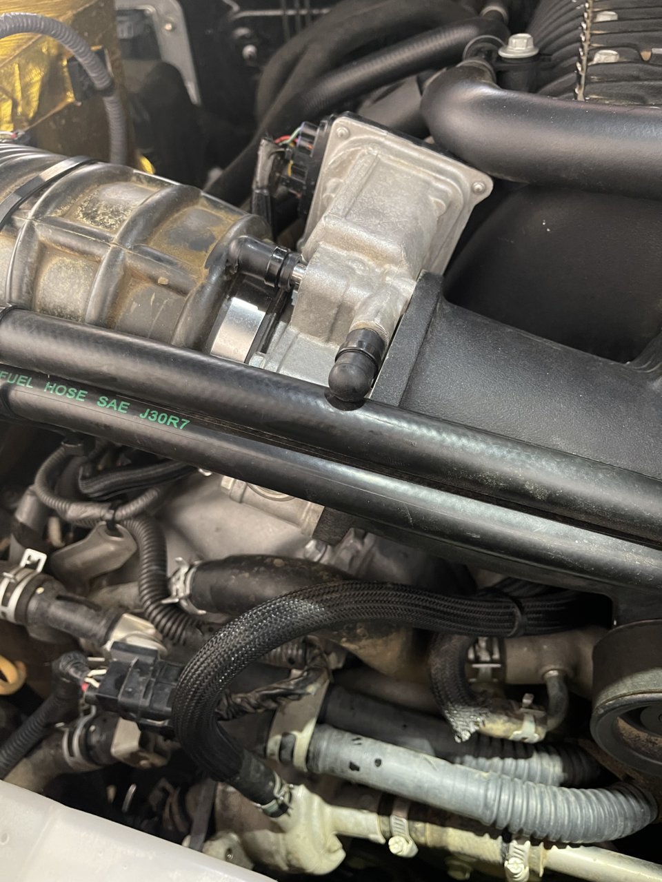

  5. Jun 1, 2023 at 11:20 AM
    #8675
    reywcms
    reywcms New Member
    Dec 20, 2021
    #72040
    7,504
    Rey
    North Plains,Oregon
    2017 Tundra Platnium
    Too many mods to come
    Whelp guess I’m heading to get a barbed fitting lol.
    Also discovered craven speed is basically down the street from me so I’ll head there and grab a mount lol
  6. Jun 1, 2023 at 11:32 AM
    #8676
    e30cabrio
    Oct 20, 2017
    #10410
    6,508
    West Valley, Phoenix, Az.
    Boosted 2013 Sequoia TRD FAUX
    I had already bypassed the TB coolant, when I did the SC, I just removed the original hoses with the barb in the middle & ran a single hose, cleaner.
    If you have a gauge that is on the bigger side, see if you can get longer bolts for the pods.
    Saltyhero13 and reywcms[QUOTED] like this.
  7. Jun 1, 2023 at 11:35 AM
    #8677
    Silver17
    Oct 3, 2021
    #68847
    3,737
    Eastern PA
    2017 TRD 4x4 Harrop SC
    Technically you don’t even need that fitting if one of the hoses is long enough to just go right to the thermostat housing. I chose to do it with the barbed fitting so that everything was right there to put it back how it was quickly, and also it’s at a higher point so I figured I’d lose less coolant. It’s pretty negligible though I’d say.
    reywcms[QUOTED] and HulkSmurf14 like this.

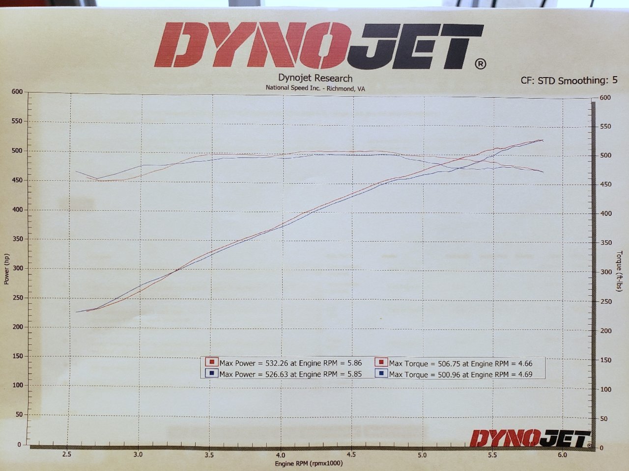

    RE LTH Picked up some small gains, may not be all LTH gains. Sound is deeper and mellow. No drone or obnoxious sounds as I suspected but also on stock muffler. The sound emanates further back behind the driver position; stock header sound is is more forward between dash to below the driver.
    Modest gains:

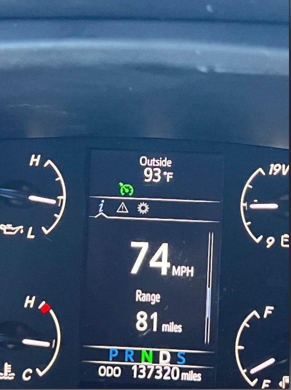

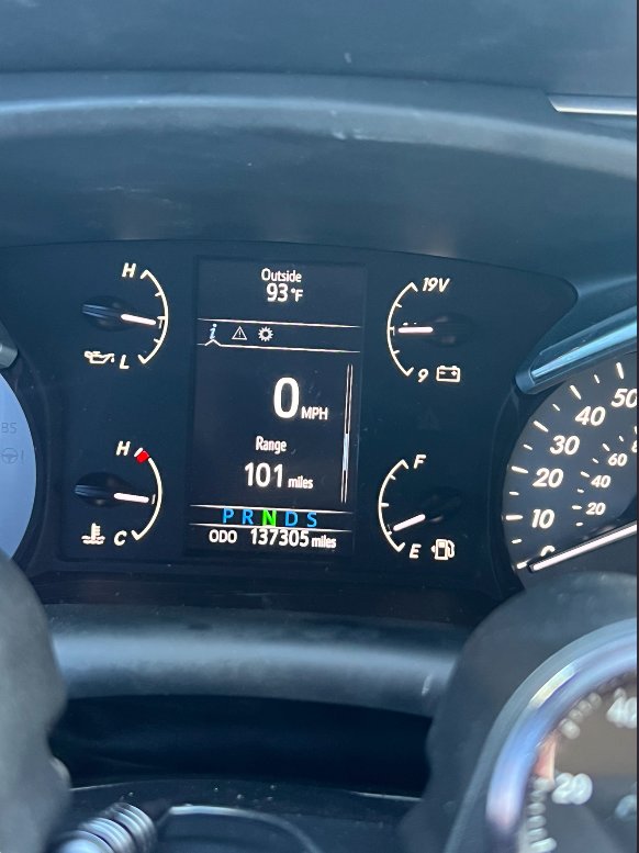

  18. Jun 1, 2023 at 6:32 PM
    #8688
    e30cabrio
    Oct 20, 2017
    #10410
    6,508
    I don't have with the coolant going through, but heres my findings.
    Sitting in a parking lot 93 ambient 10 minutes, ac on, 131 IAT.
    Driving on the freeway, 10 minutes average 65mph. Ambient 93, intake 96.
    Silver17 and Saltyhero13 like this.
