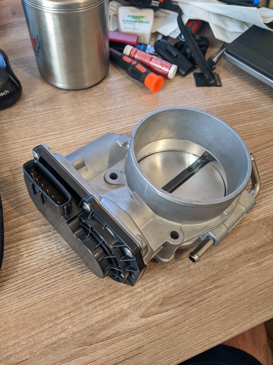

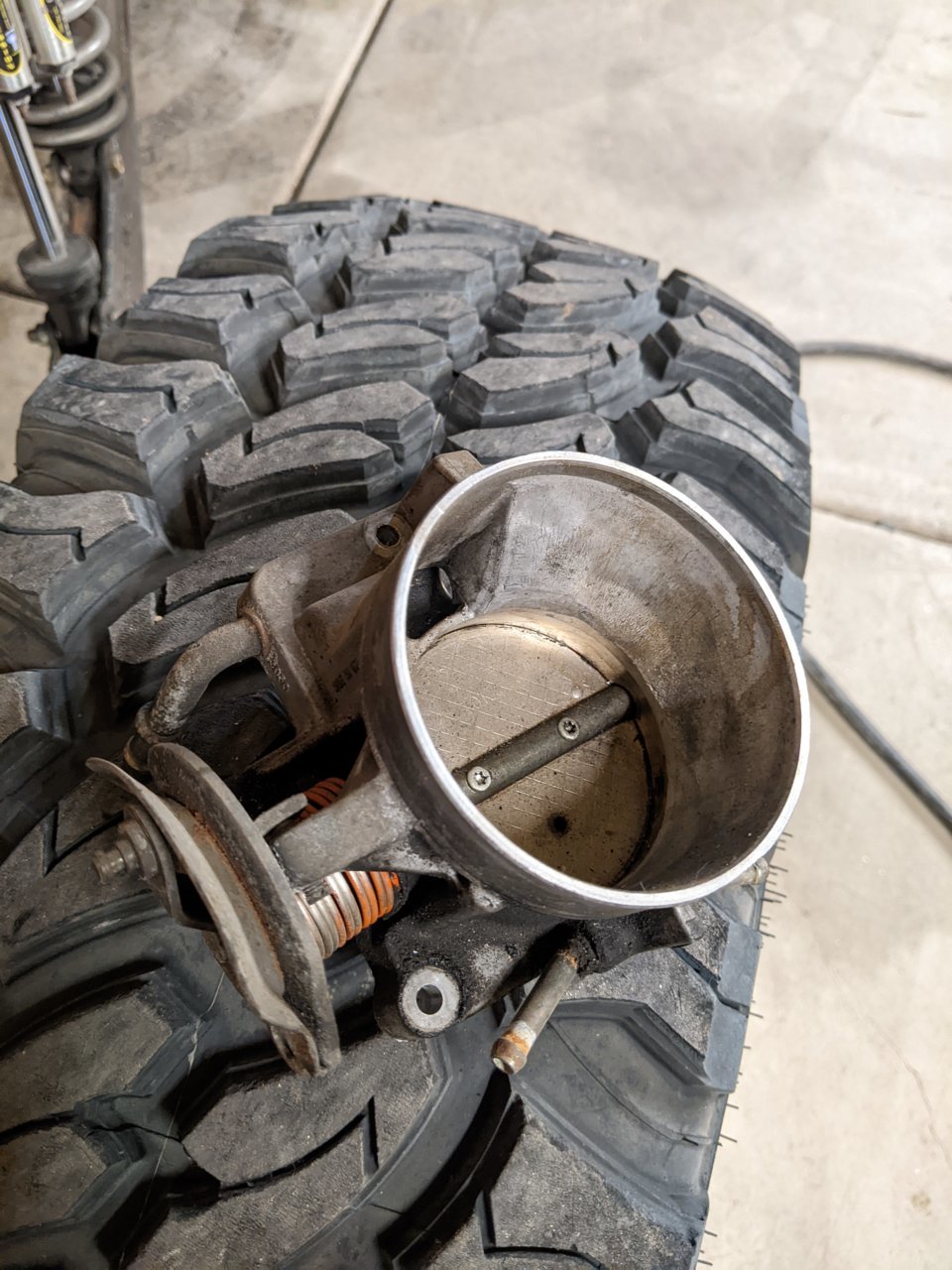

    I have Reys RCF throttle body he sent me. I also have a Nick Williams 92mm (iirc) on my LSA setup, and some random (6.0 or 5.3) throttle body from one of my engines:
    Assuming the Tundra is the same as the RCF, the motor assembly is riveted to the housing so those would need to be drilled out, and then all the parts of the housing (can see the motor bulge and there's probably bearings and springs and shit) would need to be made as a stand alone piece is my thinking, then probably have a second piece that connects the Tundra electronics output (probably a gear or maybe a dedicated output shaft) to the GM butterfly shaft. So optimistically it'd be two parts: replicate the housing components on the Tundra TB and that part would also somehow attach to the GM, and then some intermediate connection between the drivetrain and the butterfly valve. Probably wouldn't look much different than the stock RCF shown besides the housing becoming effectively a two piece design. And then cap off all the GM shit.
    With that said I haven't torn into anything, and Rey didn't want me destroying his RCF TB in the name of science :D

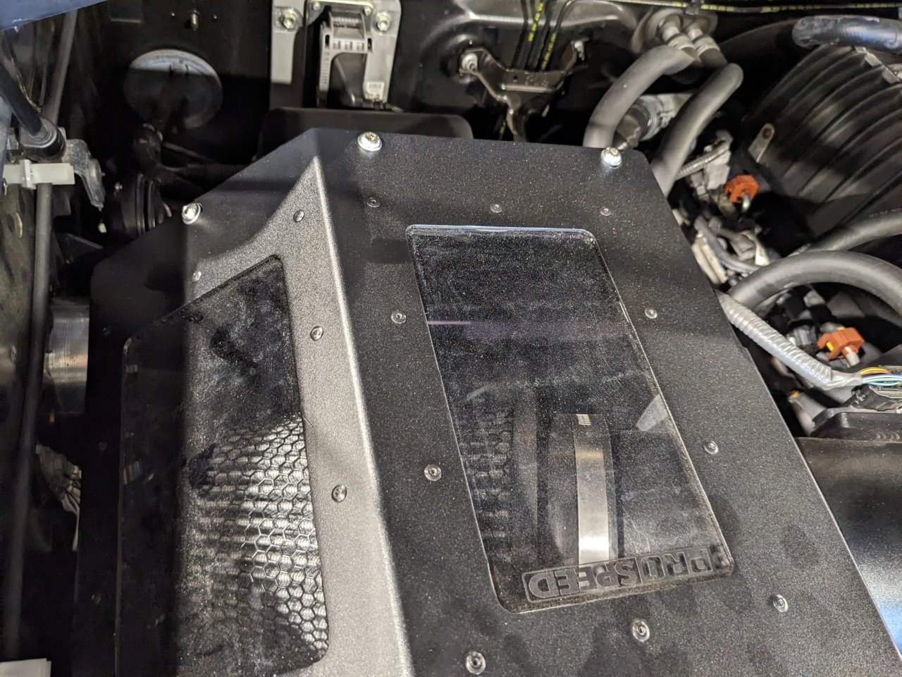

    So, my truck has been sitting since I installed the PS fuel system, for me it was just a fuel pressure regulator, lines and rails, I already had the injectors and fuel pump. It's been sitting because it would go past 3k rpm after the install. I thought I could have a clogged cat, but the guys at PS said I shouldn't drive it because it needs to be tuned. I'm four weeks into a ten week wait for my AR long tube headers, once they are installed PS will tune it. So, like I said the truck has been sitting until tonight. @snivilous sent me a tune that got my truck running normal again and I can't thank him enough. I will be installing his 2.2 pulley with the header's and putting the truck on the Dyno to see the difference.

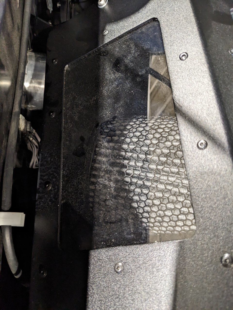

    Glad he got it running! Can you share a pic of how the Prospeed box looks against the fender wall? Curious since there’s no pics of that.

    I have the whole drilled for the second air inlet, worked great with the PS intake. Let me know if you need a better pic. PXL_20230419_155150347.jpg

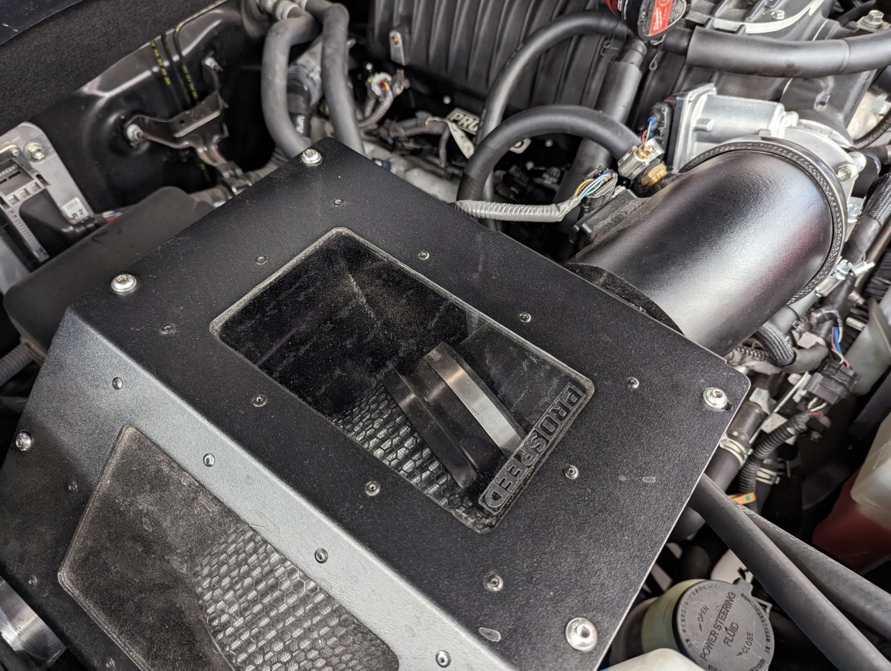

    Awesome ya a little lower to see the fenderwell area where the inlets are would be great.

    Awesome thank you! Did you add a larger airfilter? I ordered a larger piece if it fits I’ll send you the part info.

    I'm just running what came with the intake.
