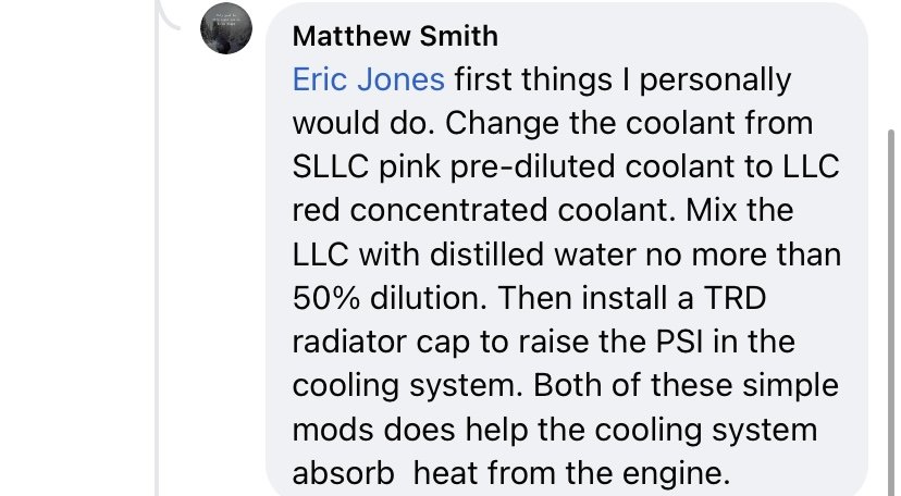

    I had no idea the 2 Toyota coolants had different cooling properties. Thanks for that info, I don’t have FB.

    For real though I don’t actually know what the deal is with the two coolants but he is a pretty smart dude. I don’t think I care enough to make the switch to red on mine.

    I used Evans waterless coolant in my S/C'd Tacoma. I've thought about it in my Tundra. What I really liked is that it didn't need to be pressurized (nearly as much) so that it wasn't stressing the cooling system with pressure in addition to the usual hot/cold cycling. The stuff is spendy though and you need to get all the water-based coolant out of the system first. Kind of a PITA. Here: https://www.evanscoolant.com/

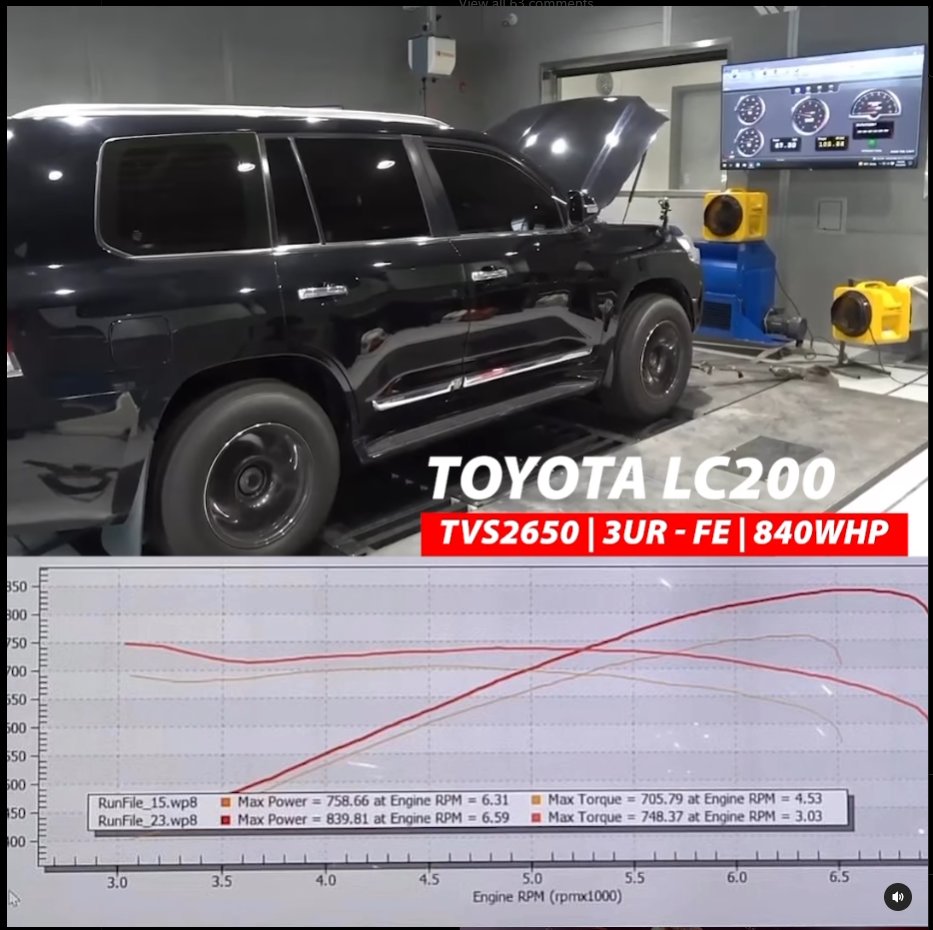

    From Harrop's IG this morning, comments say it has forged pistons and rods...
    harropperformance Our friends @kanooperformance dialling in a 3UR 5.7 V8 Toyota LC200 build with our TVS2650 Supercharger and 110TB packaged with Motec M1 and KP flex fuel at 17-18psi putting down 840WHP

    Flat TQ beautiful thing.

    Looks like an awd dyno. Wonder if those numbers are to all four?

    I don't think Land Cruisers have 2WD?

    The Kanoo guys are out of UAE I think, maybe Bahrain. They were running the Voodoo Blue Tundra with the wide body kit.
    Sick numbers out of this beast.

    This is correct. At least not on purpose they don't!
