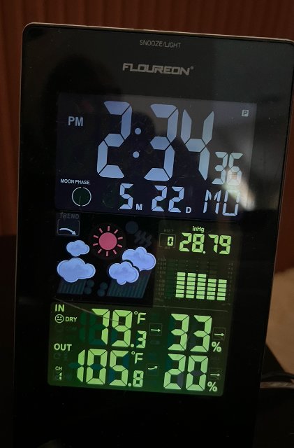

    This will be 4. It's odd because it goes to 40 for a second on start up & drops to 20, also, it does not go lower when running the adjuster out.
    I swapped in the old FPR hoping that was the issue. Same behavior.
    Of course, it's the hottest it's been (104) I picked it up & will little by little it.
    Can I sell @ 105?

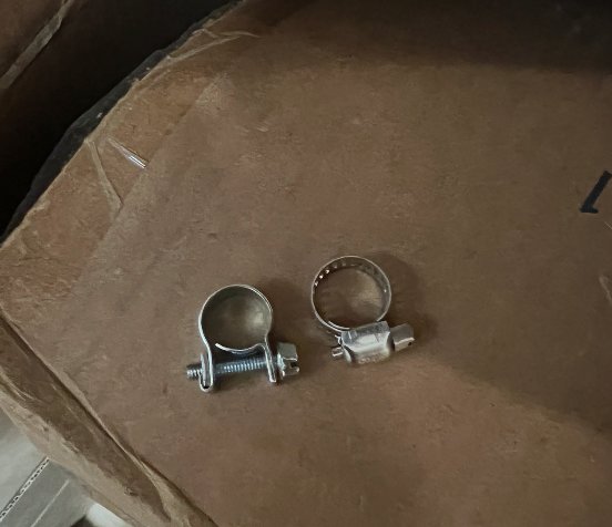

    Fucking feed hose was loose again. I'm seriously not understanding how tight I need to make that hose clamp, both times it was to the point I was worried I was going to break it, so I replaced the "best fuel clamp" with a regular one.
    The one on the left was there, I used the one on the right this time, I forced the hose on the nipple, then pushed the clamp on & tightened it further than I like but I really don't want to do this again. Anything else I should do before buttoning it up (with difficulty, there's 3/4 of a freaking tank)

    I think I used mostly the clamp on the right, but used one or two of the ones on the left with the Radom Venturi pump

    When in doubt double hose clamp it is my philosophy.

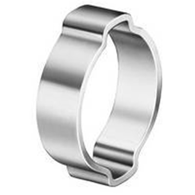

    I'm a fan of these types, been running them since my old race car.

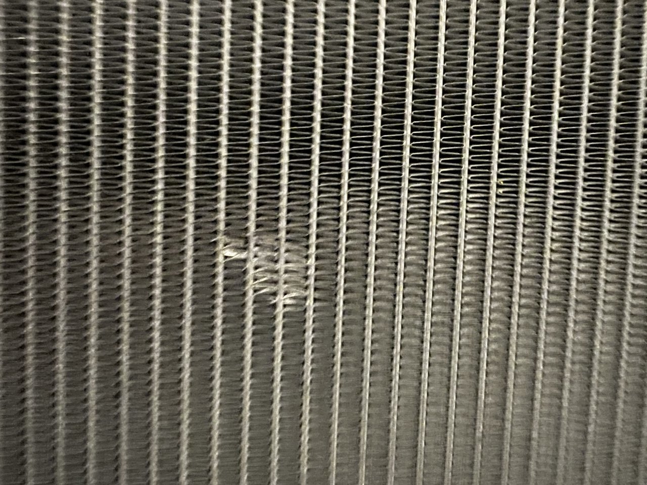

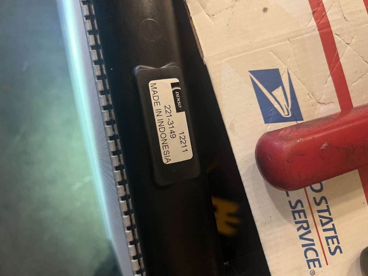

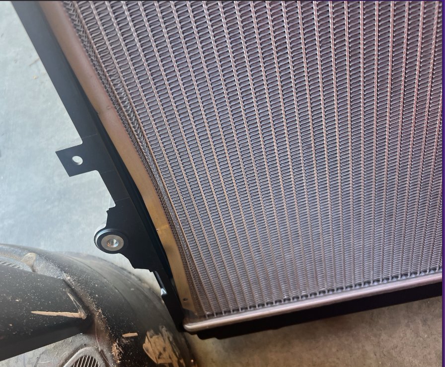

    Radiator has been acting up, got a new OEM Denso.Should I be concerned about this?
    I was able to bend most of the fins back.

    I was not aware that the TRD coolant cap raised the PSI! Interesting
    nags likes this.
  30. May 23, 2023 at 1:09 PM
    #8520
    Wynnded
    Wynnded What MPG...
    #379
    5,724
    Rockies
    Souped up truck
    That's what the PSI rating means....:rofl:
    It prevents coolant from expanding into the overflow tank unless the system reaches that pressure.
