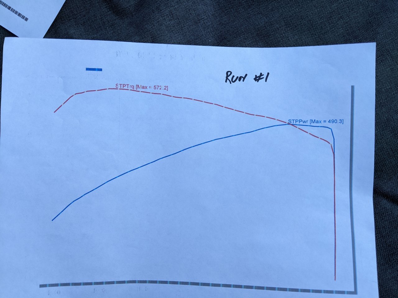

    Introducing the absolute worst print out ever :rofl: but 490whp/572tq @ 9.6psi. 80F in the shop, 2600ft elevation. Magnuson with 2.0" pulley.
    I did three other runs but they were all less which dude said is normal since the engine heat soaks (though would've thought it was already heat soaked from driving for 45 minutes there?). Tried two tunes with modified optimum torque and cam timings, but since it was making less power after the first pull I couldn't really get an apples to apples comparison.
    Kind of bummed it didn't break 500whp, but I'm sure it'd do that in the winter. Probably 610-620 at the crank? Respectable for 291k and a stock engine :D

    That printer is terrible lol!! Awesome run definitely over 500whp with better temps not bad for the old gal!

    That TQ though...sheesh.

    Hell yeah, love torque curve of the 5.7s with boost. It’s like a diesel. These TTV6 fellas are always going on and on about the low range torque. They haven’t seen torque!

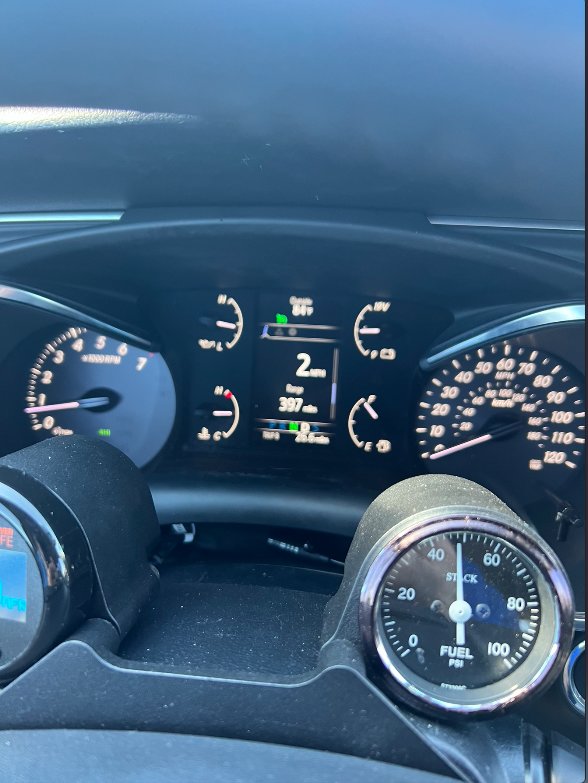

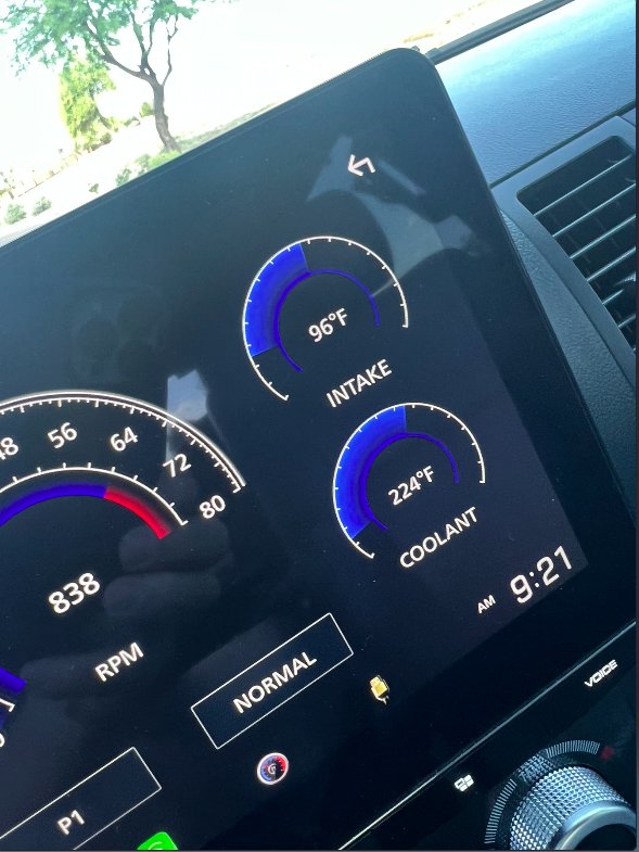

    I have these too.
    I just drove my wife to get her hair did because both cars are getting detailed.
    The Sequoia got hot. I had never seen above 210 & the needle on the dash gauge never moved above 1/4. It got slightly higher than the picture & up to 230.
    It makes no sense breaking the nipple for the overflow would cause this, all I can think of is drilling to fit the repair nipple stopped the cap from sealing & not allowing the vacuum.
    The overflow was bubbling, I found the Denso on Amazon for 209 so got it for 227.82.
    Any tips on the R&R?

    How is your Tq so high with the Maggi?

    No idea, besides fueling my setup is straight out of the box with a pulley on it and that's it.
    We need a post that has all the Dyno results in one place so we can easily browse how everything compares.

    I thought he meant the curve compared to like a Harrop :rofl: yes if you just meant raw torque @WCTXN I have a 2.0" pulley, stock is 2.45". It helps make up for the altitude I'm at plus a bit more juice :thumbsup:
