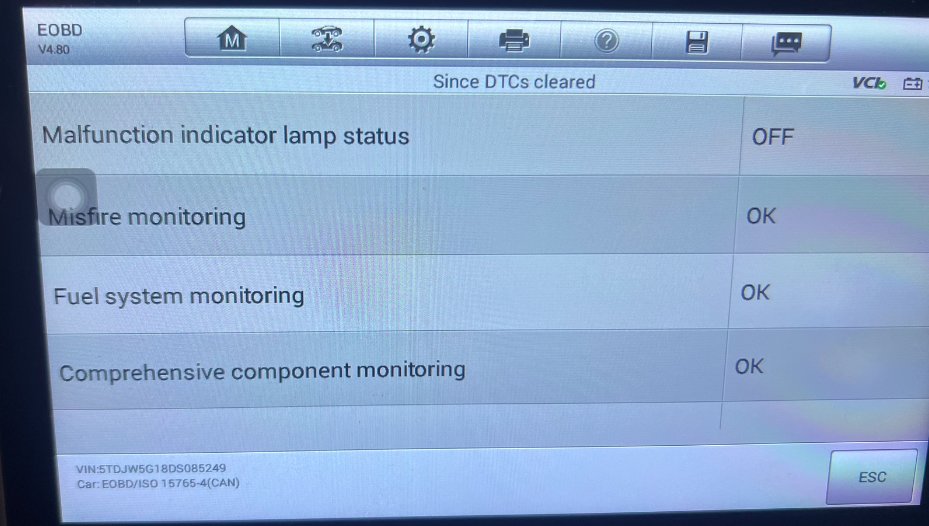

    Boosted 2013 Sequoia TRD FAUX
    My registration expires 5/15, I just went for the smog test & was not ready. GRRRRR What's the best way to get ready? I'm researching if my Autel can set it to ready also.

    Autel had a long hold & was unpleasant, I had found the screen myself. Can't go back until tomorrow but that is not my idea of a fun way to spend even a second of my B-DSay so that's not happening.

  22. May 8, 2023 at 3:43 PM
    #8092
    e30cabrio
    Oct 20, 2017
    #10410
    6,508
    West Valley, Phoenix, Az.

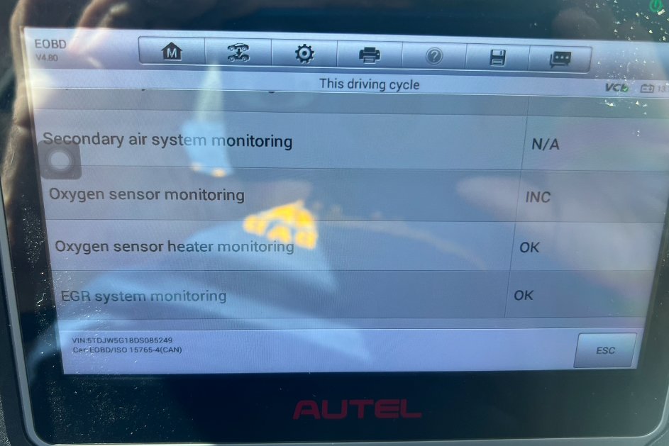

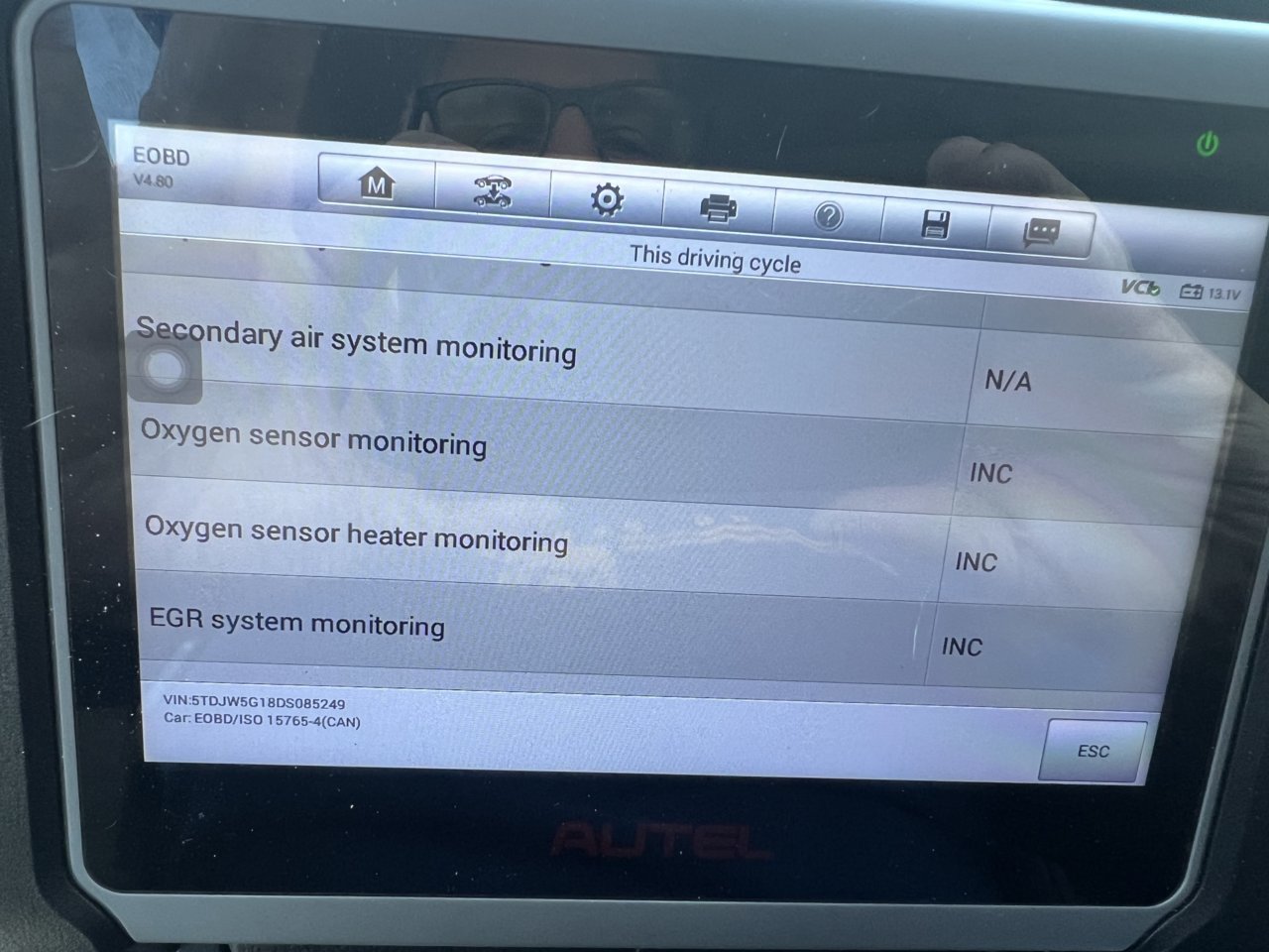

    After 2 drives here's what I have.
    It's hard to go 55.

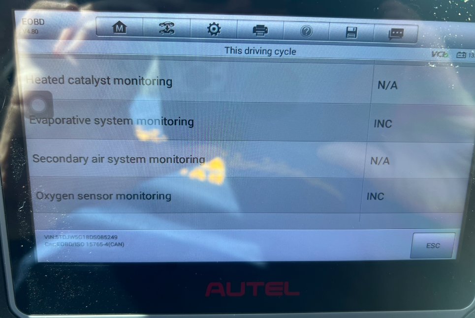

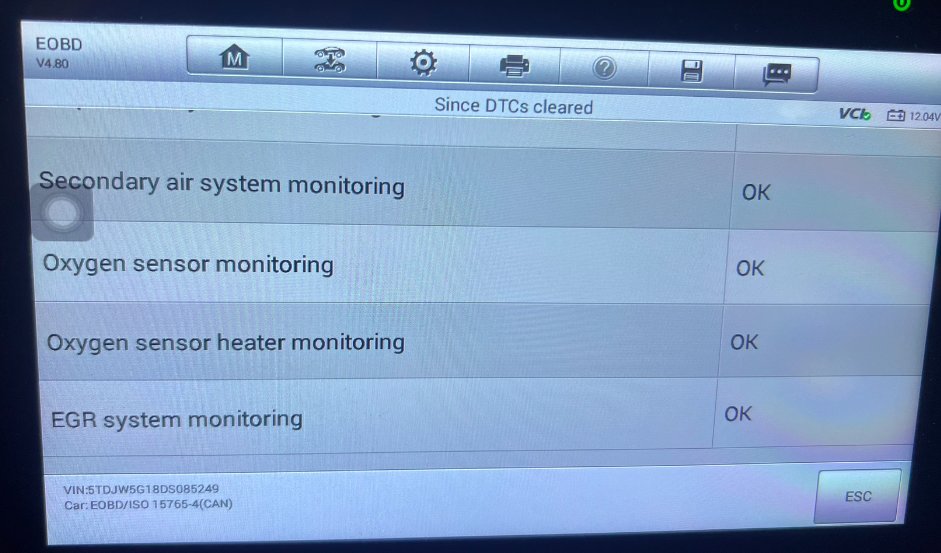

  23. May 8, 2023 at 4:08 PM
    #8093
    e30cabrio
    Oct 20, 2017
    #10410
    6,508

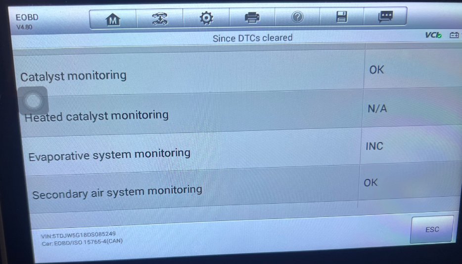

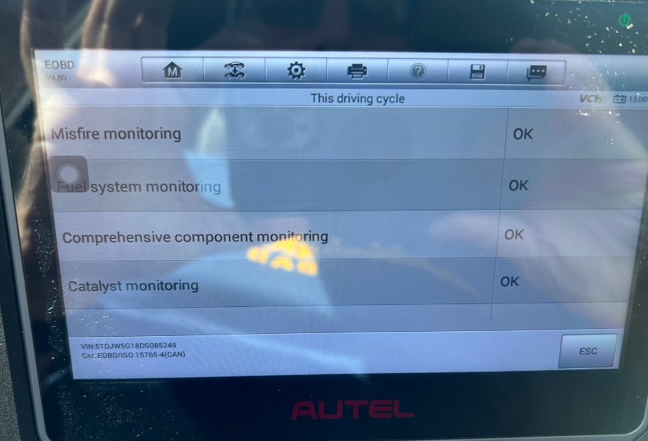

    Those are all this drive cycle, since DTC cleared has all but evap ok.

  24. May 9, 2023 at 7:54 AM
    #8094
    e30cabrio
    Oct 20, 2017
    #10410
    6,508

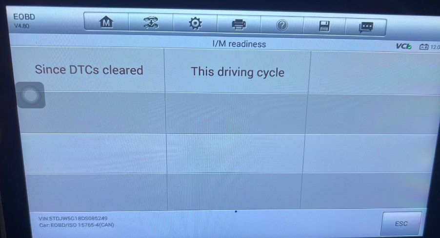

    Here is where it is this morning, it seems EVAP can be not ready. (it is)
    Everywhere I look says evap is ok to be not ready as long as no cel. (even in Ca)

    No, as I am at 1 that I think is ok to not be ready I don't want to start over. I just chatted with MVD who told me to call AZDEQ, I'm in a Webex meeting so can't call for about 30 minutes.

    You can pass with one test status in the "not ready" state as long as there no current or pending codes, at least in TX. I've passed with O2 in NR one year, and Evap in NR the next year.
