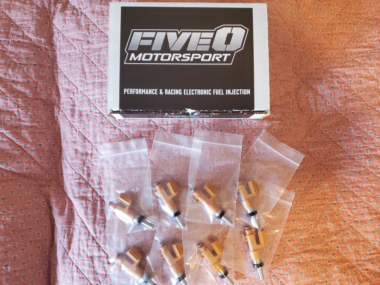

    No call back yet, but I sent their shop manager a text. I'm guessing since they are normally swapping the stock injectors for the green ones during their supercharger installs it likely appeared that I was going backwards in injector size since the FiveO's resemble the stock injector. That's probably what threw them for a loop.

    M3Tundra-JK New Member
    May 3, 2022
    #77930
    2,841
    Scott
    2005 GX470
    My Five-O's wern't Orange though...they were stock color, Tan
  3. Apr 17, 2023 at 1:26 PM
    #7773
    e30cabrio
    Oct 20, 2017
    #10410
    6,507
    West Valley, Phoenix, Az.
    Boosted 2013 Sequoia TRD FAUX
    Mine too.
  4. Apr 17, 2023 at 1:30 PM
    #7774
    AZTundra
    Feb 13, 2018
    #12894
    4,473
    Paul
    Phoenix, AZ
    Maybe the lighting? I'm pretty sure mine were tan as well when I opened the box. Don't get me all paranoid now...
    Edit. Here is a picture saved on my phone.
  5. Apr 17, 2023 at 1:55 PM
    #7775
    M3Tundra-JK
    May 3, 2022
    #77930
    2,841
    Scott
    2005 GX470
    ok ya, I just wanted to make sure!
