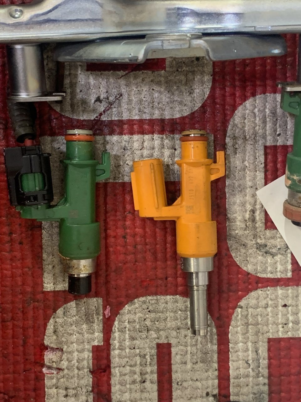

    Does this look correct? Green injectors versus Five-O 750's? Just got the below pic and was asked to give the shop a call. Not sure if they are just questioning the longer shaft or what. Just looking for confirmation I should be good here before I call them back.
    @snivilous or anyone

    They are fine. The stock injectors are the length of the 5.0s

    Phoenix, AZ
    Thanks. Any idea what they may be questioning then? I just tried to call them back, but got his voicemail.
  22. Apr 17, 2023 at 12:31 PM

    my guess is the length

    Probably just questioning why they look so different? As Rey said, stock style is what the Five-Os are. The TRD ones if anything are the questionable ones :D

    They appear to be the same length as stock with the TRD green injectors being shorter that stock from what I can tell. I called and spoke with FiveO and sent them the picture, just waiting on them to respond as well. Maybe the tech is thinking I'm going back to stock injectors based on appearance and that is what they are trying to confirm.

    Got it, I think you guys are right. Just had my little panic attack for the day...hoping the install goes smoothly. I get nervous when I get a message to give them a call. Thanks for the quick response guys! Hopefully smooth sailing from here.

    Here's stock vs TRD for reference

    I had the same question when my 5-O's came & the greens were my only reference. They fit just fine & visually oem are identical to the 5-0s
