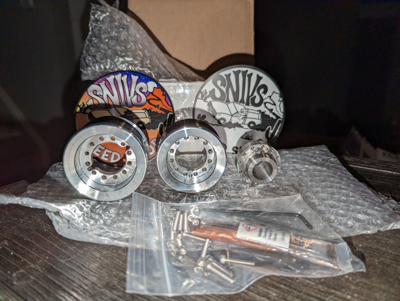

    Oh, and these came in today! Save them for the LX :-D

    What sizes?

    2.2 and 2.0

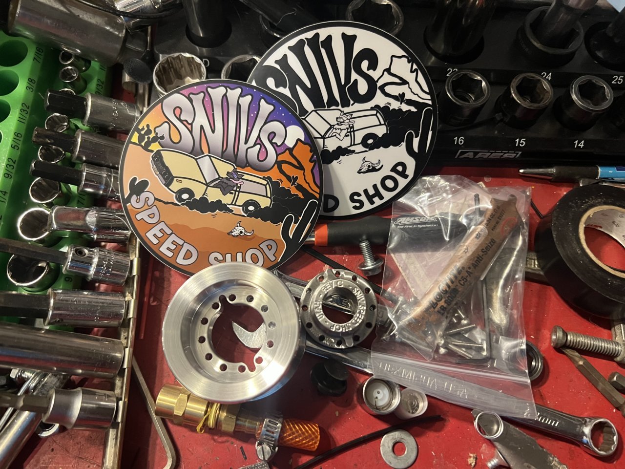

    Also one of those beefed up pulley puller/installer tools for those without a press
    I think we'll have endless ideas for you lol

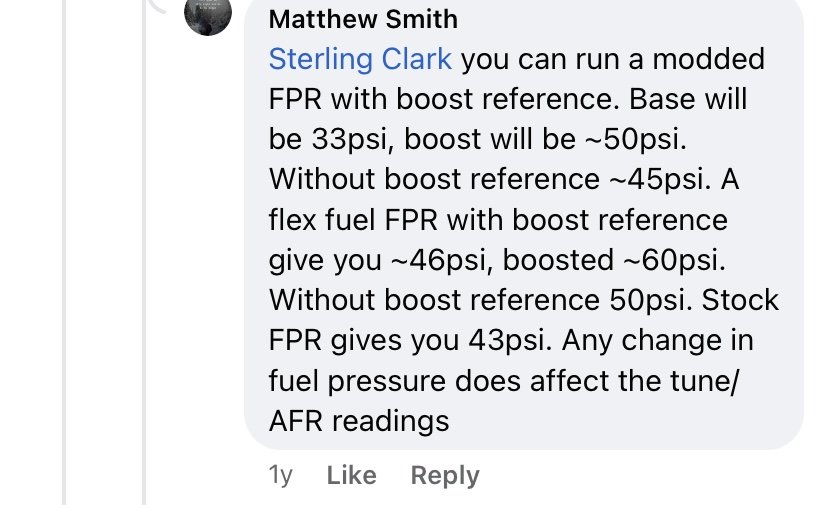

    This is what Matt Smith had quoted the various Pressures as being. He has tried about every fueling setup you can imagine on his many installations so I think he actually has taken these pressure readings himself. I was considering messaging him and see if he has more details.

    Looks like ProSpeed wants the FPR set to 60psi and hooked up to a boost point, under WOT I would be at 71psi.

    I believe the consensus on this is if the injectors were spraying into atmospheric pressure it would be 71psi. Since they’re injecting into the combustion chamber that is pressurized to 11psi, the boost reference basically just offsets that and keeps it around 60psi where it is set at full boost. If not boost referenced it would effectively drop the pressure from 60 to 49 under full boost otherwise.

    Chris Mentrup? I'm pretty sure they guy I spoke to said 60, or implied the ProSpeed suggested 60psi was what they recommended...it's been almost 3 years, so I could very well be mistaken. Use what your tuner recommends :) Stock pressure should be fine with suitable injectors and boost reference, I'm pretty sure the FPR mod was to get more out of equipped injectors without needing to upgrade.

    Another thing to keep in mind, is increasing the fuel pressure reduces the pump flow.

    And yes, the modded FPR was to keep stock injectors with no added tuning.
